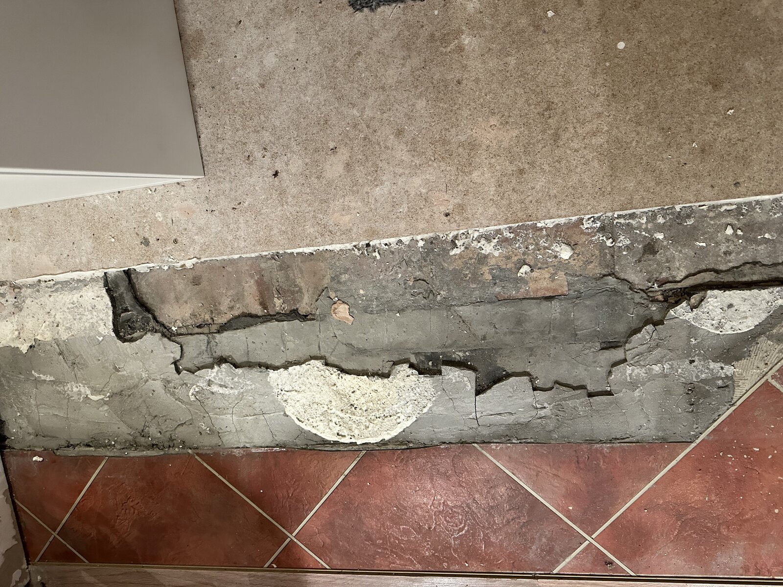

Hey All,
We’ve just moved into a property and they’ve had the conservatory converted into an extension, however, because the floor was lower in the old conservatory they’ve raised this to match the existing floor.

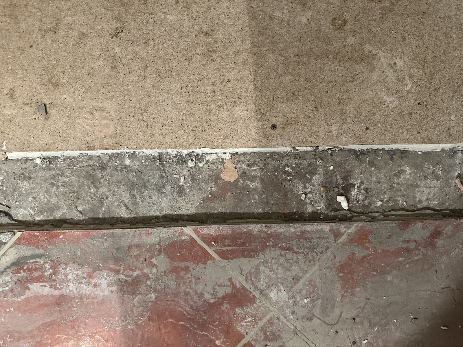

Now, between the kitchen floor and the extension there is a bit of damage to the floor, I need to fill this and level it to allow me to put the new flooring over the top.
What would be best to do here? Self levelling compound? Which one?
Any help would be great.
Scrape all the loose stuff out, then some F-Ball Base repair would be fine to fill.
Depending on what you plan to fit over the top will then define if you need to moisture test and what self levelling specification you go to to get a smooth level through the area
