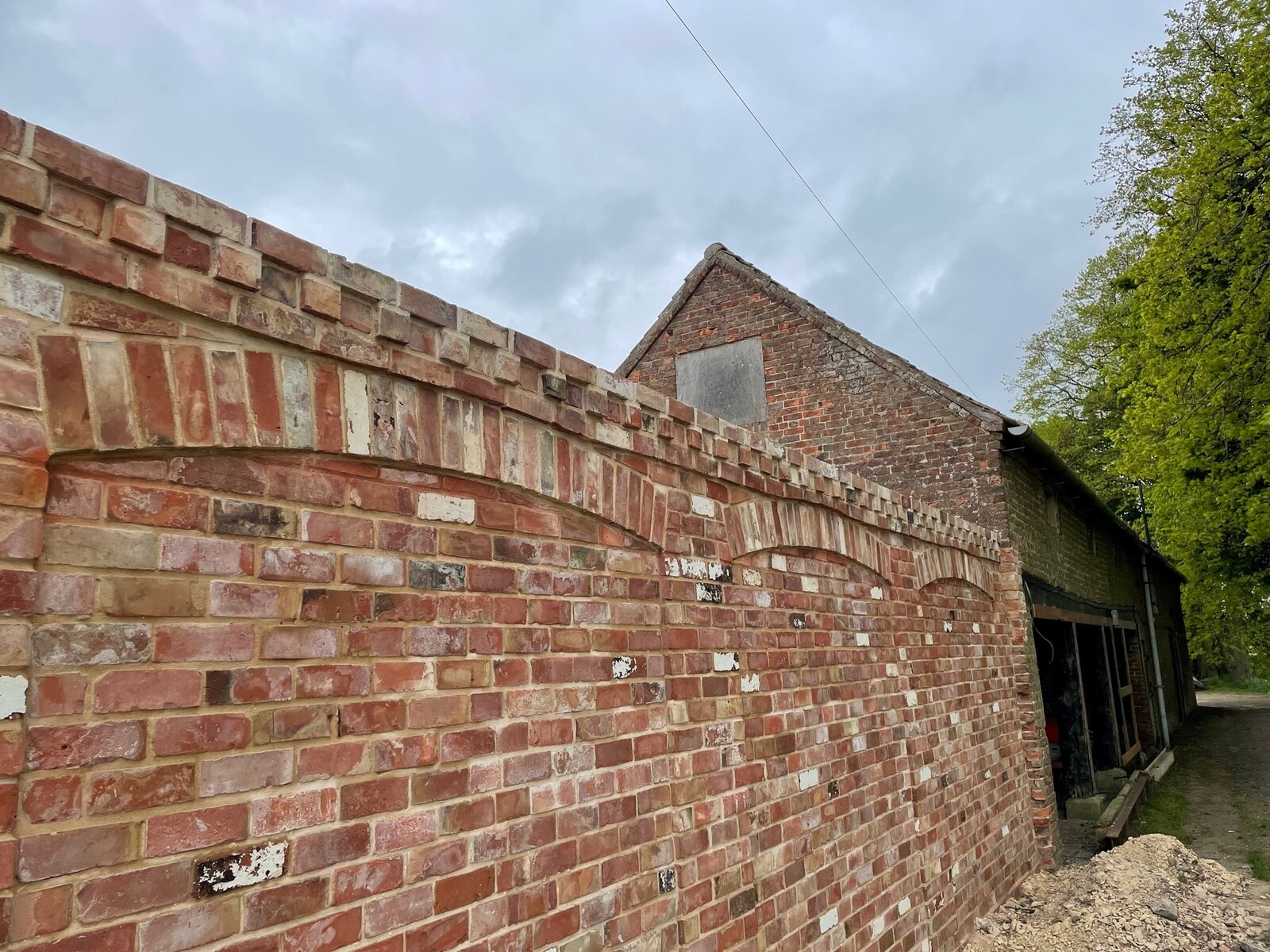

I'm rebuilding an outbuilding and I'm up to wall plate height.
I've built it with cavity wall, block inner skin and brick facing.
The old buildings on my place all have hidden eaves and they're all 9" solid brick walls with dentil course and sailing course at the top. The bottom row of tiles are bedded at an angle onto the outer face bricks and the upper end of the tile hooked over the batten.
On my rebuild surely I need to allow some ventilation and the tiles shouldn't be bedded onto the outer facing brick? or should they?
Does anyone have any details or photos of how to design/build a hidden eaves arrangement?
This is what I have built, it has 100mm cavity and concrete block inner skin. I want to copy the appearance of the adjoining building.
We normally fit an over fascia vent to top brickwork an tiles don't need too be bedded if fixed to battern
If you fit a suitable breathable membrane then you don't need to ventilate the roof

You would think so, wouldn't you. I'm of the opinion that there are no breathable membranes (on their own) that can deal with extremes of cold UK weather coupled with a vapour rich interior. We always mechanically vent because of this.

There are BBA approved membranes that need no venting. Presumably they have been performance tested to get the certification.

I found a few products that sort of fit what I'm looking for I think, this one is my favourite. I will have to chase out some of the mortar in my perps and re-point to fasten it in (assuming the tabs match up with my oddly shaped/sized bricks). I will also need to fit a comb somewhere somehow, probs onto the rafters a bit further up than ideal?? as I'm using Marley Mendips.

This is what an OFV looks like fitted on top of a fascia....
Thanks noseall, I dont have a fascia unfortunately. Having one would fix a lot of my concerns very quickly! and gives me heaps of options for ventilation.
My next concern is getting the right angle on the last tile. My trusses are going to need to be made to just the right size to match up with the width of the building and my choice of eaves vent
If your trusses don't provide you with the correct detail at the eaves, you can always correct thing with some clever use of eaves sprockets, although it is better to get it right with the trusses (if possible).
