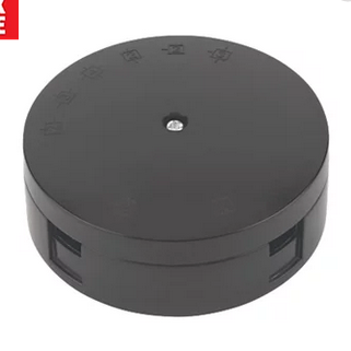

THESE are the junctions in place at the moment whilst the room is being done....are these considered maintainance free?
No these 1717078328766.png are not maintenance free. Deep back boxes can house automation devices, be it a wifi connected switch, socket, or relay, so you can access them if there is a fault.

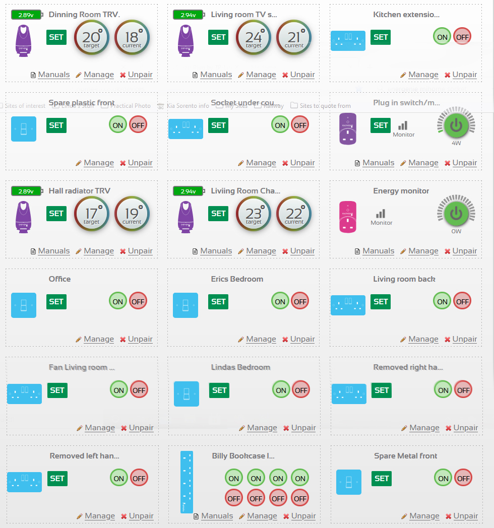

I started with Energenie Mihome, it was a way around the problems of looking after a mother with dementia, and I took them with us to new house, so now some 8 years old, Mihome-used-crop.jpg I did expand on what I had, until they started to fail, of 5 smart light switches down to 2, and the 6 sockets down to 4, the 4 TRV heads down to 3 but that was down to carpet fitters. Moved to TP-link for light switches as they are battery powered so no problem with no neutral, the sockets moved to adaptors 1717078981376.png if it fails, and touch wood non have to date, easy to replace. Only place I would consider using a wifi socket is the outside socket where no room under lid for an adaptor.

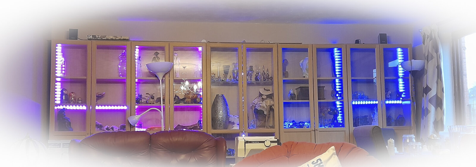

However it can get expensive, the display cabinet lights 20230227_170703_1.jpg were not bought all together, we got the centre one first from Lidi, and tried silly Ikea lights either side, which were not a success. I paid £25 each for lights either side and the centre Lidi ones were not much cheaper. A smart socket adaptor is £10 and it soon mounts up.
Absolutely no need for those or any other hidden junction boxes in a new installation whether they are 'maintenance free' or not.
Its not really the sockets Im trying to hide so much as the cables.
Cables go in the walls.
Sockets of whatever type are located where the equipment that connects to them will be. This could include 230V AC outlets, USB outlets, copper cat5/6/7, coax, fibre and so on.
I am going to have to have some access pannels.
For what? Shouldn't be anything in the walls that requires access.
Stop tap, under plasterboard charging points, gas stop tap....all need access panels.

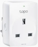

If I want to avoid plugging things into sockets, which will be perminantly in situe, is it acceptable to detach the devices plug, and instead wire it to a 13amp fixed spur, but swapping out the fuse to the one from the plug.
Im thinking for example with electric blinds...I dont really want to cable running down the wall into a plug. But Id also potentially do the same with some of the led lighting.
Cheers
If I want to avoid plugging things into sockets, which will be perminantly in situe, is it acceptable to detach the devices plug, and instead wire it to a 13amp fixed spur, but swapping out the fuse to the one from the plug. .... Im thinking for example with electric blinds...I dont really want to cable running down the wall into a plug. But Id also potentially do the same with some of the led lighting.
Yes, you can do that and, as you imply the fuse you put into the 'fused connection unit' should be of the same rating as the one which was in the plug.
You can do that, but why would you? Removing the plug, and connecting to a FCU, makes fault-finding and repair so much more difficult.
