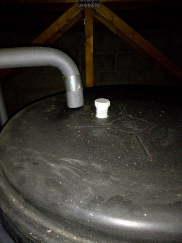

However, I have now investigated further and the big tank is unlike one I've ever seen before. It's round, plastic and has a fitted lid with some kind of vent(?) sticking out of the top. Next to it is a smaller, oblong tank also made of plastic with a fitted lid.
Any clues much appreciated, needless to say.

Do I just remove the lid and it's like an old-fashioned loft tank? What about the vent/thingy on top? is it attached to anything inside?
I assume the " vent thingy" that you refer to is a copper pipe that raises high above the tank ,and drops down into it. If so ,that is the vent pipe ,which is a safety pipe ,In the event of hot water reaching excessive temperature in your cylinder . so yes remove the lid to reveal the inlet valve / ball cock. The vent pipe is open ended ,and drops an inch or two below the lid into the tank.

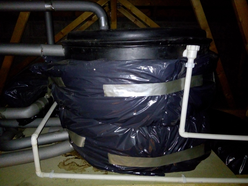

I'm uploading 2 pictures - I hope that's ok. Some forums don't like it...
Not sure how to remove the lid with that pipe sticking down into it. The vent thingy is the white thing on the right. Sorry about my terminology/ignorance.
Perfectly normal. You just lift the lid off. You might find you can lift it a bit and swivel it round, pivoting on that pipe. You may find it easier if you cut the tape or string holding the foam pipe lagging in place and fold it upwards away from the pipe it insulates. Or you may be able to lift the pipe so it comes out of the hole in the lid.
The lid is made of thinnish plastic and is quite flexible.
The white plastic 'thingy' on top of the lid and also the white 'thingy' on the side, connected to the overflow are part of a bylaw kit. These have to be fitted to new tanks and should be retro-fitted to old tanks during overhaul etc, in conjunction with a sealed lid.
It is to prevent animals and insects entering the cistern, in search of water and then drowning and decomposing in your water supply. They also allow the tank to breathe by preventing a vacuum forming with the rise and fall of the water level and also to provide an air gap between water in the tank and the overflow during a fault.
As advised, either unwrap insulation from the expansion pipe and slide the lid up it, or gently lift it out of the rubber grommet that seals it to the tank lid and lift and rotate the lid to give you access. Upon reinstatement, make sure everything is made airtight again.

The photo in #20 shows some liquid staining around the base of the cold water storage tank where the outlet connections are located,is there a water leak there ?
It maybe an historic event but nice to know there are no water leaks before starting work. happy plumbing (y)
