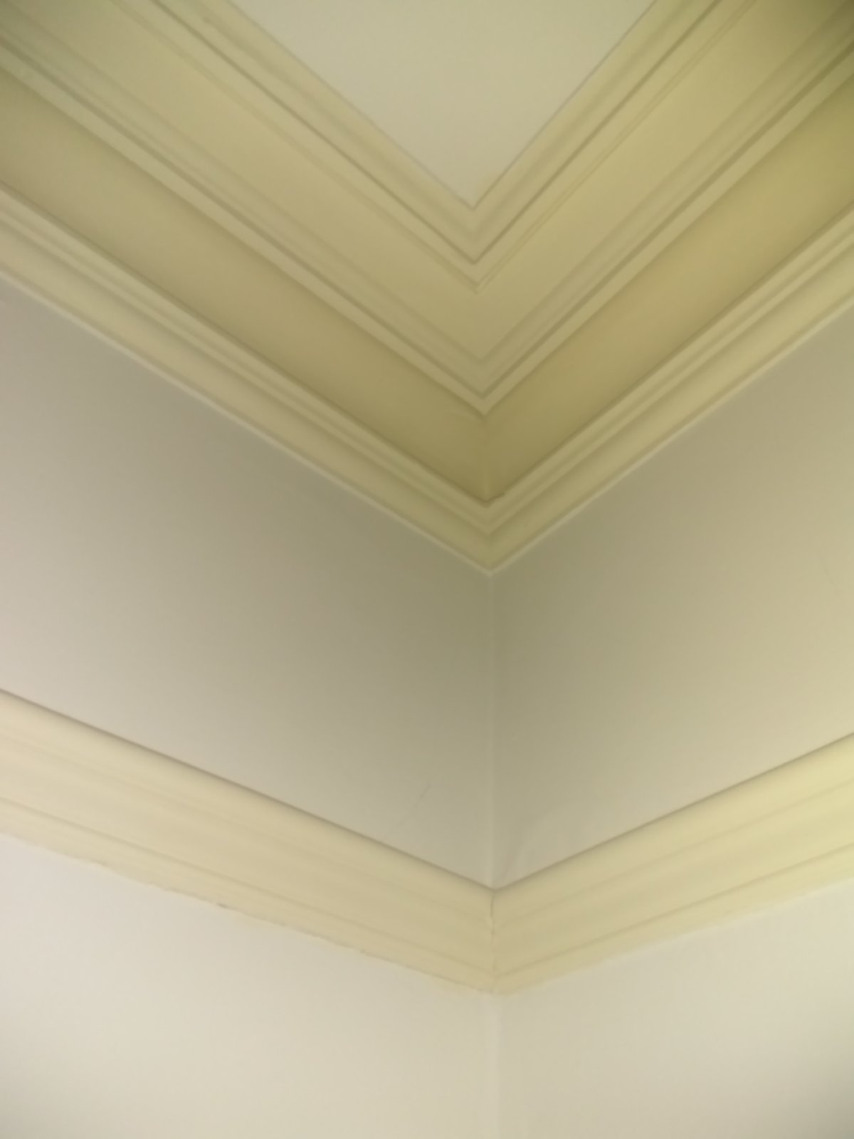

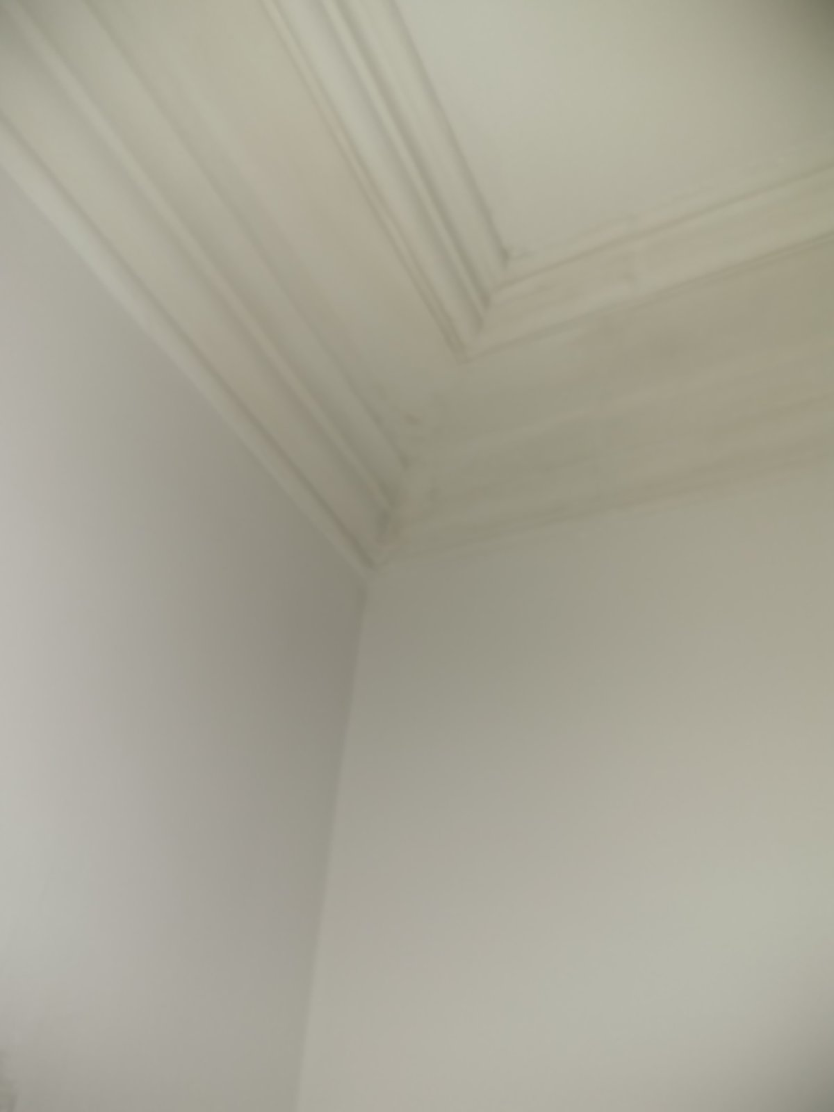

I have a cream coloured coving I've now applied 5 coates of White Matt to and still the cream colour showing through any tips to speed this up see pics of before and after

Did you wash it down with sugar soap or anything else first. have you panted any other surfaces and not had coverage problems?
Smoke or nicotine on surfaces can bleed through if not well washed off first.

Tbh i just fired in with the White haven't really had problems with other house surfaces should i just keep firing on more coates ?
Hit it with a stain blocker. Loads out there my favourite is Zinsser bullseye 123 or zinsser BIN, but have a look in your local DIY store plenty to choose from. Do two coats then hit it with your topcoat.
If it is nicotine it may bleed through the first coat but will be locked in and the second will block it.(y)
123 is water based easy clean up, BIN is solvent based, brushes need cleaning in methylated spirit, slightly harder to apply but better for things like resin and knots.
