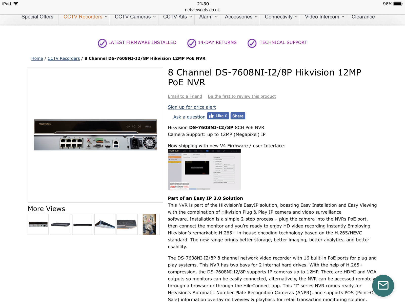

Hi,
Anyone own one of these and does it 100% support H.265+ compression?
The shop I'm buying from said it doesn't, but I'm sure I read some where that it does.
I downloaded the data sheet from the website I'm buying from and it backed up what the seller said that it doesn't support H.265+, but I've just received an email from Hikvision them selves with a data sheet attached that says it does.
Can some anyone confirm if it does support H.265+ or not?
This is all getting very confusing and frustrating that I get 2 different answers.
Did you stress the + ? The spec sheet I found says - Support H.265/H.264/MPEG4 video formats
Which says to me it doesn’t support h.265+
918191B5-AB3B-4B12-8899-D50AF8F8A103.png Firmware depending ...looks like the new version does
Yes.
I have a DS7608NI-12/8P with firmware v4.1.10
It is recording two cameras at H265+. The other cameras are a little older and are only capable of H264 and H264+
