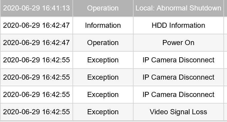

I had a power cut a week ago and the system never came back after this. It reported "Video Loss". I rebooted the NVR and this resolved the issue. A couple of days later, I had a further "Video Loss". A reboot fixed the issue again.
Today (5 days later) I have further reports of "Video Loss". Here's what I see in the log for when this occurred:
Can someone please suggest what may be happening and how this can be addressed.
Thanks in advance.

So your asking what is causing an abnormal shutdown and then cameras disconnecting and losing the image?
NVR model?
Firmware?
How long as it been in?
what was happening at 16:00 ish?

Yes please. Each time this happens my cameras stop recording and that's a concern. I've had this system for over 4 years and have never had this issue.
NVR model?
DS-7608NI-E2 / 8P/A
Firmware?
V3.4.98 build 171121
Just over 4 years
There are repeated "System Running State" messages for most of the afternoon.
I can see one instance of "Hik-Connect Offline Exception" at 11.55am but it then returns to "System Running State" after this entry.

Abnormal shutdown , could be due to cable damage, camera failure or NVR failure.
shame NVR is out of warranty, if it was in warranty you could get it swapped out an eliminate that very quickly as the cause.
The problem is testing to eliminate, and at 5 days between problems it could take a long time to get down to the bottom of it.
This has hardly ever happened over the last 4 weeks and I've then had a spate of these over the last week
The cameras have always disconnected in this order: 4, 5, 6 and 7.

The cameras have disconnected at the same time on each occasion. Even the seconds are the same on each disconnection entry for the cameras.
2 of these four cameras are indoors. I have checked the ones outdoors and the cables are well insulated by the connector shield "thingies" and I've also wrapped insulation tape over them. there is no sign of water or damage.

I’m wondering if it could be a bad disk? Would a reformat or reset of the system help?
The NVR should have a disk check you can run
however with no HDD the live view would still be available?
It sounds like the NVR is re-booting, it's possible that a surge may have damaged the PSU or some other component inside it. You will always get camera disconnect errors when the machine reboots, this is normal so there's probably nothing wrong with the cameras themselves.
Does this suggest that I need to replace the NVR or can I replace an individual component within this?
