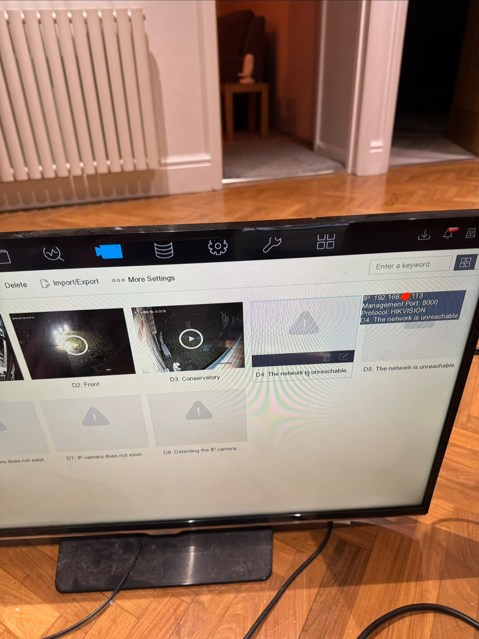

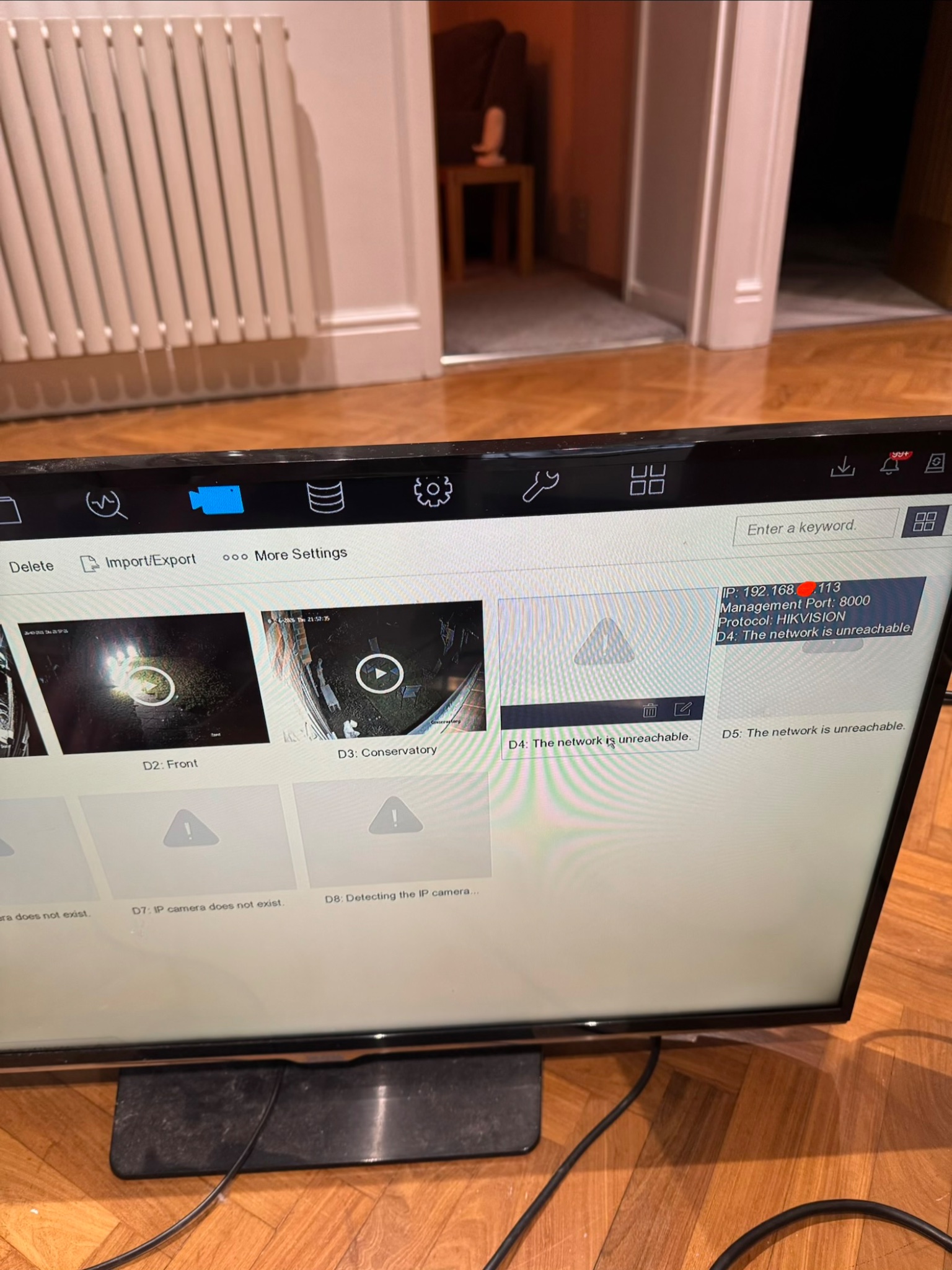

Ive tried again. Did the ipconfig thing.
LAN - ***.***.**.111
Nvr is the same but with 112 at the end.
So put the same with 113 at the end. Subnet and gateway the same.
Double clicking the IP address on sadp doesn’t take me to the hik vision site, but does when clicking the nvr ip address.
On the nvr itself, changed ‘ Poe setting’ ‘Poe binding configuration d4 to not emabled.
And on the ip camera page, changed d4 to the same ip numbers as above (113).
But still getting the same error.
Because the IP address didn’t take me through to the hik vision site, I haven’t put a password on the camera. Could this be the problem?

Also when looking at the nvr details. Enhance SDK service port, ipv6 address, ipv6 gateway, ipv6 prefix length are filled in. Should I be putting any of these into the doorbell ip details ?
No.
Using SADP put in their address you want, the gateway being used which you should now have.
Use the doorbells password and the io address should change.
If your still struggle give us a bell tonight after 8pm and take a quick look remotely for you.
I
When you say doorbell password, I never set a password for it, I take it if you double click on the IP address it should then it takes you to the hik vision Site where I set a password but I’ve never got that far.
So you have set the door bell at ending at 113 ?
from web browser enter ip address ending 113 it should bring up a web page for the door bell
