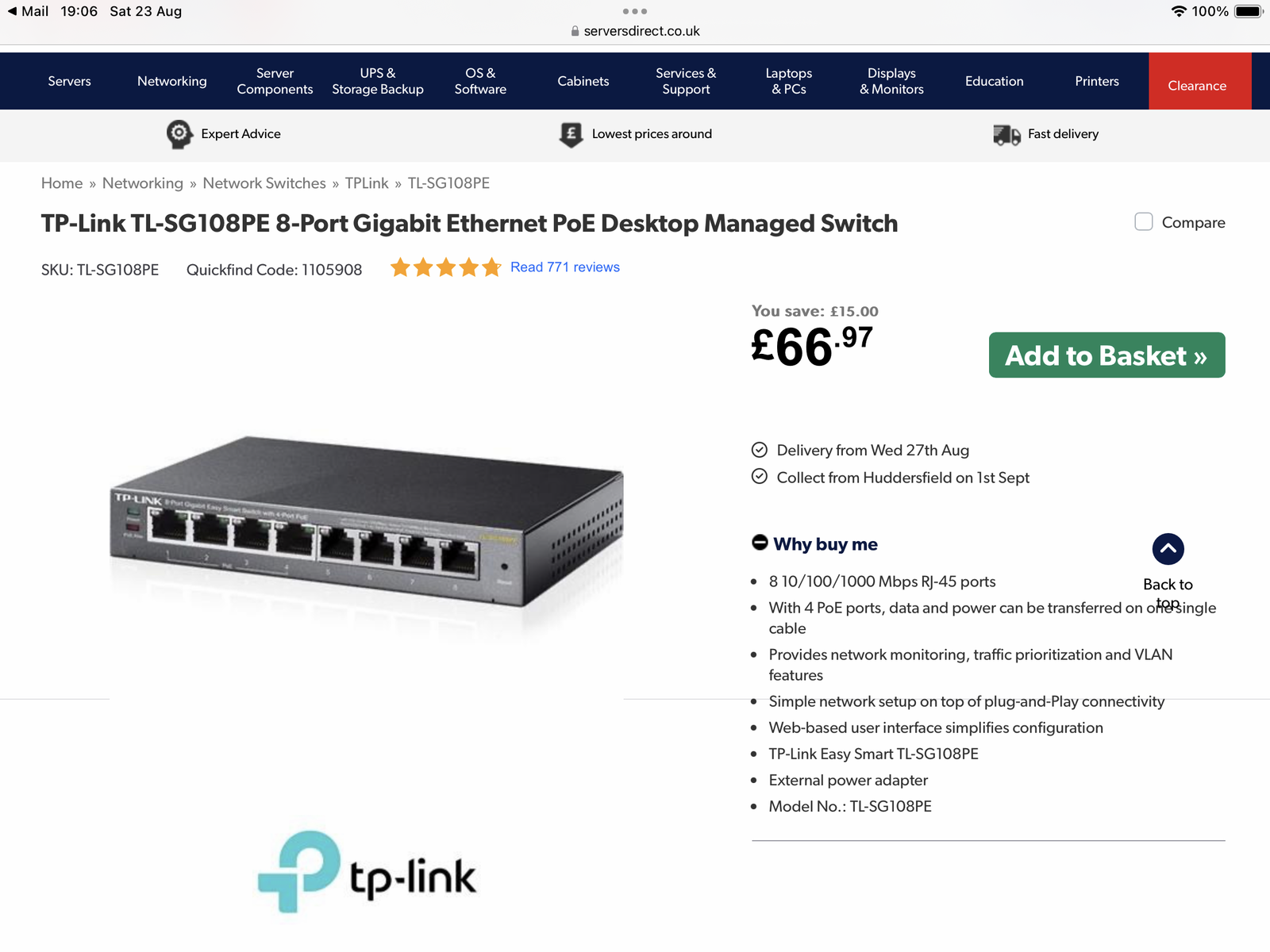

Hi, I'm having a problem installing the Hikvision Doorbell Camera DS KIS 603-P.
I have run cat 5 outside to the Bell & to the monitor.
Made it off with RJ 45's, carried out out a cable test which was fine.
Plugged in the Hikvision bell & Monitor & then into my TP Link 8 way switch which is already running 4 other bits of kit, so I know that the switch is working fine.
After plugging everything in I get nothing, no auto start up on any of the Hikvision kit, it's new out the box ?
I'm just downloading the Hikvision SADP tool to see if that would help.
Any help & advice would be most welcome.
That’s not a POE switch ….as per photo …it would have PE in the part number not just E
As above, it's not a PoE switch which means it can't supply power to PoE devices. You either need to buy a PoE switch, or you can use a PoE injector to supply power to the doorbell, or the doorbell might come with its own PSU which you need to connect. I think it's the latter in this case.
