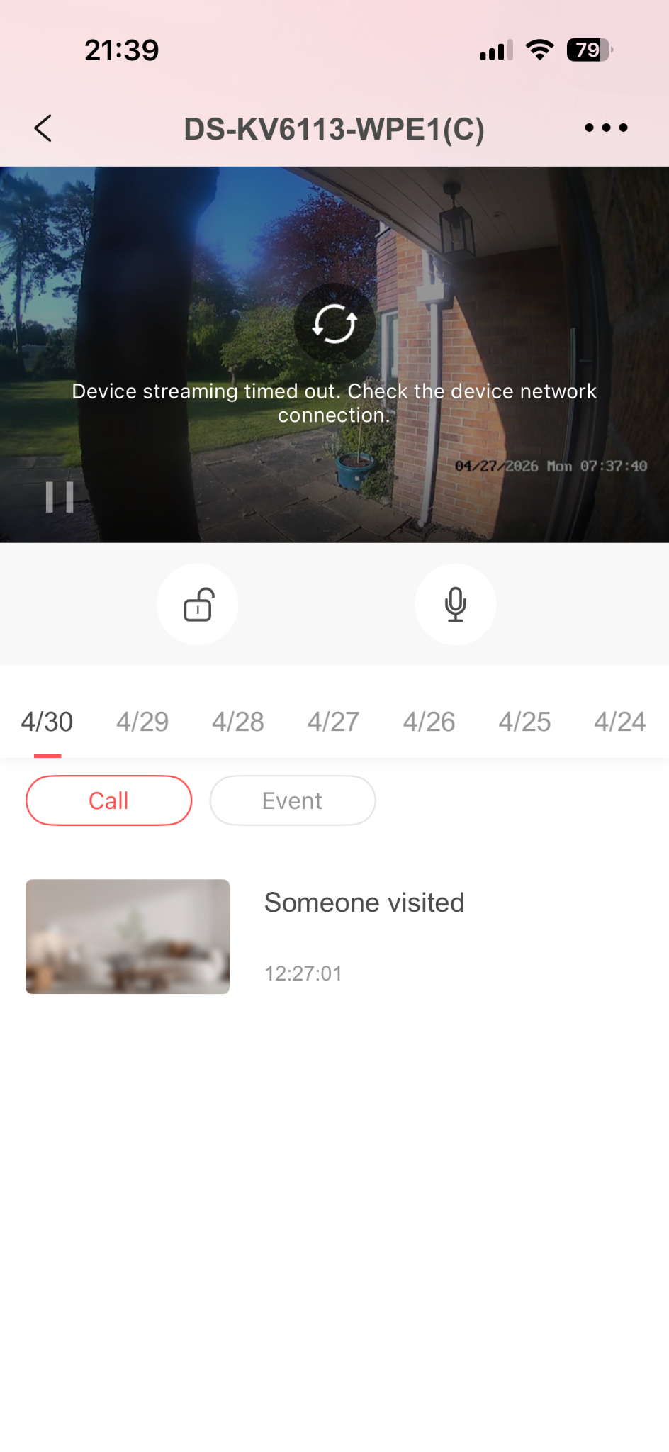

Have you actually set the ip address on the camera or are you just putting it in the nvr... does it show up in SADP ?
It could also be that something else on the network is already using the 113 address. By the way it is of no use to redact your LAN ip addresses as this is only accessible within your network.
I’ve got an iDS-7204HUHI-M1/FA/A DVR with 4 cameras connected, I’ve connected a DS-KV6113-WPE1(C) doorbell, connected to the DVR via a POE Switch which works perfectly.
I’ve not got a NVR but seem to recall reading that it needs to be connected via a POE switch rather than plugged directly into the NVR, I could be mistaken but I’m sure someone on here with far more knowledge will come along and say yes or no.

Fingers crossed, the Ethernet cable, as well as communicating between the NVR and Doorbell it will supply the power to the DS-KV6113.
I altered the firmware (model (C) only) in the I/O settings to output 1 to “mechanical chime” in the latest firmware version it’s “Doorbell” then connected the N / 0 and Common wires to a Byron 776 chime.
So as well as notifying via Hik-connect app the chime rings

A little update. Now managed to get the door station working through all the help from this forum. You are correct and this door station does have to be plugged into a Poe switch and not into the back of the NVR. I’m not entirely happy with the door station and wish I just put a camera there instead. Sometimes I cannot get signal to view the image on the hik app although all the other cameras work fine. I’m gonna try to remake the connections both ends and see if that helps.
Thanks again for the help from everyone.
