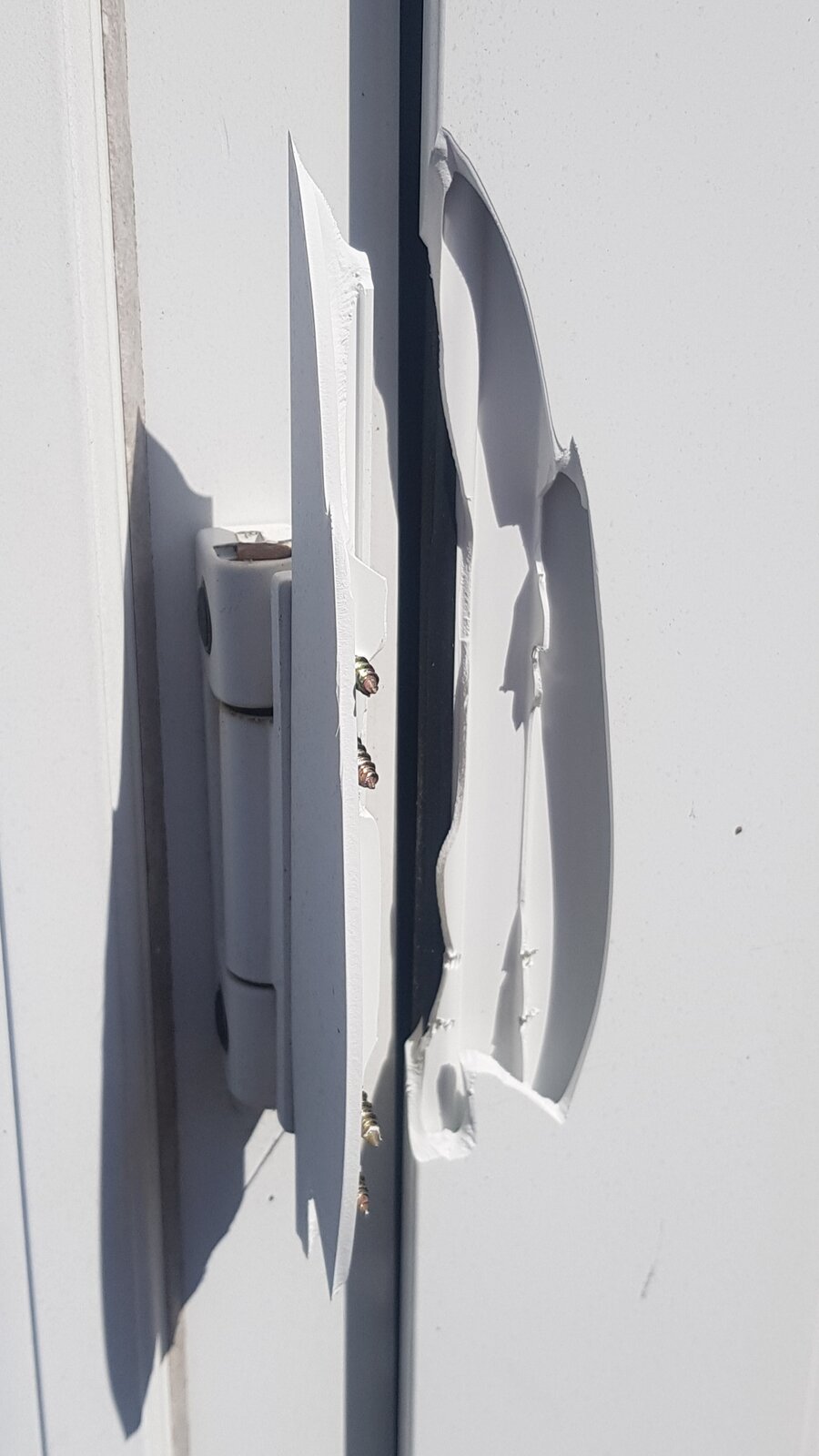

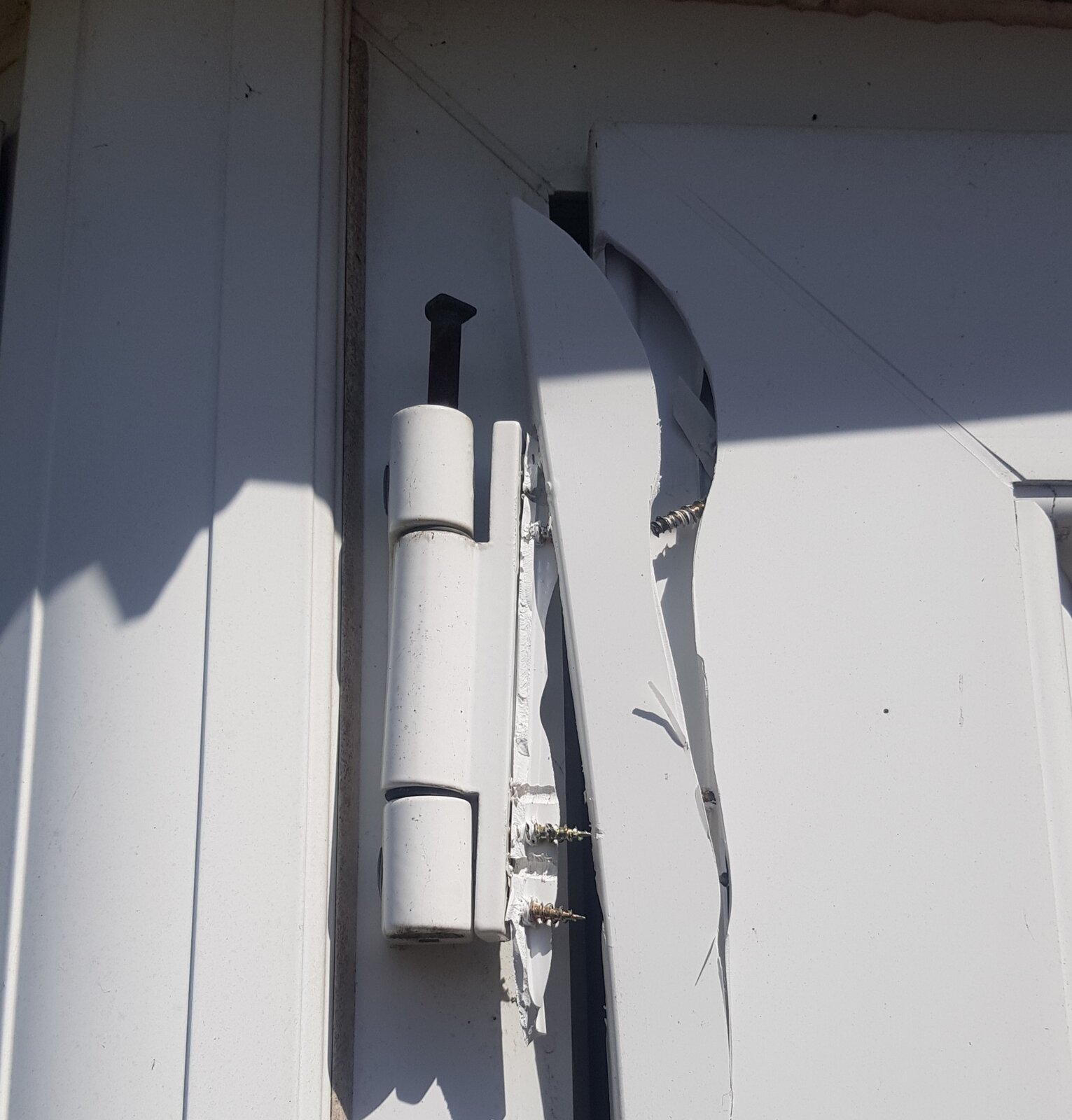

Hi all,
One of our conservatory doors got caught by a gust of wind yesterday which seems to have generated enough force to rip the middle hinge out of the door and the top hinge most of the way out. See photographs! The bottom hinge also has some damage: a bit of cracking but nothing as extensive as the other two.
Can I have some thoughts about the following?
Forgive the basic questions: I’ve never worked with UPVC before. I’m not even sure if this damage might be repairable.
a) I presume the first thing to do is to use some sort of adhesive to glue the parts back together. I’ve seen quite a few different products suggested online. Many seem to suggest using a Super Glue (cyanoacrylate). Is that the thing to try?
b) The breaks are moderately clean to me but if there is any material missing, is there a filler that anyone would recommend for this sort of job?
c) Should I try moving the hinges up or down so that they are in fresh material or is glued UPVC likely to be strong enough on its own? The problem with damage to all three hinges is that there is going to have to be a lot of moving to find fresh material for all of them. I did wonder if I should try to reinforce but I can’t see much suggestion of this online.
I fully accept that getting a really good finish on a UPVC requires a lot of skill which I do not have but I am not too bothered about that since we are thinking of replacing the conservatory with a proper extension within the next few years: it’s a bit dilapidated. Also, I am not too worried about security since we usually keep the door to the house locked & leave the conservatory unlocked.
Any other thoughts or repair suggestions gratefully received!
Thanks!
Jacob

Doesn’t look repairable to me. Can you claim on your house insurance?
Possibly, although we have a massive excess so I’d probably try to find something to patch it together until we sort out getting the conservatory replaced which is our current plan.
Yes repairable, especially if you are planning to replace soon. Would be advised to add a section of metal into the profile to reinforce the area.
If you don't care for looks then a compatible epoxy will work rather than the more specialist 2 part hard plastics putty.

That product looks more like cosmetic filler rather than a glue capable of structural repairs
Anything is repairable but it all depends on how good you want it to look and how long you want it to last!
In my opinion any repair on that door is not going to last, all the weight is on that top hinge and it will just keep pulling off. If you add anything to the edge of the frame , such as a metal strip, it will push the sash further over, possibly causing issues with weather tightness. I don't see how you are going to get metal reinforcing inside the door sash, without more damage but I suppose if you can fix a metal piece inside the sash and keep it there to fix hinge to , then it may work but as I said earlier I can't see it lasting . Depends how long you want it to last

Did not see top hinge damage - might not be a goer as Ronnie said.
In terms of the PVC damage yeah thats repairable, but I would also ditch those butt hinges and replace them with flag hinges to shift the point loading onto the face not the edge, I would also slide in some flat steel or aluminium into the chamber to reinforce it and for something substantial for the hinge screws to bite into not just the PVC

I had a go at a repair last night.
The middle hinge, which had pulled free from the door seemed to glue on quite well: there was a huge surface area and essentially no material loss. I used high viscosity superglue. It sees pretty solid but I guess only time will tell how effective it is.
Somewhat to my surprise, the top hinge proved to be irreparable: the damage to the edge under the hinge was really quite extensive and quickly disintegrated. I therefore repositioned it into new material below.
Unfortunately, I also noticed some hairline cracking around the bottom hinge too.
I’m going to give it a week and see how much movement there is and take a view as to whether to swap the hinges for flag ones as crank39 suggests.
