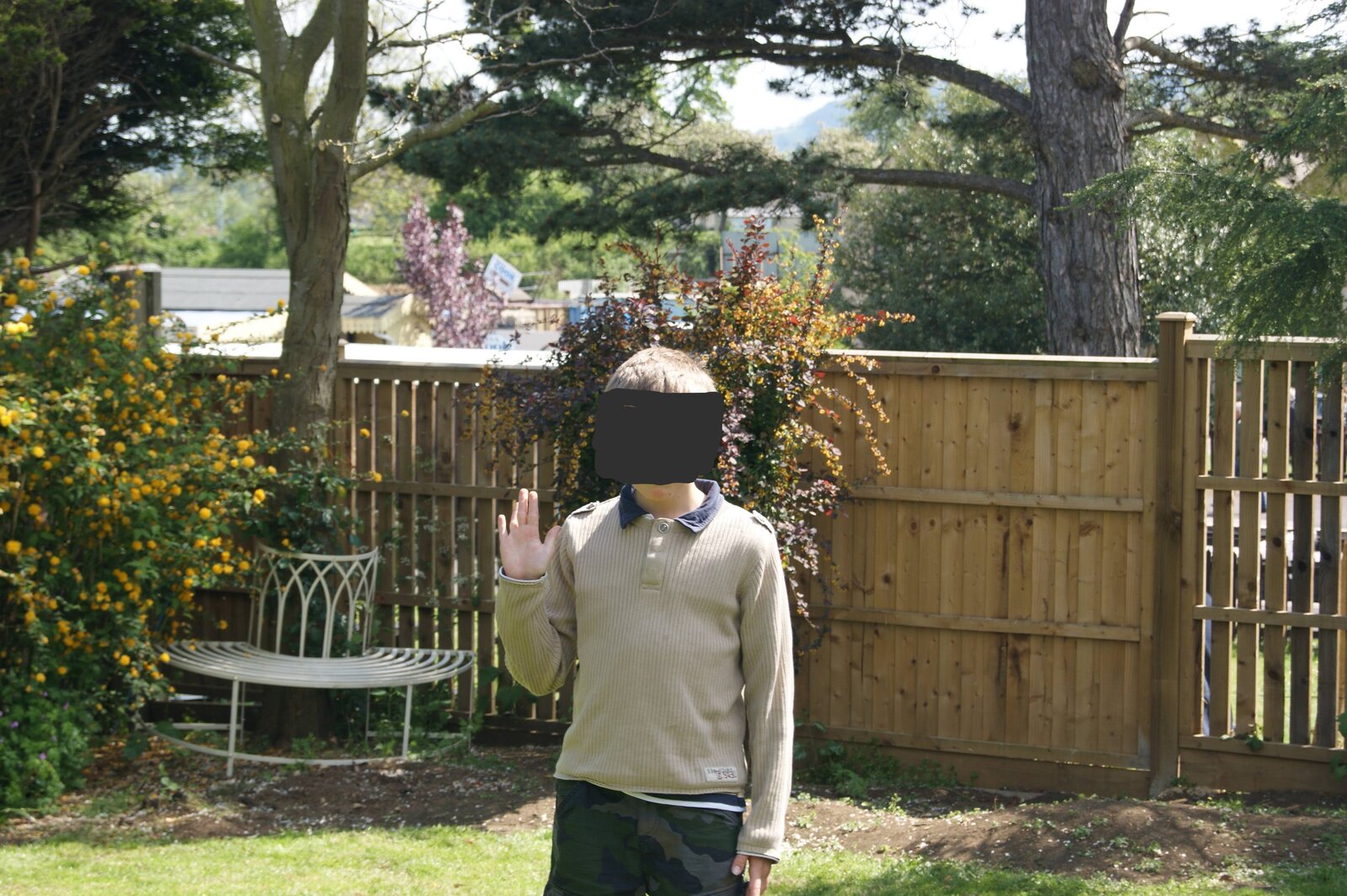

We had / have similar. In the end we replaced the whole fence of 14 panels with alternate solid, close-boarded and custom-made palisade panels, to allow the wind to pass through. It also provides a barrier but some visibility to the other side.
The vertical slats (pales) are 3" wide with 1" gaps. Panels are 6' wide and 5' high, framed and capped to be similar to the solid ones.
