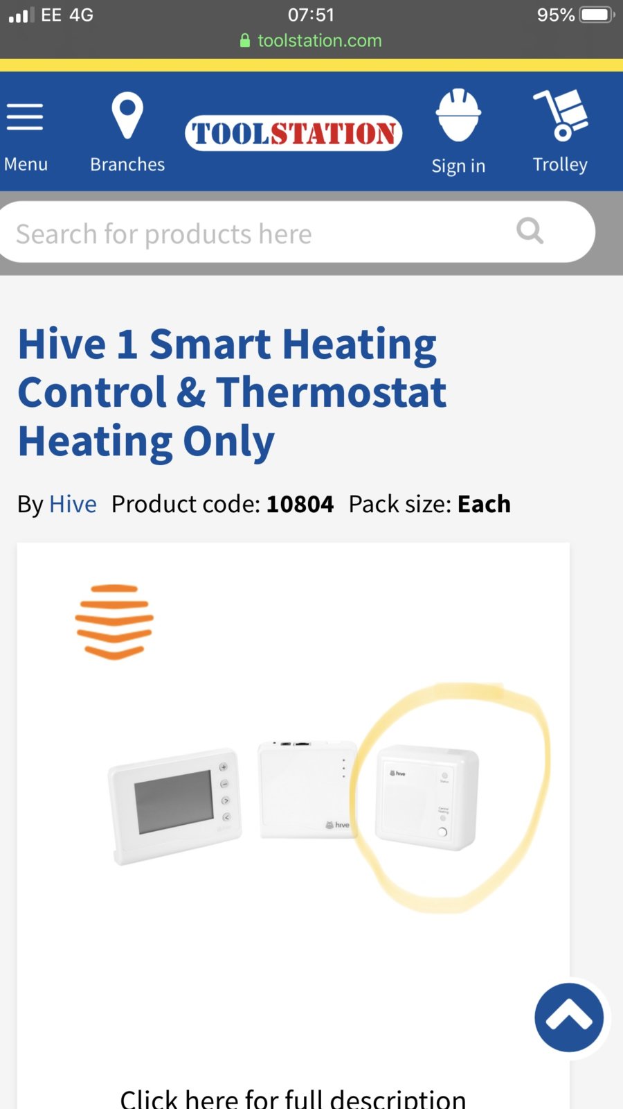

I had one of these and over the years, am now left with the circled piece. This is connected to my combi boiler and I can switch the heating on from the button on this. This is a time limited override and doesn’t allow me to control the temperature.
Q. Can I purchase a hive 1 room thermostat from eBay and pair up with the existing device? I assume the remaining piece is only required for remote access?
thanks in advance.
Hi, yes you can pair the control unit to another thermostat. Please be aware that if you went for a second hand hub once it has been registered it cannot not be re-registered to another user. There are lots for sale on eBay but won’t be any use if wanting the phone app.
You should be okay with just a thermostat and your existing control unit.
