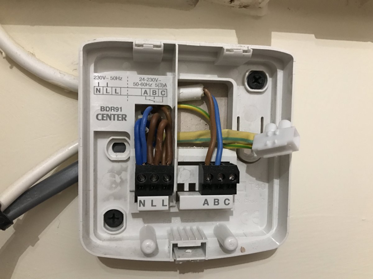

Currently the CENTER thermostat is:

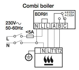

The hive 2 should be:

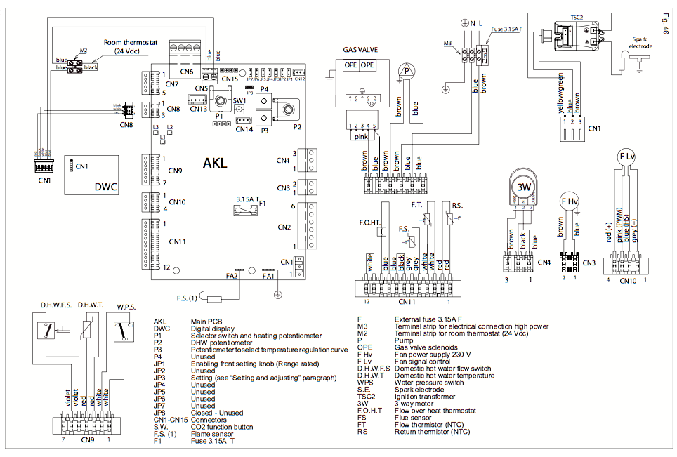

How can I connect T1 and T2 from the boiler?
Thanks for the help in advance.
I enclosed the DIAGRAM of the boiler.

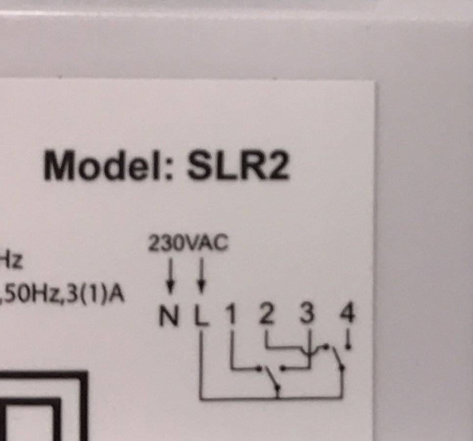

The SLR2 is a dual channel mains voltage unit and is not suitable - you need the single channel SLR1.
