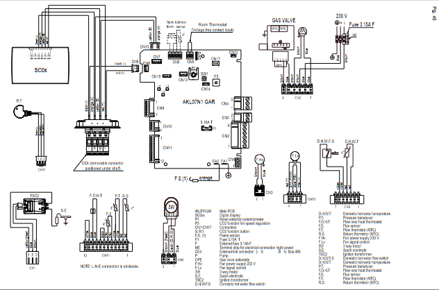

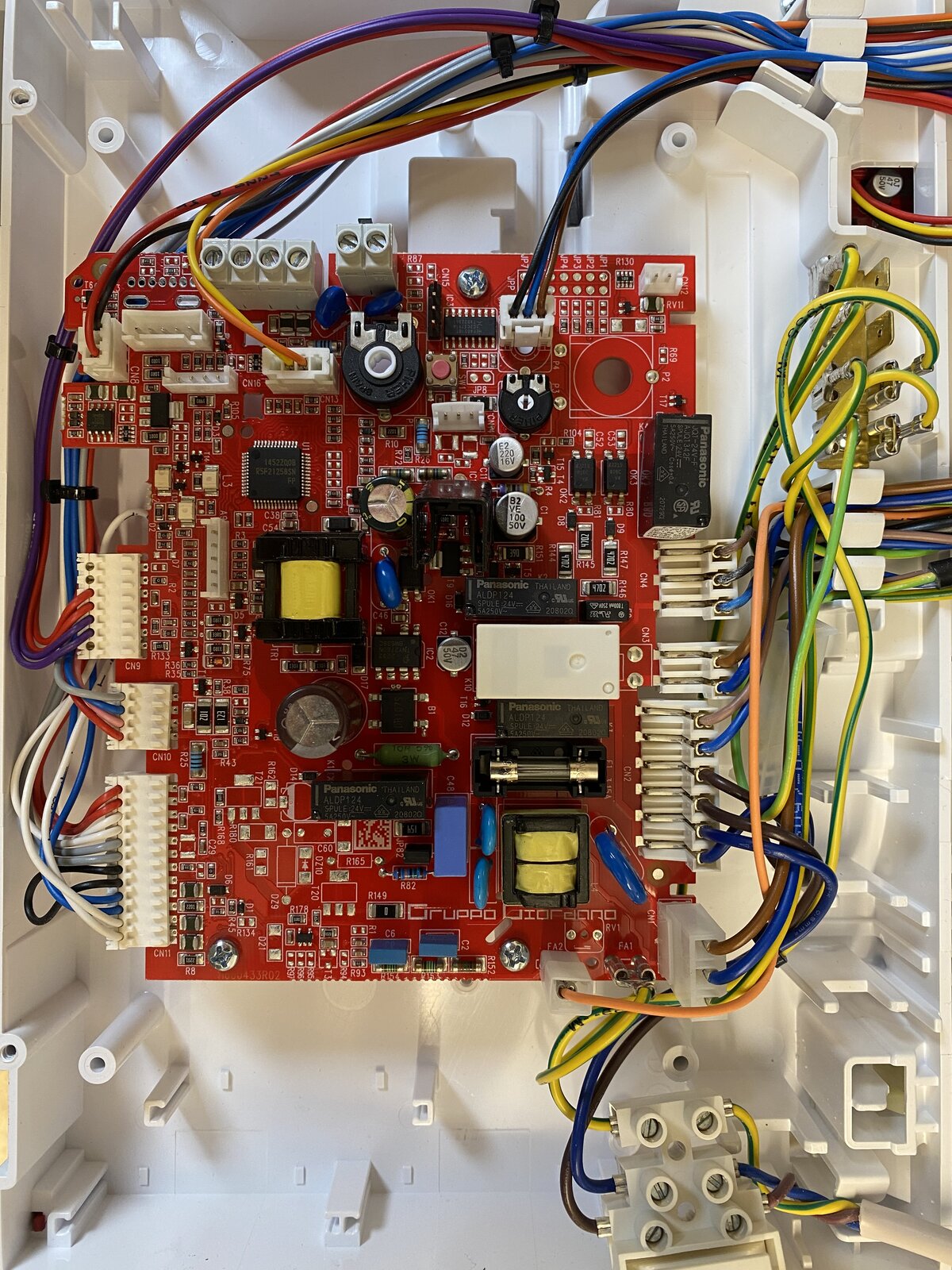

I’d like to install a hive i have purchased connecting to my boiler. I have a hive mini and vokera vision plus 40c.
I can pick up the live and neutral but don’t know where to connect the hive to the boiler (see picture)
Any help would be appreciated. Thanks

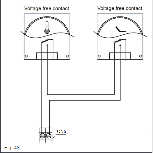

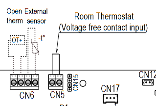

There is a diagram 1711061559820.png there is a good diagram 1711061727133.png which does show what is what. 1711061910638.png however the instructions are rather involved.

The small black tab in the picture, is the edge of the bridge, linking the terminal blocks.
No changes to the configuration are necessary.

The Vokera is ELV switching - hence...
it’s volt free so no mains links!
and
...yes, CN5 to terminals 1 and 3 of the (Single Channel) Hive mini receiver.
