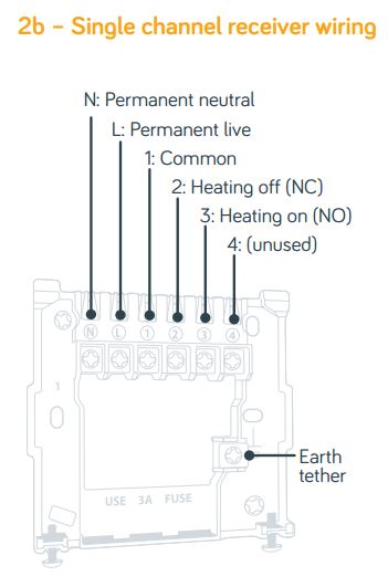

Hi, would like a bit of advise. I have just had a Vaillant 832 plus combi boiler installed. On my previous boiler I had Hive system installed. Now i basically want to get this installed on the Vaillant. Can anyone help get wired up. I have done a bit of research on this but want to confirm my findings.
From the hive Receiver I have the following :
Im not too sure where it needs to be wired.
According to the manual. This will be wired in X100 (burner off) but since this is 230v I need to wire the live and neutral to X1 ? is that correct ? But does that get wired to RT in X1, or do i wire it with the mains ?
Any help would be appreciated here.
Tas

well, that was my fault. I didn't want it installed. Was going to get something else. Then figured that it will be easy to install myself, and here we are.
I had a sparky friend come over and help, instructions below for the single channel hive receiver
The L/N/E from the fused spur will already be wired in at the X1 terminal to power the boiler
wiring instructions for the hive receiver to the boiler
I used a 5 core cable bought from Screwfix
– Hive Receiver to Boiler at X1
L to L (brown)
N to N (blue)
1 to L (black)
3 to RT 230v (grey)
E thether to E (green/yellow)
Took a while to get 3 wires in to the Live connection at x1, so take your time on it.
Important**
Remove the looped wire at the RT 24V (x100)

then just follow the steps to connect the thermostat and internet controls
