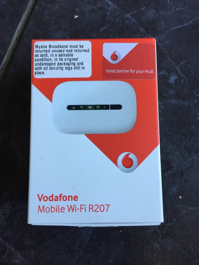

I'll get a portable router and use my phone as a hotspot and see if that works

I have a 4g portable router for this purpose - it works fine. I don't use the phone as a hotspot though as this conflicts with setup.
I use this...
Tried plugging into the neighbours but no success, not sure if distance too far or an issue, so ended up removing wiring and taking home. Wired sender with 3core flex, plugged in hub and managed to get it working after messing about with it for a while. The red & yellow lights kept flashing alternatively.
