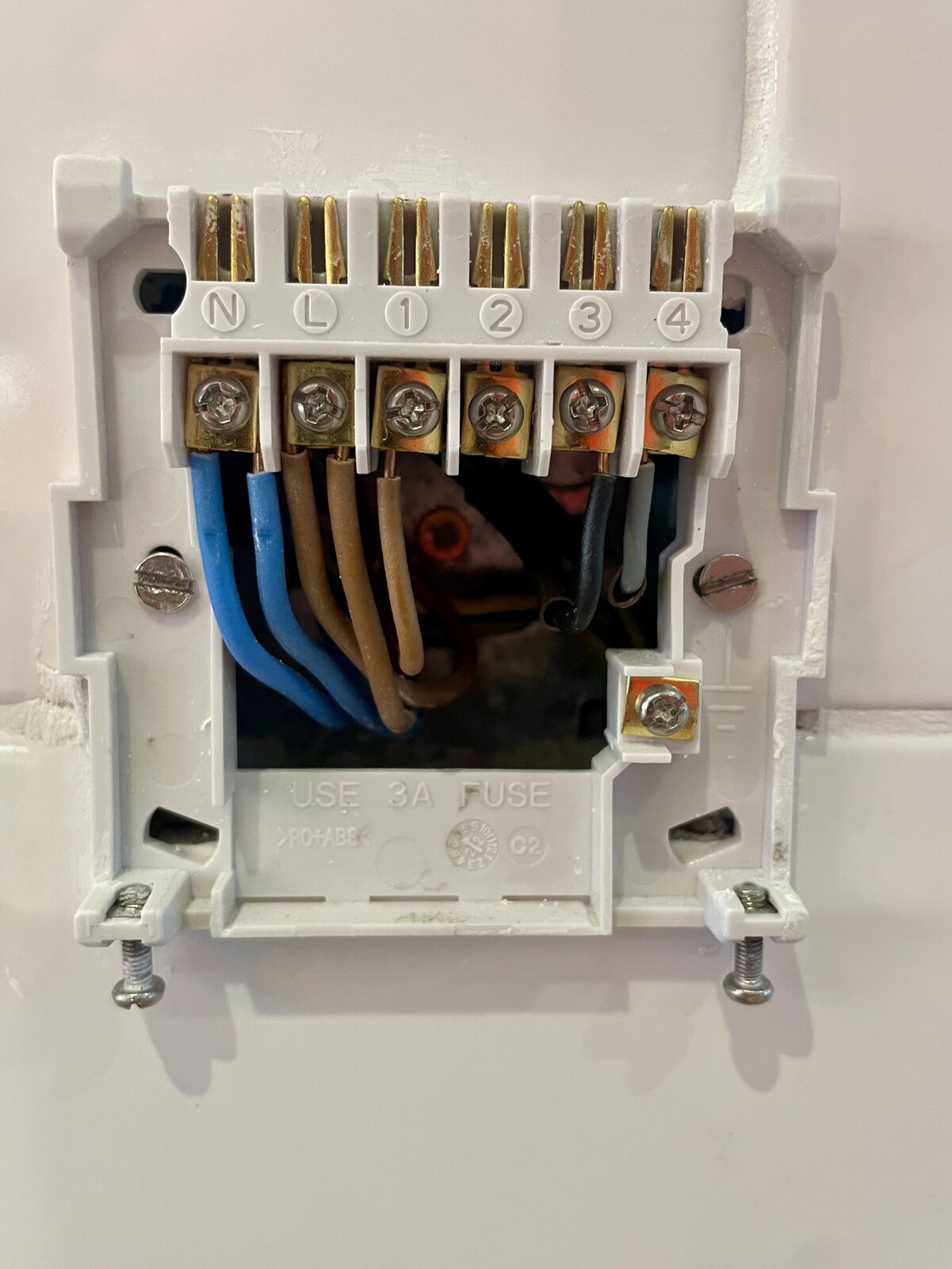

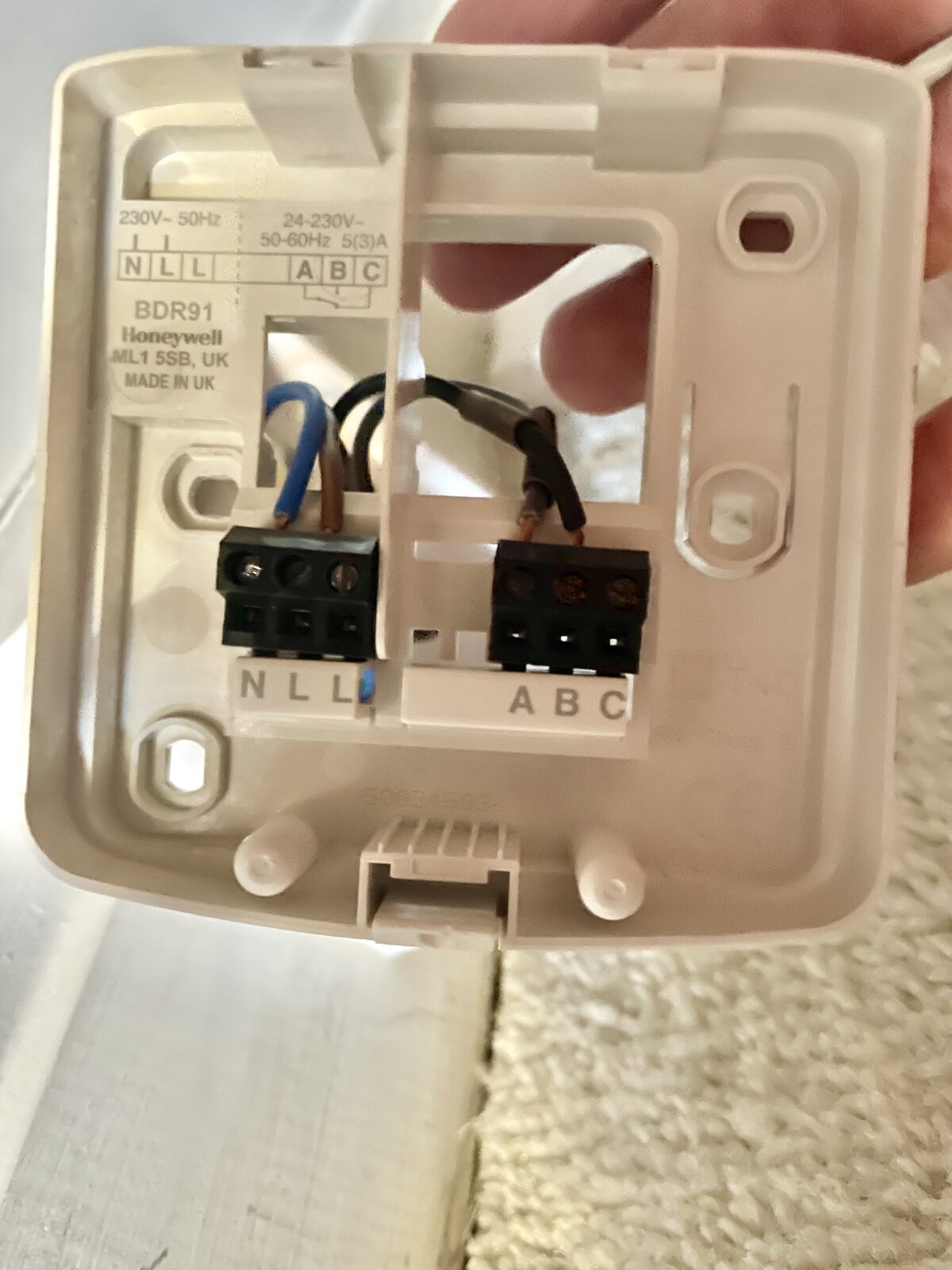

Thanks for jumping on this. Hive and BDR91 wiring photos attached. Any advice appreciated.
Thanks for jumping on this. Hive and BDR91 wiring photos attached. Any advice appreciated. View attachment 356218
Thanks for the photos, nothing looks obviously out of place - although you still appear to have the BDR91 in place?
That should have been a simple job for the electrician to decommission and remove.
However, it shouldn't cause an issue with the hot water.
My first troubleshooting step, would be to check that the hot water doesn't turn off, if you set the hot water to on by the Hive - ensuring the electrician hasn't simply transposed the wires.
Secondly, to rule out the Hive as an issue.
With the power off, I would move the brown wire in terminal one, to the L terminal of the backplate.
With the Hive receiver still removed, I would turn the power back on (carefully avoiding the backplate and the live terminals); if the hot water remains on, then it is more likely to be a valve head or wiring problem.

REALLY appreciate you walking me through steps to troubleshoot the problem. Turned water permanently on via Hive and water still piping hot. Turned everything off to let water cool down. Swapped T1 wire to L terminal and turned back on (without connecting the receiver front) and boiler immediately fired up. Guess this means we can take the Hive out of the equation?
Given that everything was working fine for 6 year with the Honeywell controller can we assume that the wiring is fine and that it’s most likely the Honeywell 3 port valve motor head? If so, would you suggest replacing this to see?
Again, really appreciate your help. I feel like we’re narrowing down the issue.

I'm still intrigued by the BDR91, did the electrician delve into the wiring centre to link it out?

Hi @RandomGrinch - in terms of the BDR91, the electrician didn’t know it was there (my fault as I didn’t know it was wired in). Our plumber linked it out. I assume he’s done this correctly. He’s happy to come back to look at it again now we know it wasn’t the Honeywell Powerhead. Are the questions I should ask to check all is correct?

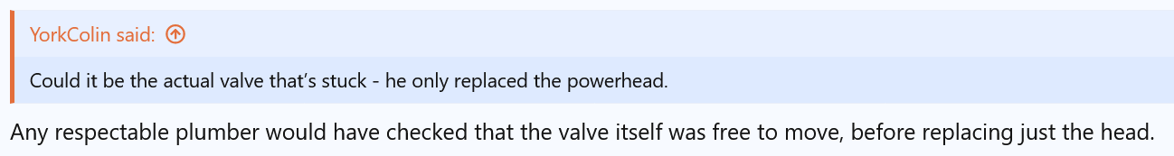

Could it be the actual valve that’s stuck - he only replaced the powerhead.

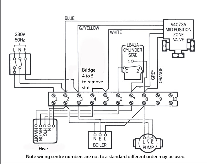

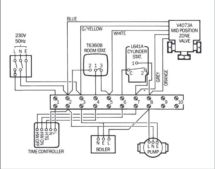

Note three wires into the programmer or hive, also three wires to cylinder stat, there is a hot water off wire used, this makes the three port valve travel all the way across when CH but not DHW is required. However when CH not in use, the three port valve is not used at all by the electrics, it default state is hot water, so it has nothing to do with switching boiler on to get DHW.
I would remove the Hive unit and see if you have no domestic hot water, clearly leaves open contacts which will be live, so tape a plastic bag over it for test, if boiler does not fire, then clearly down to Hive, if does fire then nothing to do with Hive.
Hive can be configured for C Plan, you are on Y Plan with three port valve. Not sure if it can be configured for any other plans, but clearly must be set to correct plan.
If your plumber has done that correctly then we could also rule the BDR91 out, and it suggests the electrician hasn't gone anywhere near the wiring centre?
Any respectable plumber would have checked that the valve itself was free to move, before replacing just the head.

But the DHW is not switched by the three port valve, so valve being stuck would not cause the boiler to fire up, only the tank thermostat which is it seems OK and the Hive unit, should have any bearing on if boiler fires up. See diagram.
So either a wiring fault, or faulty Hive, so if it does not fire up with Hive removed, fault has to be with Hive.
If fault is Hive, next is it programmed for that system, but first is it Hive at fault, and easy to simply remove Hive to test.
