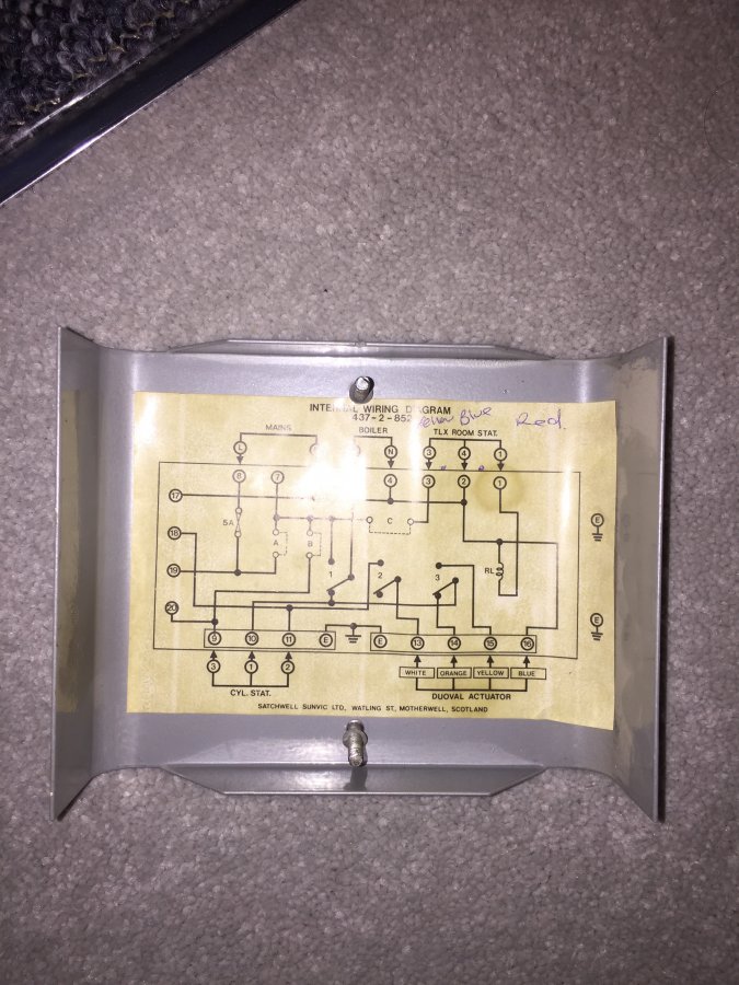

Your diagram shows two links marked W one for hot water the other for central heating which since from the hot water then you can't have central heating without hot water. However looking at the wiring diagram it seems the hot water connection is only a connection into the existing timer there seems to be no connection to the boiler other than through the existing timer. So here I am guessing that some where there is some motorised valve and the connection "HW" is not a input but an output to some exterior motorised valve. The picture
seems to confirm that, so in central heating systems I have worked on before the thermostat controls the valve and the valve controls the central heating. This
is the typical diagram.
Looking at your diagram for Hive it seems very similar to the programmer in my diagram, however the room thermostat is replaced by the Hive but the tank thermostat is not. So can't really help as to how Hive is wired, but likely it is wired to the valve not direct to central heating boiler.
