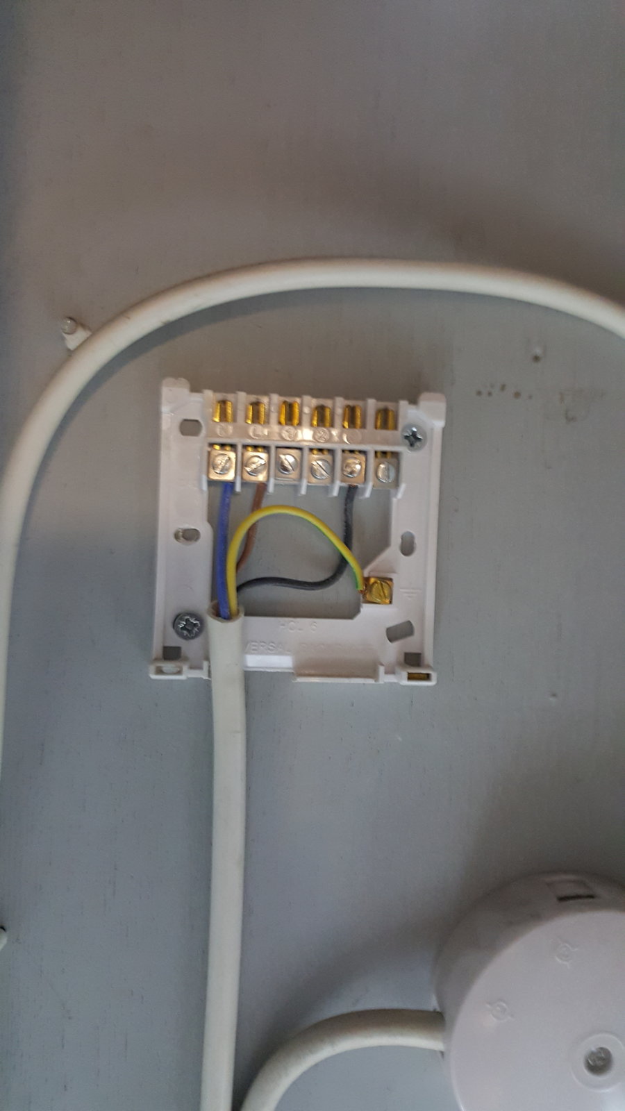

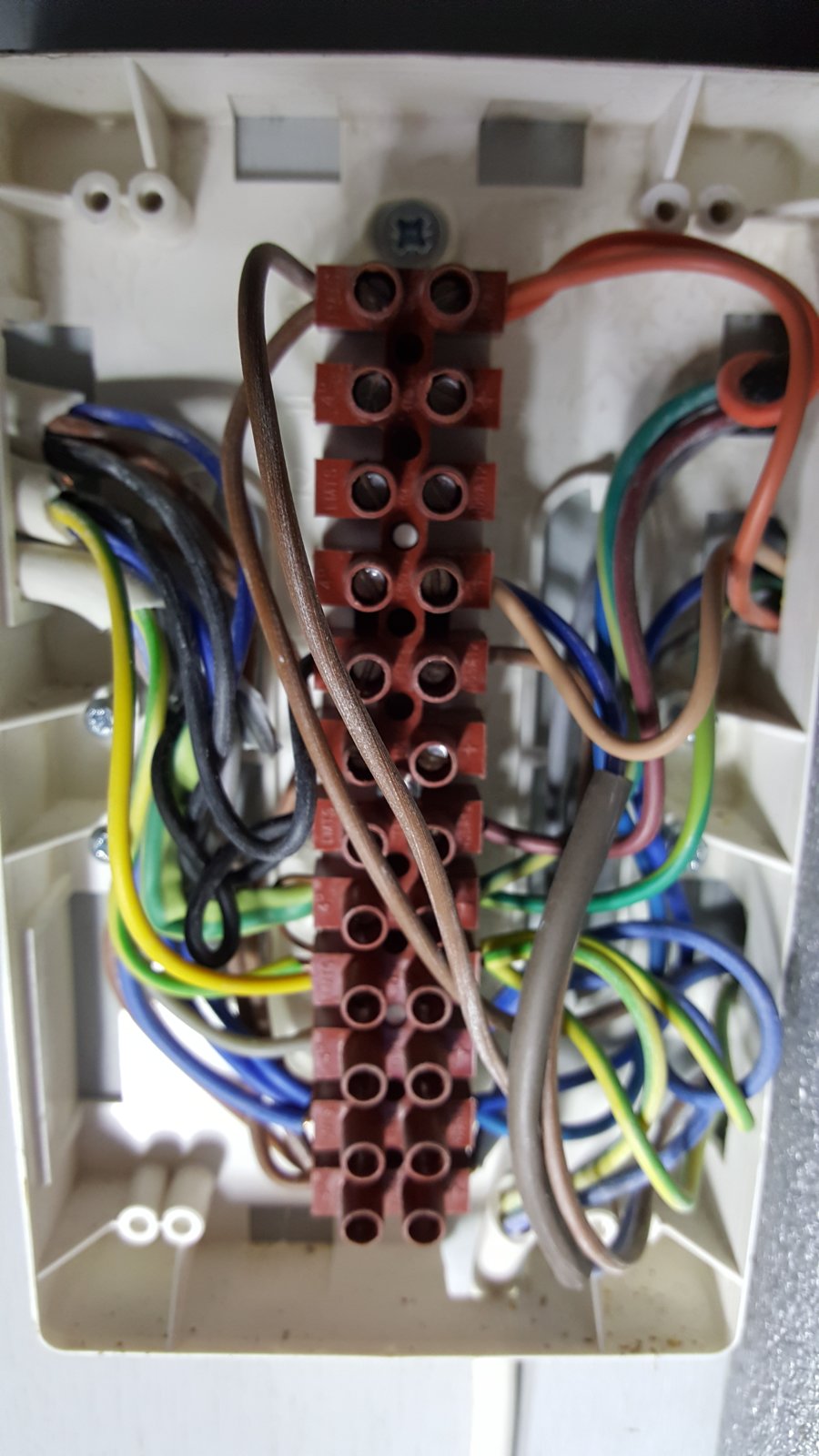

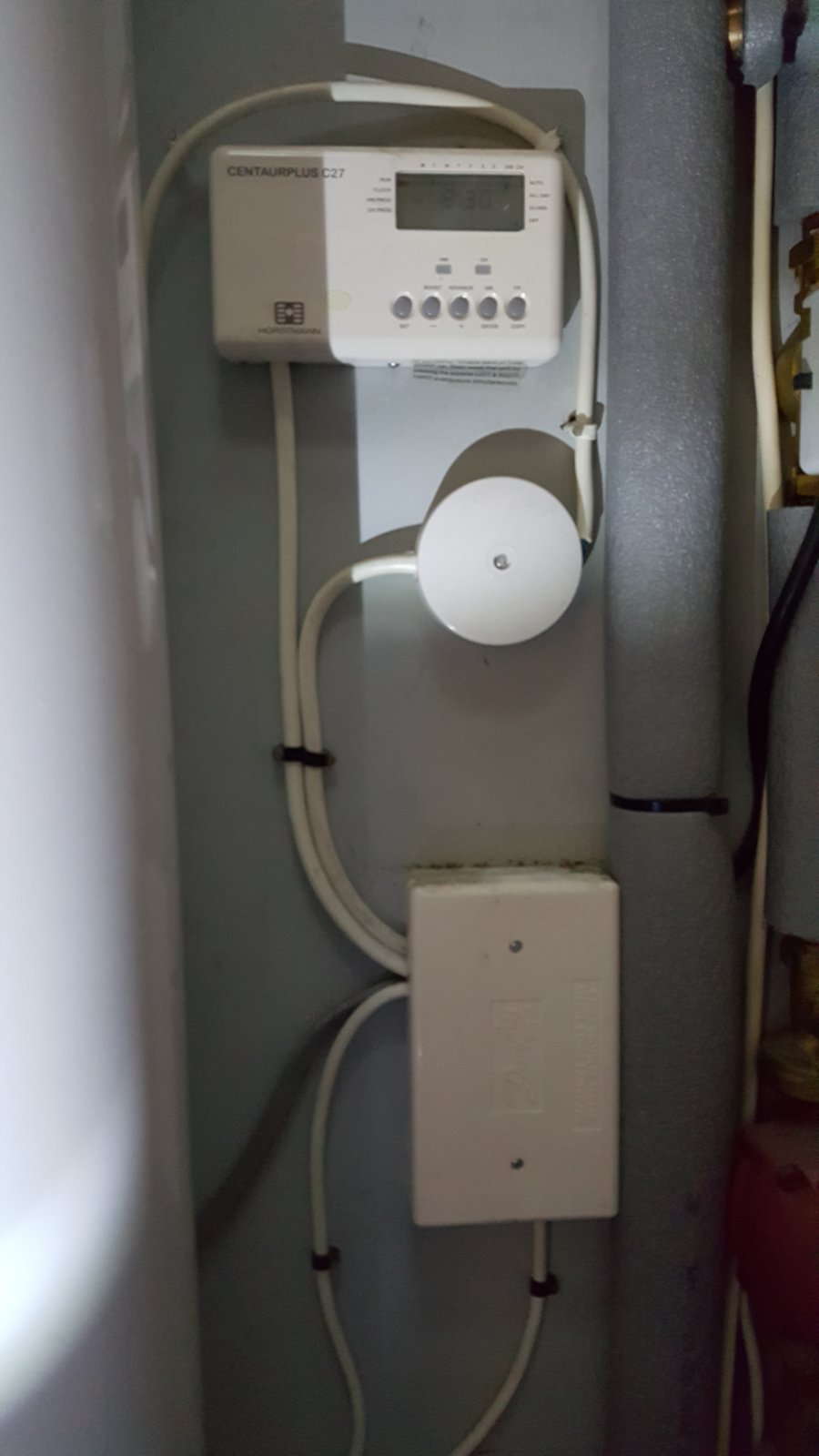

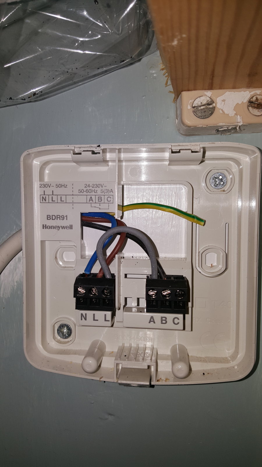

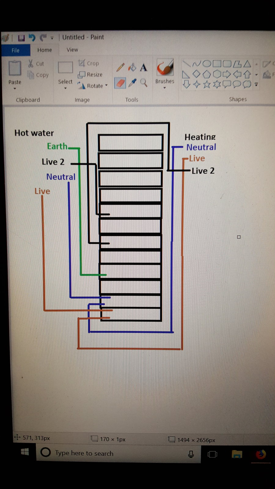

Hiya, hoping someone can help. I've recently purchase a Hive for the central heating and hot water (dual system). I currently have the hot water on a timer (Centaurplus) and the heating on a wireless thermostat (Honeywell BDR91). So far we have ask 4 electrians round 2 have said they can't do it 1 said they would try but weren't confident and the other said we would have to change the wiring completely on the boiler??? So I'm hoping someone on here might have some idea. I've uploaded some photos of what we currently have. Ive done a diagram of the main system as well as shown a photo. Hope it makes sense to someone :- )

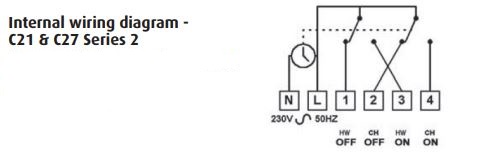

That's a bit odd, yours looks to be one of the easiest dual systems to convert, as you will see. Having said that, my only doubt, is that you say that the BDR91 (which is actually a receiver, not a thermostat) is controlled by a 'room thermostat' which is what the information below is based on and may be different if it was a 'programmable room thermostat' (ie with time control built in) so I am assuming that the time control for the heating is still connected to the heating function of the Centaurplus. [If this is wrong, say so]

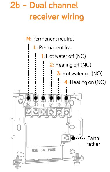

First identify what each of the existing wires going to the existing programmer is for, by noting what terminal each wire is currently connected to and what it actually does. [You don't say what model of Centaurplus you have. The majority are as below. If yours is different don't proceed and post back what you have.]
If your Centaur plus is as above, the wires are identified from the above diagram as:
N Permanent Neutral
L Permanent Live
1 Hot water off
2 Central heating off
3 Hot water on
4 Central heating on
Which as you can see, correspond exactly with the Hive terminals as per the photo you posted. [See, told you it was one of the easiest]
So, just swap them over like for like. There shouldn't be a wire connected to terminal 2, but there may, or may not be a wire to terminal 1 depending on the type of system you have. The other terminals should all have wires in.
The BDR91 receiver will need to be decommissioned to prevent it will overriding the Hive. It can't just be disconnected, otherwise the heating wiring will be 'open circuit' and not operate. This can be done by tracing the wires back from the thermostat and noting where they originate from. Then disconnect the cable at its origin, and the two terminals where the black and brown wires were connected should be joined together. [Alternatively, if you are happy to leave the BDR91 in place, remove the grey link between L and A, and put the brown wire in B with the black one.]

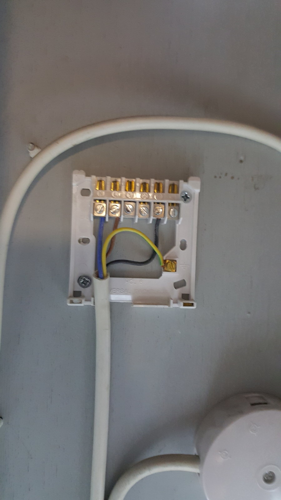

Hiya thank you .Here's a photo of the Centurplus C27 it only controls the hot water which is set on a timer. The central heating is controlled by the Honeywell CM900. I've put a photo of that at the start of the thread.

Ah OK, so when you said "heating on a wireless thermostat (Honeywell BDR91)" What you really meant was heating on a programmable wireless thermostat (Honeywell CM900). And you have a dual channel programmer that has hot water and heating control but is only wired up for hot water control.
So in that case, ignore completely my original post and instead:
The Black wire in the Centurplus C27 is the 'hot water on' wire and should go to the Hive terminal (3) hot water on
The Black wire in the BDR91 is the 'heating on' wire and should go to the Hive terminal (4) heating on

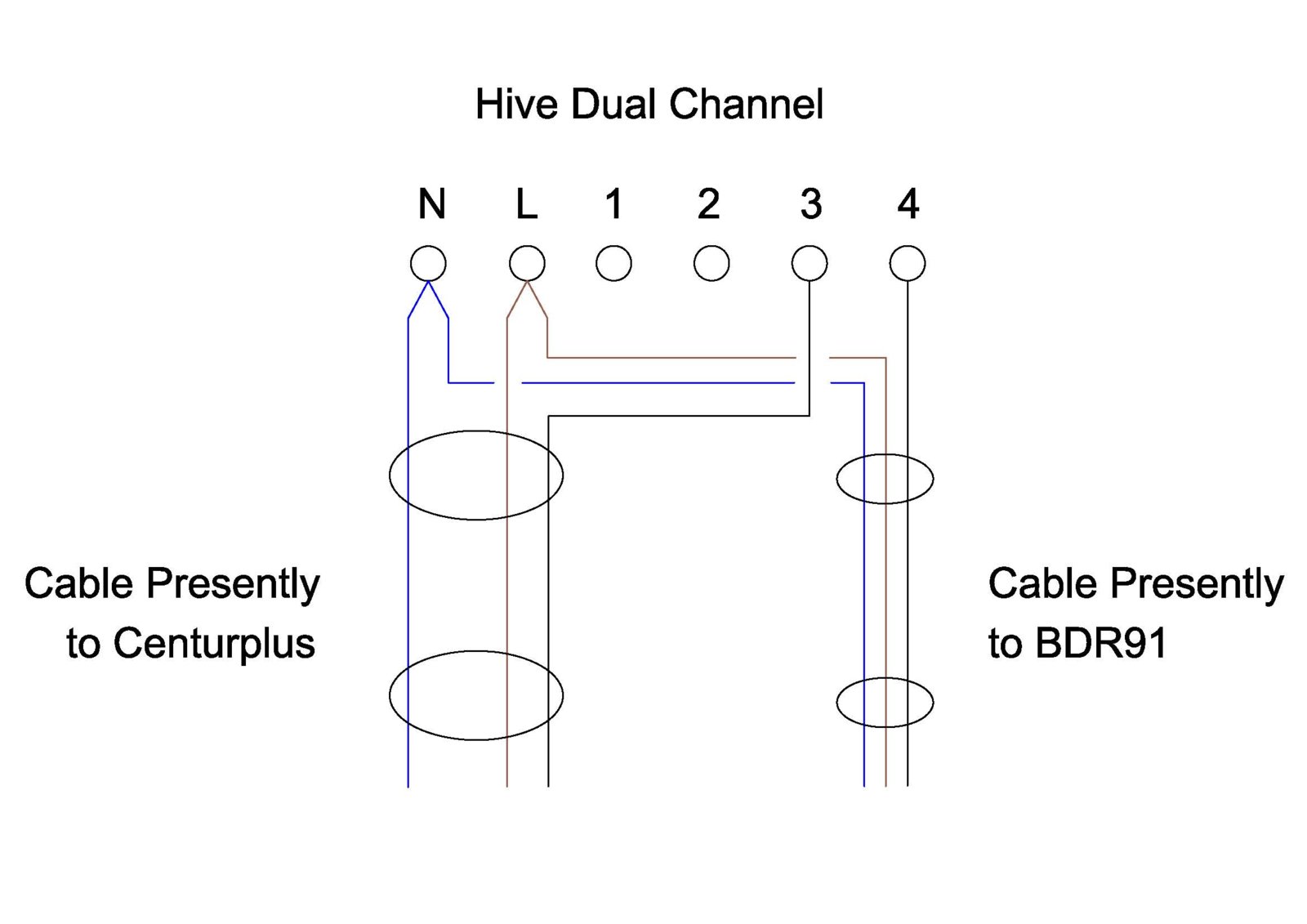

The Hive also needs a permanent Neutral and Live supply, to N and L respectively. This can be from either the BDR91 or the Centurplus, or assuming that they are both supplied via the same fused supply (usually the same one supplying the boiler) then you could connect them both to the N and L as shown below, that way you won't have to disconnect the N & L from one of them at both ends / and isolate them to make them safe.
The Hive will therefore connect to the wiring centre (your first photo).
All you need to do is identify which of the cables go to the Centurplus and which goes to the BDR91 and you are half way home. but please see my earlier post #2
