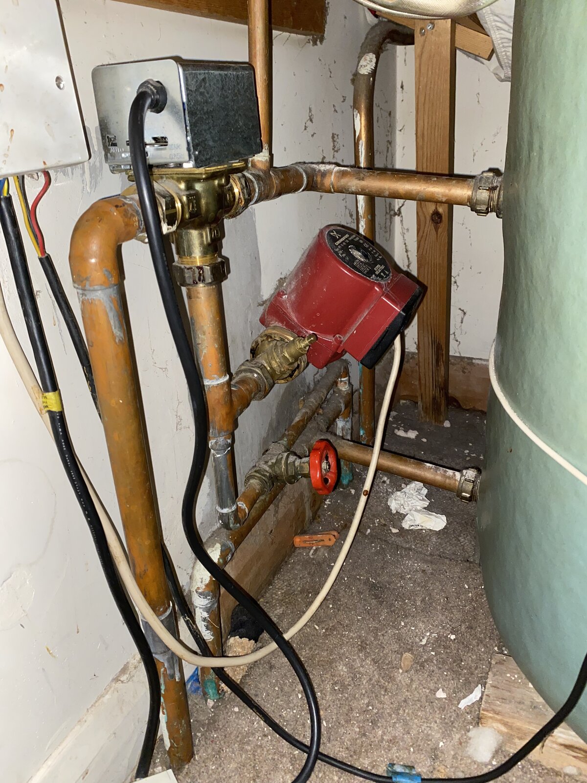

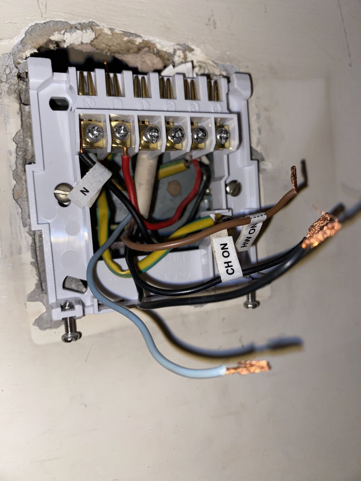

Hi, i'm hoping someone out there can help me. I have an old central heating system with a conventional boiler. Im trying to replace the control with a dual channel Hive unit but I'm a bit stumped on the wiring!
The backbone for the control unit has two cables, one mains power (red, black and earth) and the second cable has four wires, 2 black, one brown and one grey. One of these black wires has a "CH ON" label and the brown wire has a "HW ON" label (see attached photo).
I think the system is pump driven for both hot water and heating, I have attached a photo of the pipes at the side of the hot water tank.
Can anyone help be work out which terminals I need to connect the wires to..?

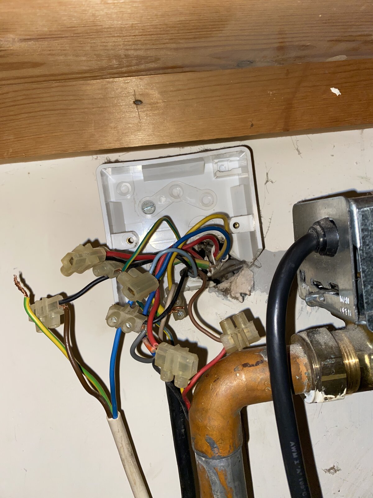

The wiring Center (white box adjacent to the Honeywell motorised valve) can you safely remove that and take a photo of the wiring inside there? Also the wiring hanging out of the bottom could do with neatening.
Hi Chris, I took the front off the "Wiring Centre", it's a nightmare! Just a rats nest of wires connected using single pieces of connector strip! No wiring centre at all. I will try and separate it out so you can take a look at it. I think my next job is to replace this with a proper wiring centre!

OK, this is a photo of the "Rats Nest"! From what I can see, the control wires are as follows:
Black Wire 1 connects to Grey on the Valve and Yellow on the Tank Thermostat.
Black Wire 2 connects to Red on what I assume is the boiler cable.
Brown goes to the Red wire on the Thermostat
Grey goes to Blue on the valve.
I hope this makes sense!

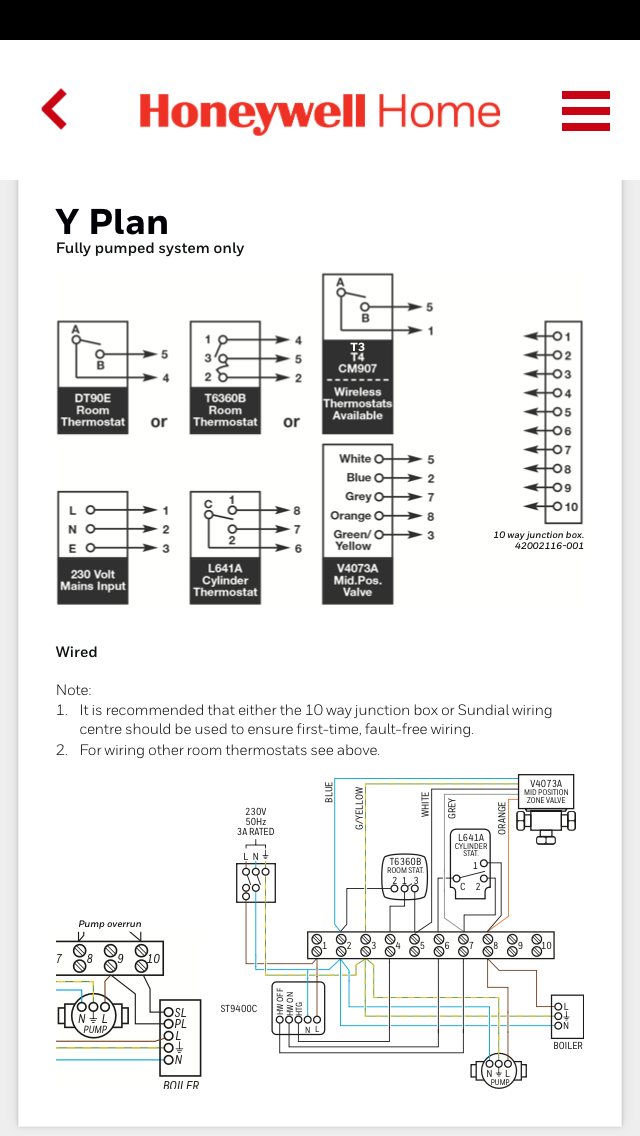

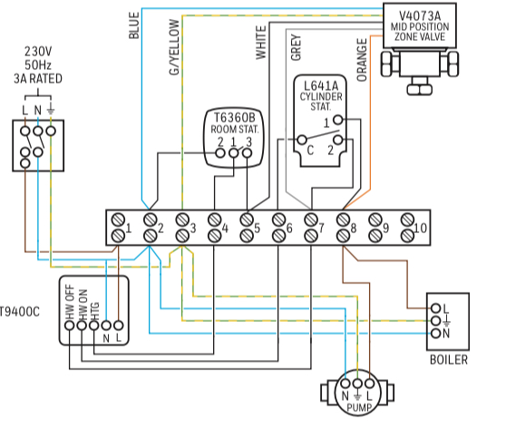

Kind of. I think one of the black is hot water off going to the grey wire. See if this attachment makes any sense to you
Chris, Many thanks for that, I have identified the HW OFF Black Wire now. Only question remaining is what the hell is the other black wire for? It connects to the Red wire on a cable with Red, Blue, Yellow and earth..?

My bad, the question should be where does the grey (blue) wire go. Ive had a closer look at the rats nest and it appears to connect to all the other blue wires in the "Control Centre". I assume this is a Neutral??? Do I connect this to the Main Neutral on the Hive controller?

This is where I am so far. I have Identified the CH ON, HW ON and the HW OFF wires. All that remains is the Grey or Blue wire that connects to all the other blue wires in the "Control Centre"

It looks like the pale blue goes in with a darker blue - if you can figure out what that’s for, then you figure out whether it’s a neutral or not.
