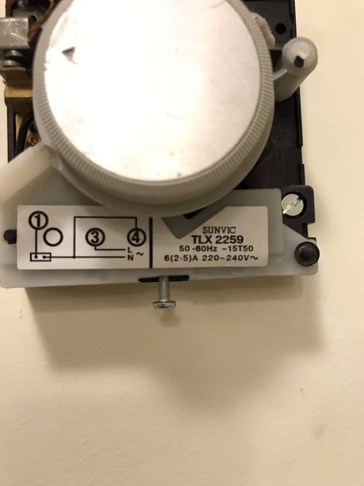

Hi guys. I’m currently trying to install a Hive 2 in our granny annex. We have one main combi boiler and the heating is set up in 2 zones. One for the main house and the other for the annex. The annex has it’s own 3 wire (Sunvic tlx 200) thermostat and near the boiler there is a 4 pole main on/off switch where a timer would go. The main issue is the plumber who wired the heating has left no labels.
Should I wire the receiver into the thermostat or blank that out and wire it where the switch is?

Thanks for your reply. It was less notes and more labels for what wires control the annex and the rest of the house. The thermostat looks to have a live neutral and a switched live? What wires would that correspond to on the hive? Is it the perm live, perm neutral and the heating on? Also should I bridge the live and common connection as I have seen some users on here suggest.
Thanks for your help.

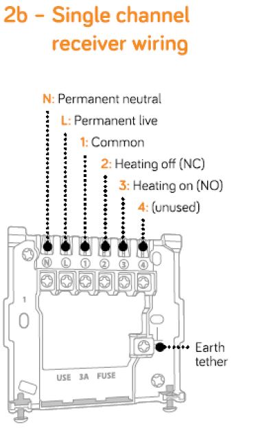

Yours is quite simple exchange as follows:
From your photo of the existing thermostat and the diagram for the Hive Single Channel Version below, we can ascertain that:
Existing thermostat wire to 3 is 'Live' which goes to Hive terminal (L) 'Permanent Live'
Existing thermostat wire to 4 is 'Neutral' which goes to Hive terminal (N) 'Permanent Neutral'
Existing thermostat wire to 1 is 'Switched Live' which goes to Hive terminal (3) 'Heating on'
Then you need to add the wire to link the Hive (L) 'Live' and terminal (1) 'Common' together.
