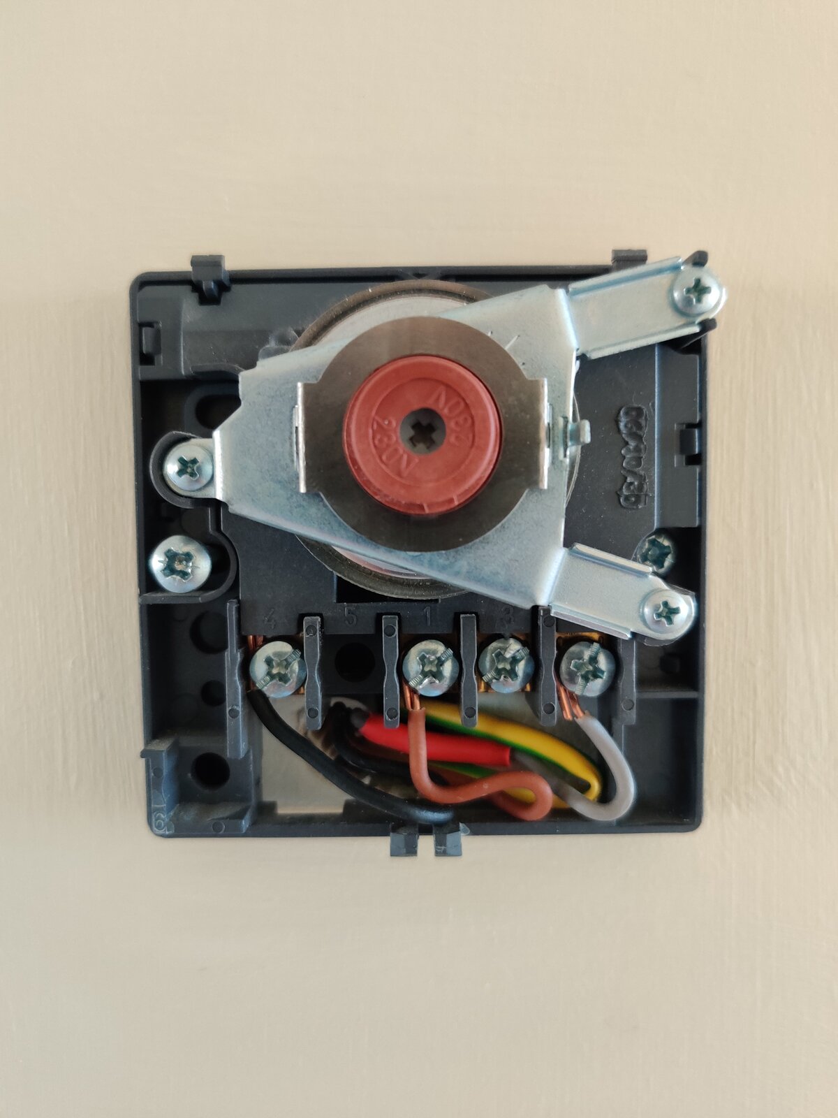

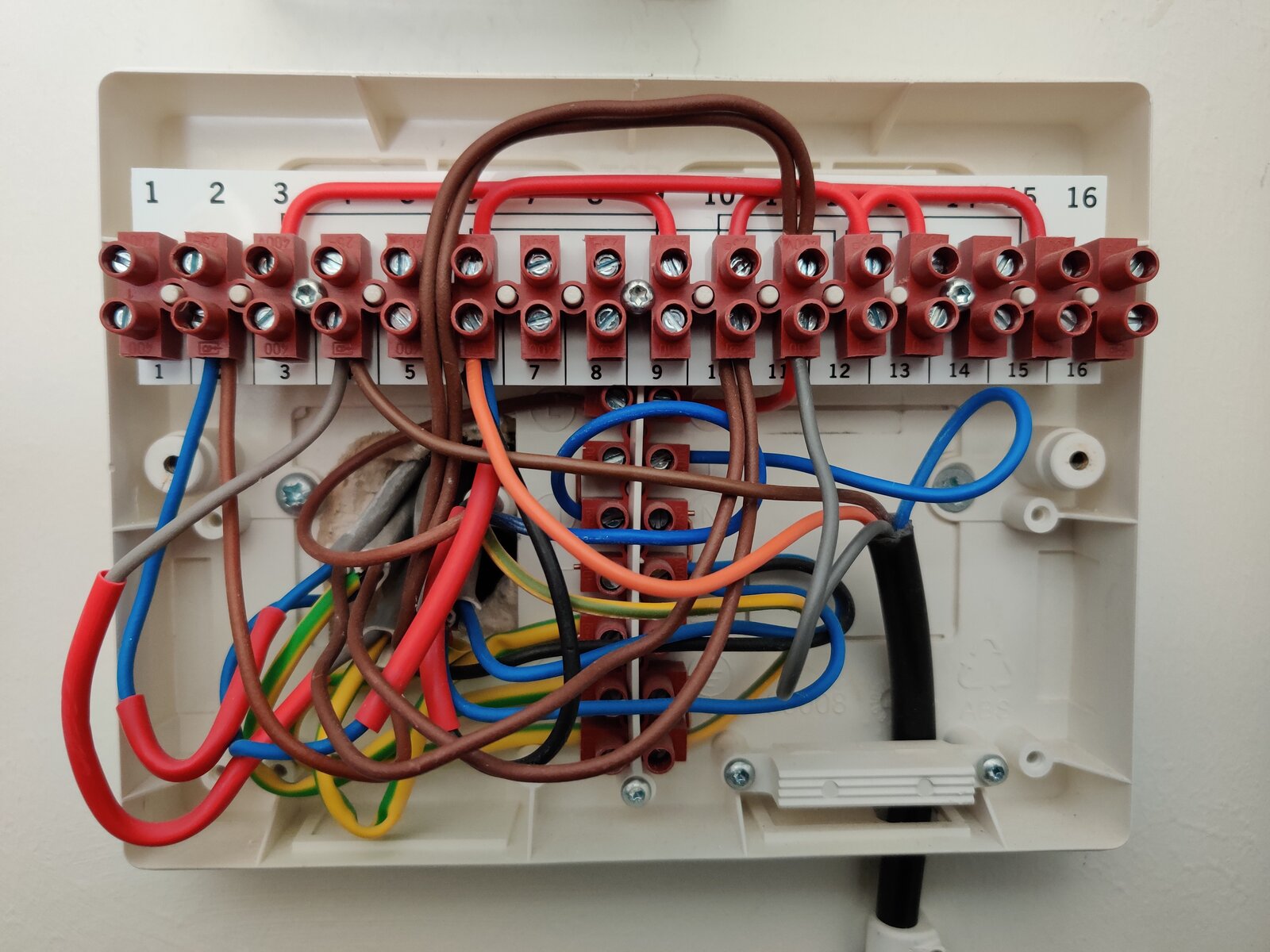

I recently decided to install Hive active heating (thermostat + receiver + hub) as the old thermostat was making a buzzing noise. I managed to set it up and HW works fine, but the old room stat (which itself is disconnected now) or rather it's existing wiring which is still connected is interfering and essentially we've got no CH.
I took photos of the wiring centre in hope someone experienced is able to help putting this right.

The brown, blue, orange, grey cable is throwing me, for a three port valve I would have expected a white wire as well and for a two port would expect to see two sets of cables one for DHW and one for CH.
So it could be a C Plan, but I can't work out from what you have posted.

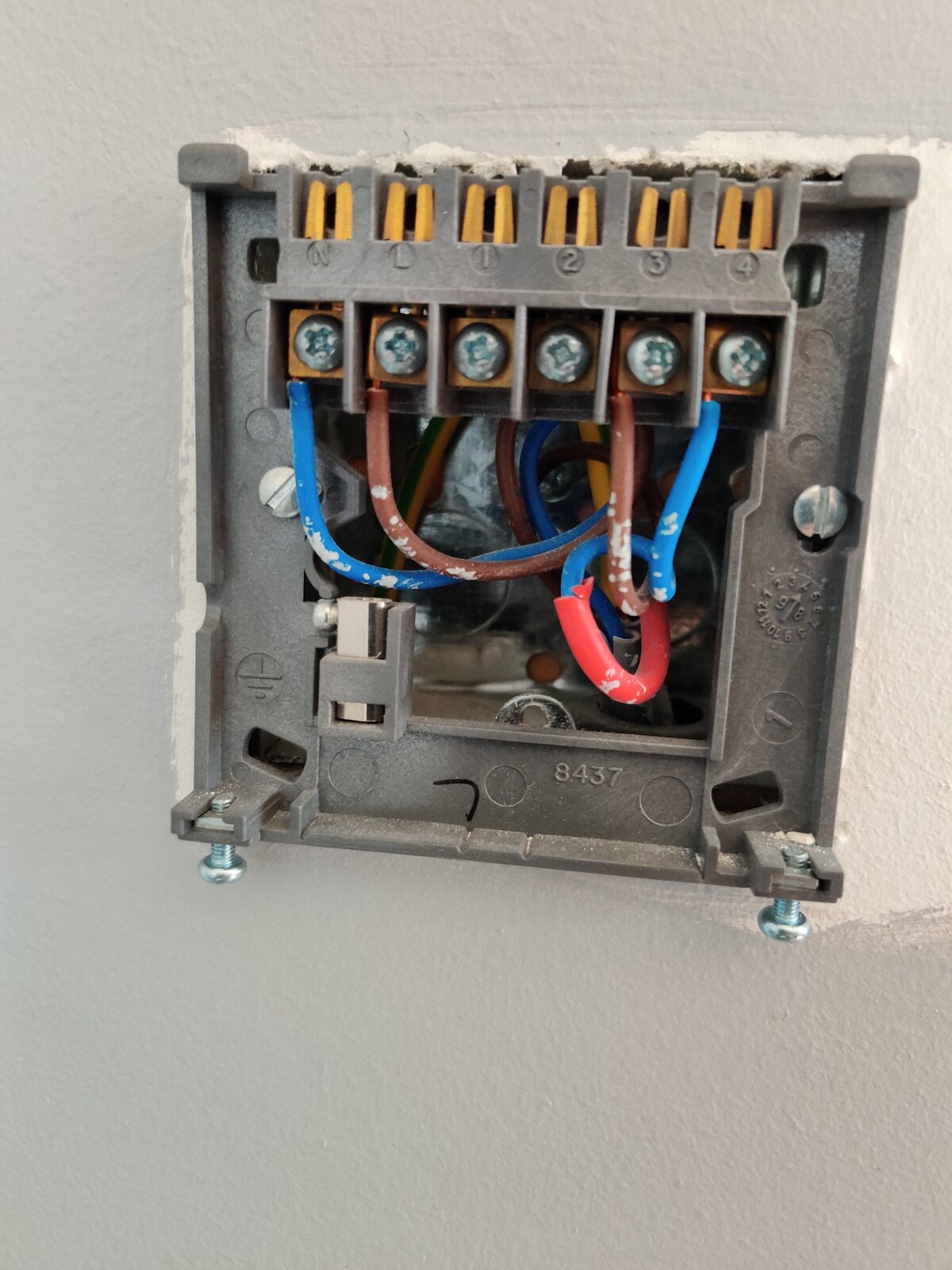

The old programmer for both CH&HW was Danfoss FP715Si [pic 3] and room stat was Danfoss RMT 230 [for wiring see pic 4].

The Hive dual channel receiver will just replace the existing clock the connections are all the same.
To do away with the thermostat you need to disconnect the brown wire in number 2 and the grey in number 4 and the black wire that is also in the same cable.
Then move the blue wire with red sleeving that is in number 2 to number 4 to join the brown wire from the 2 port valve.

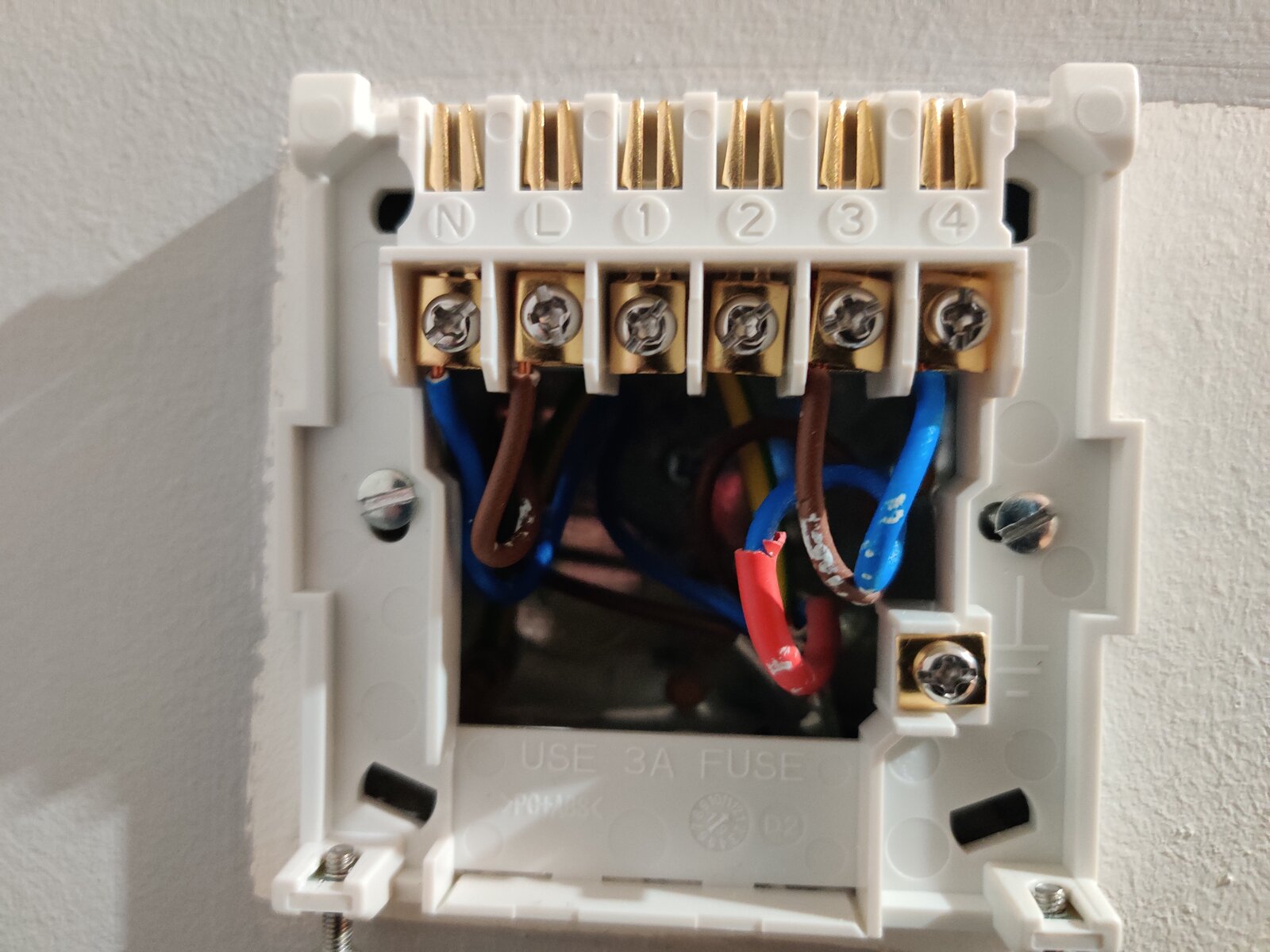

I'm pretty sure that I did exactly this (apart from removing the black wire) when I attempted it first time, but this way the CH sort of follows HW schedule rather than being independent - it could be that the black wire interferes here though so I'll attempt at removing it tomorrow.
Attached is current Hive receiver wiring which, as John have said, is pretty much like for like [when comparing to pic 3].

He has 2 x 2 port valves.
The Danfoss one he shows wired into the wiring centre for the heating, and he says that he has a honeywell one at the cylinder.
It just sounds like a standard S plan to me.
Thank you @ianmcd it did seem odd specially as there seems to be no neutral connected to motorised valve. When I saw "Megaflo water heater" I did think this was a special. Would be interesting to know how it works, is there some link I can't see?
There is a neutral connected to the valve, you can see the blue wire connected in the middle of the wiring centre!
Morning John,
Big thanks for your solution - as said earlier I initially rewired almost exactly the same but left the black wire from room stat still connected and it was the reason it kept on failing. Now it's working as intended, happy days!
