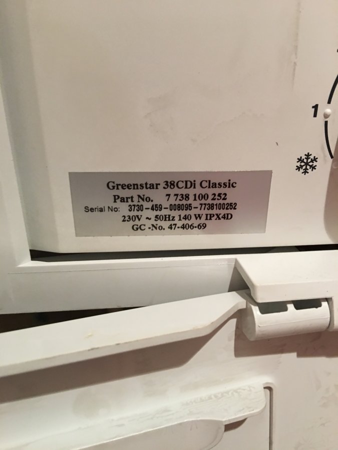

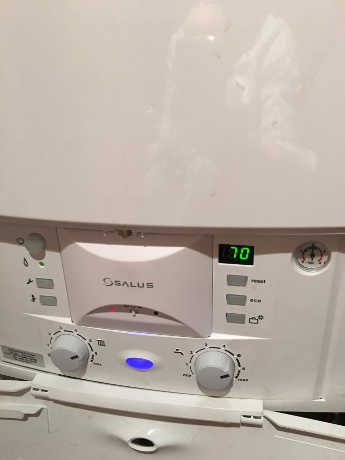

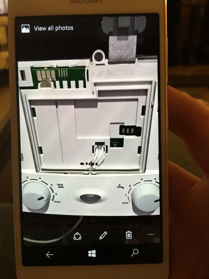

Hi everyone
I was hoping for a quick bit of advice regarding an installation of a Hive system to replace a Salus ST600 wireless thermostat.
My boiler is a Worcester Bosch Greenstar 38CDi Classic
I've attached a few pictures of the current set up albeit without a picture of the front plate completely removed - this is when I lost my nerve!
My question is purely regarding the wiring in of the Hive receiver - there isn't a similar Salus receiver to simple swap over - or am I missing it?
Many thanks
Ryan

That's great scatman John, thanks very much for your help. The Hive installation instructions mention the need for 5 wires? Will 3 suffice? Thanks again. Ryan.
So i wired my Greenstar 38CDi as per this diagram. Hive router, thermostat and receiver all connected. Says heating is off but Boiler is still firing. Any idea why?
Sorry to bother you again John
