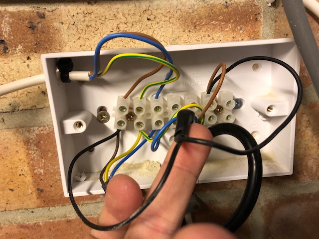

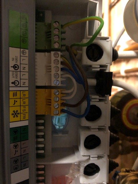

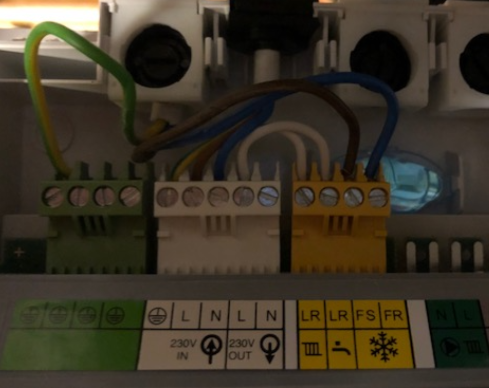

Iv attached a few pictures. Yes you are correct the boiler is a Worcester boiler.
The black cables coming into the junction box are from a Saurmann pump.

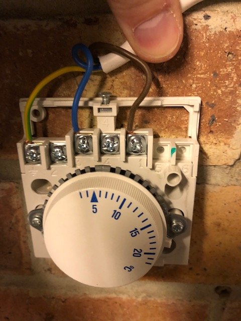

The cables from the mechanical thermostat i have connected to the hive receiver

First of all. Looking at the wiring, apart from the mains supply, there are only external connections to FS and FR. So it would appear that the mechanical thermostat is wired to these terminals. If so that is a frost thermostat and is only there to provide frost protection as it overrides everything to turns on the heating if the temperature drops near freezing. It is the totally the wrong place to connect the Hive. If so, put the mechanical thermostat back and leave it set to the 5 degree frost protection setting marked with the blue arrow.

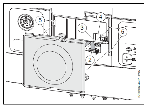

As there are presently no wires connected to the boiler terminals for external controls, the MT10RF will be connected to an internal receiver inside the boiler. If so this would need to be decommissioned by a competent person, and then the Hive wired in properly.
The wiring you have posted is not for your boiler. The terminals are not the same. There are lots of Worcester boiler variants. I am worried that you don't have the necessary understanding of what you are doing to do this safely. Please get a professional to do it for you.

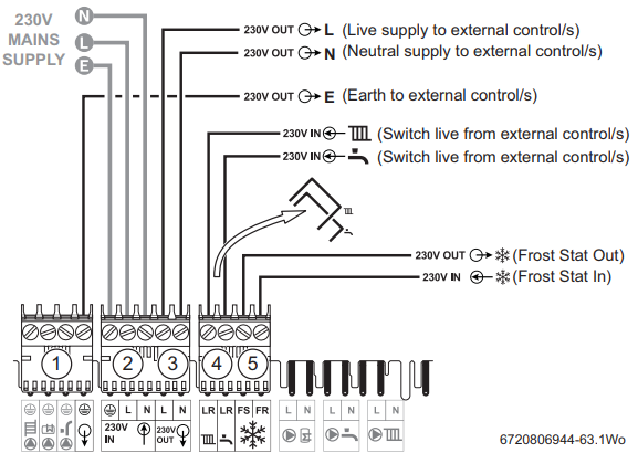

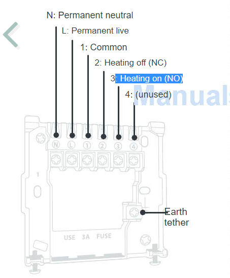

ok, so i can see from my boiler there is no connection going external from LR CH and LR HW. Is it not a case that I need to run a wire from LR CH from the boiler to 3: Heating On, on the Hive Receiver?

OK, now you're talking. My apologies if I misjudged your competence previously, but wiring a Hive to the frost stat terminals is well.........
Anyway, your last post is correct. The existing white link in LR CH would need to be removed as well.
The Hive N & L will also need to be connected to the same 3A fused spur that supplies the boiler, and the Hive live (L) should also be linked to Hive terminal (1) common.

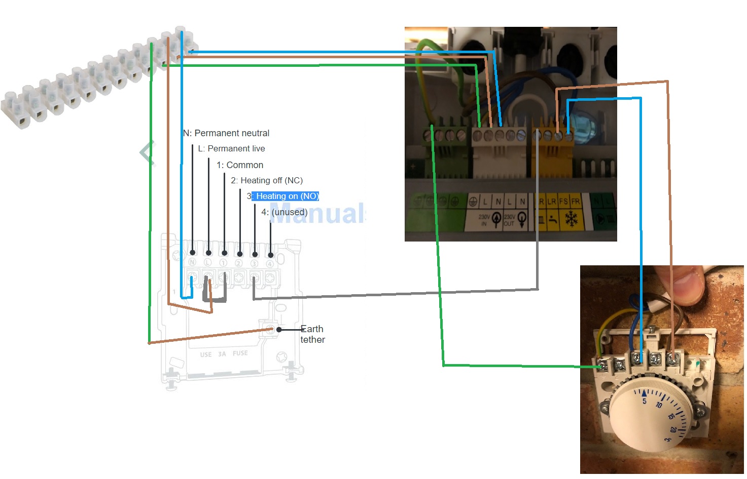

So something like the attached?
Yes, Hive wiring looks OK to me.
You could use the '230V Out' terminals to connect the Hive N & L to. They are there for your convenience specifically for external control. Having said that, they won't help you that much as the hot water link is in the L already.
The frost thermostat and condense pump should stay as they originally were.
