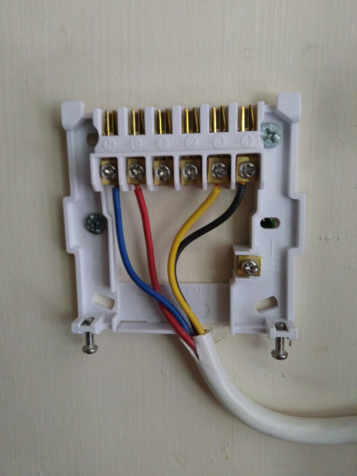

We appear to be having Hive issues out of nowhere, I wondered if anyone is knowlegable about this?
We self installed Hive a couple months back, it was easy enough in terms of fitting the receiver, our system is gravity fed with a condensing boiler, following the instructions without issue. We left our old thermostat on the wall as we heard conflicting views regarding whether it was still needed or not. Ever since this has worked fine, normally our system allows for hot water on its own or heating which will heat the hot water automatically (both heating and hot water lights are active on receiver). As of today we not cannot have the hot water on without the heating also coming on, it does not show as lit up on the receiver, we just notice all the radiators heating up. No changes have been made to the system since yesterday, the only recent change at all was getting a smart meter installed last month, any ideas what we can do?
Post a few photos of the controls you have , motorised valves, pump and the wiring if you can.

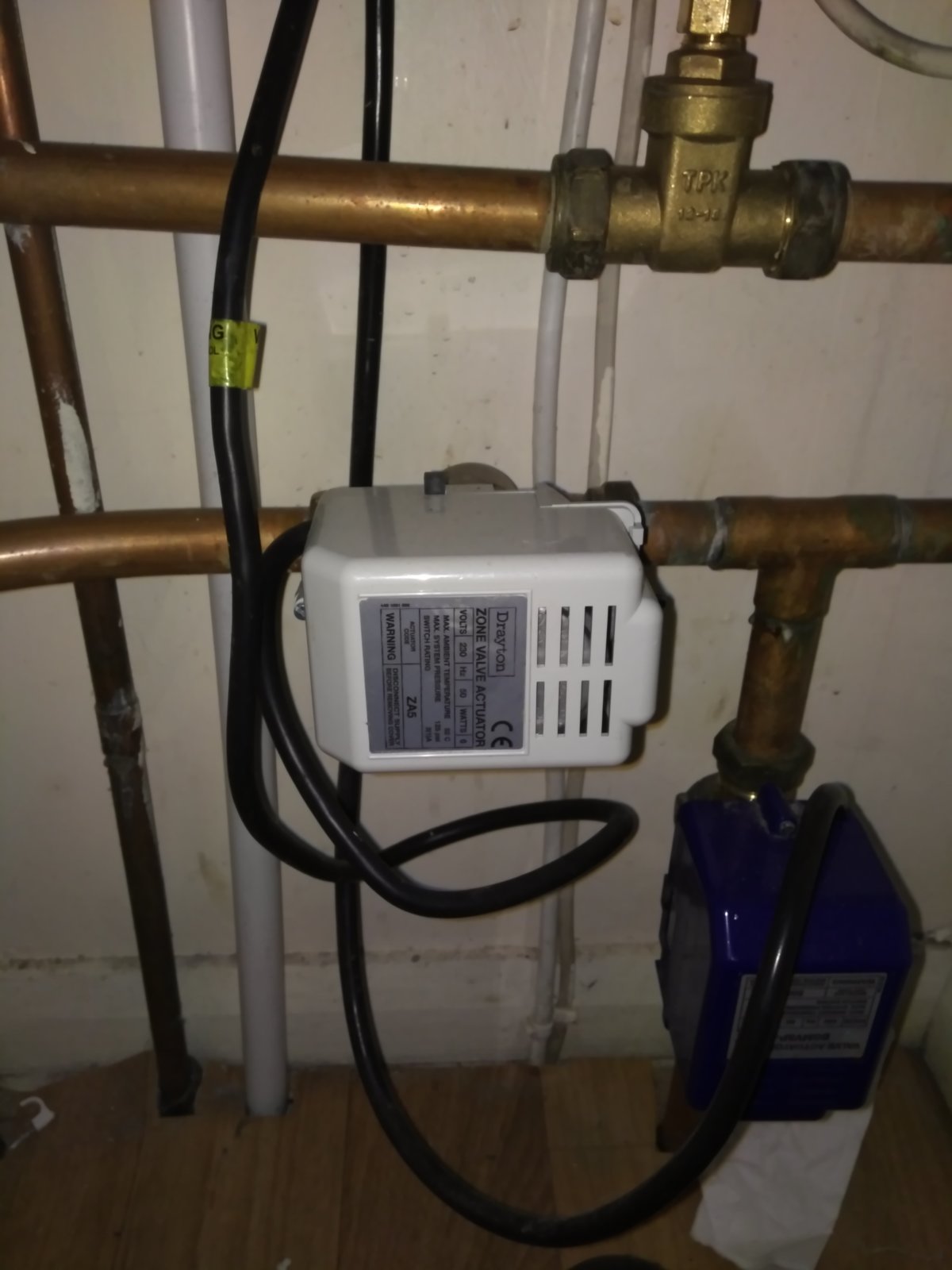

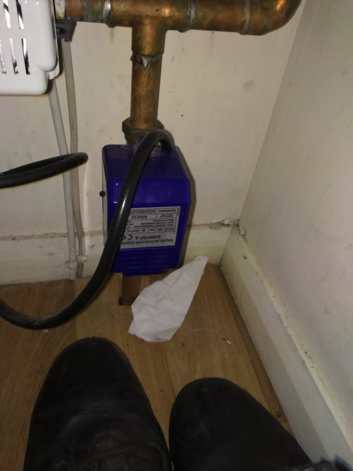

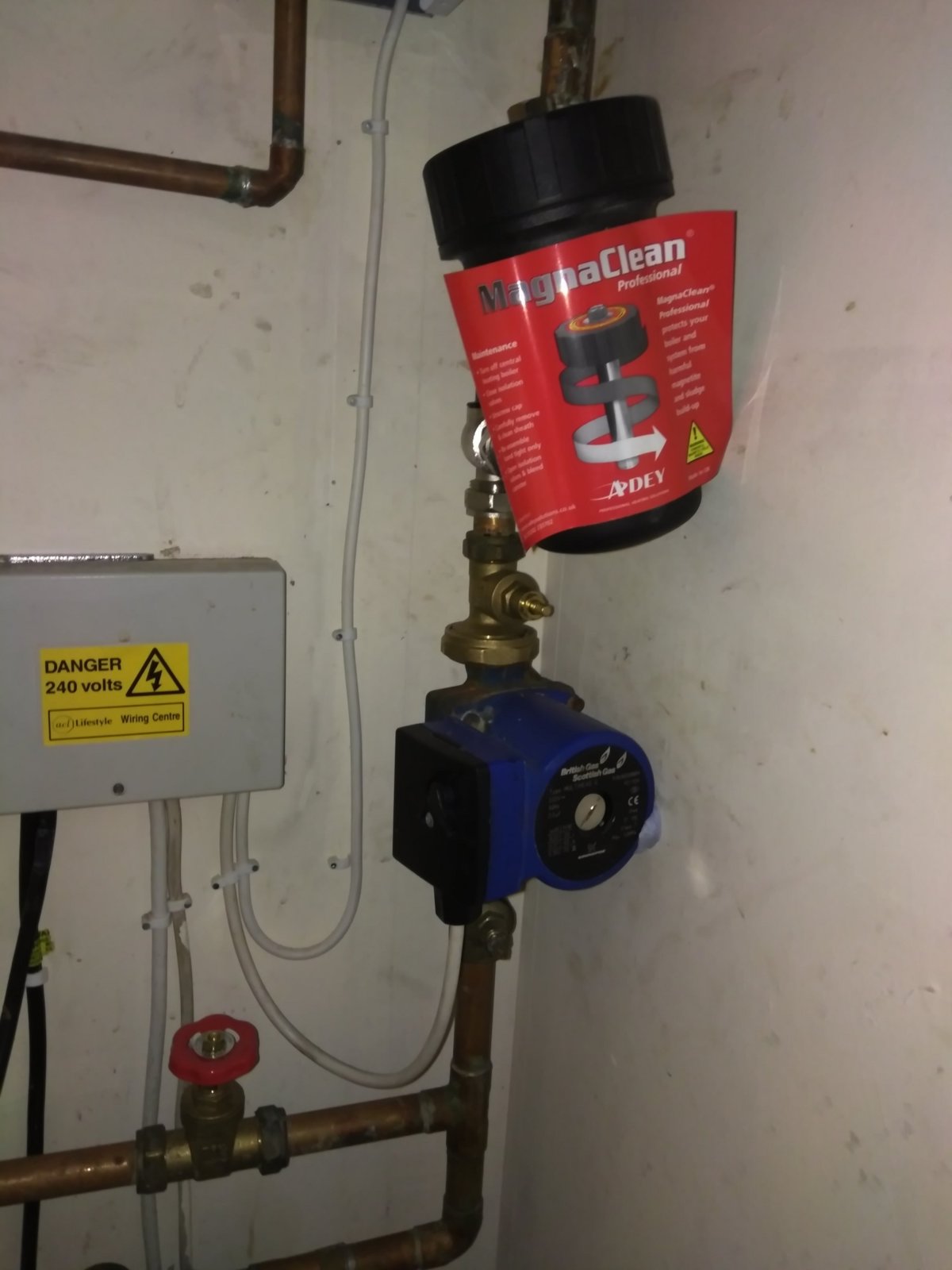

Thanks for the replies and sorry for the delay, here are a few photos for now, hopefully they are useful, if you need to see anything else pleas let me know.

One further photo

sounds like your mid position valve is passing. re room thermostat you can leave it where it is turned up to max....its just a switch. better to link it to be permanently calling for heat if its just left to cover a space but even better to disconnect the wires to it at the junction box and put a blanking plate where it was. Your house though, you can do what you like.
