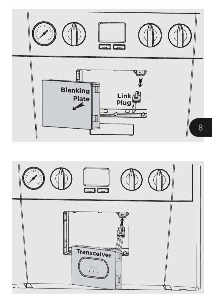

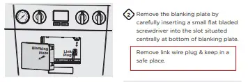

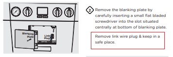

There is a wire loom that I found. But I thought this was removed from the Opentherm connector when the boiler was installed. When I remove the blanking plate, the plug that went into it, gets plugged into a spare plug on the same wiring spur (according to the Ideal installation manual). Where would the spare wire loom connect to?
I'm sorry, I'm a little unsure of what you are trying to say here.
Behind the receiver, there should be a connector, and this is where a link plug should go...

And did you reinstate the wire link that was removed from the end of the wiring loom when the built in receiver was fitted.
Replacing the the little plug closes the circuit that would be left open by the removal of the receiver.
Gents, I've finally resolved the issues, phew! I located a purple link wire with connector in with the boiler documents. The only place it fits is in the connector left behind when I remove the Ideal receiver. I plugged it in and it started working immediately. Balance has been restored. Thanks for all your time and patience
