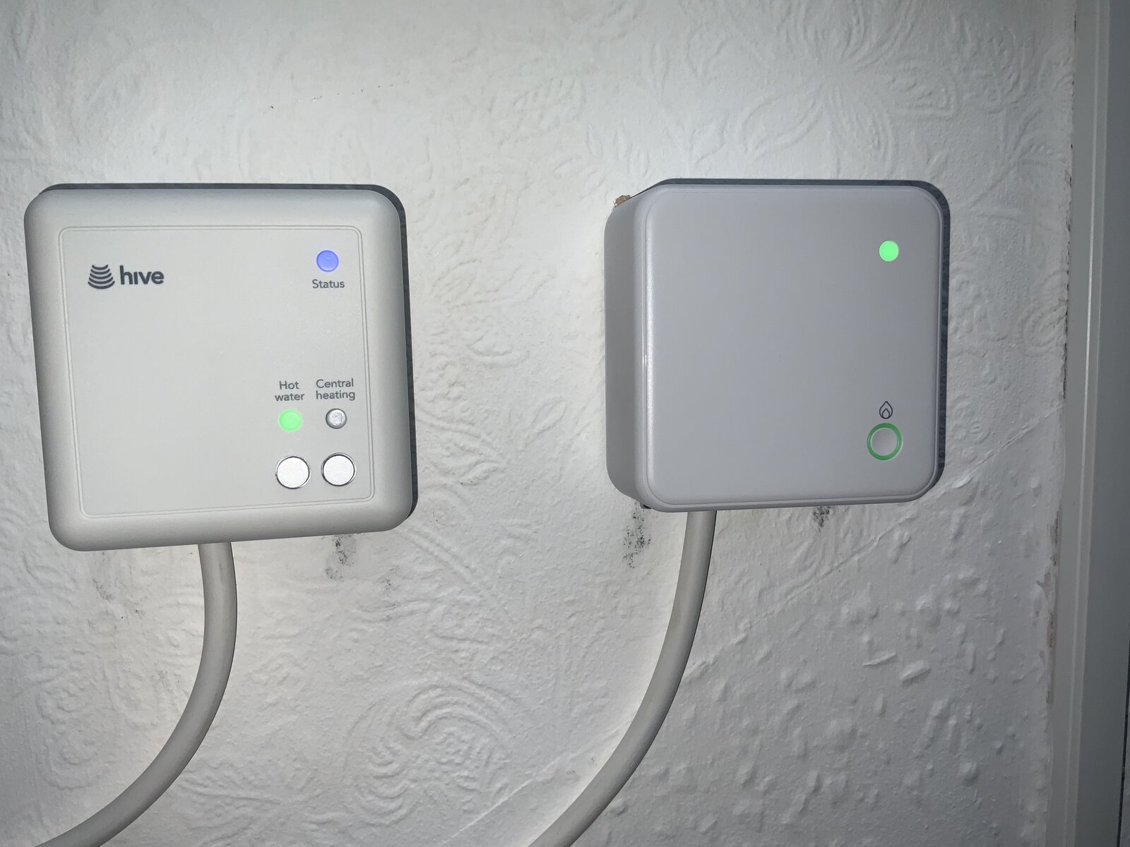

I’ve recently replaced a bit of a hybrid controller system on my old c plan ideal Mexico floor standing boiler. It all operated fine but wanted to make programming a bit simpler.
I have an c plan system with gravity hot water and pumped heating. There is a zone value on the hot water along with a tank thermostat and I have two central heating zones. I have a dual hive receiver set to gravity mode and a single receiver for the other heating zone upstairs.
It works as expected on the main two channel receiver in gravity mode, I.e. hot water turns on/off and when I activate the central heating on it turns on the heating with the hot water when I want CH, all fine.
BUT when you turn on the 2nd heating zone via the other single channel receiver this opens the zone valve for upstairs heating and activates the pump but doesn’t fire the boiler or the hot water.?
What am I missing. How do you get the 2nd single channel reviver to know it’s paired to a gravity mode dual channel receiver. Or should I be adding another wire somewhere to connect the 2nd heating ON to the HW?
it seems that the hive system just doesn’t know the 2nd reviver should fire up the HW when it’s turned on.
So in order to get heating from the 2nd zone via the single channel receiver I must manually ensure the HW is on.
there are no connections from the heating zone valves i.e. on the micro switch to the boiler. This was managed via the old hortsman programmer previously and now via the hive. I thought the hive would be clever enough to tell the 1st receiver that when the 2nd receiver wanted heating it would tell the 1st to turn on the water but no.
I must be missing a connection somewhere to activate the HW and boiler when the 2nd receive calls for heat and operates the zone valve. Wasn’t sure though if you wire that to the boiler or back to the HW in the 1st hive receiver?

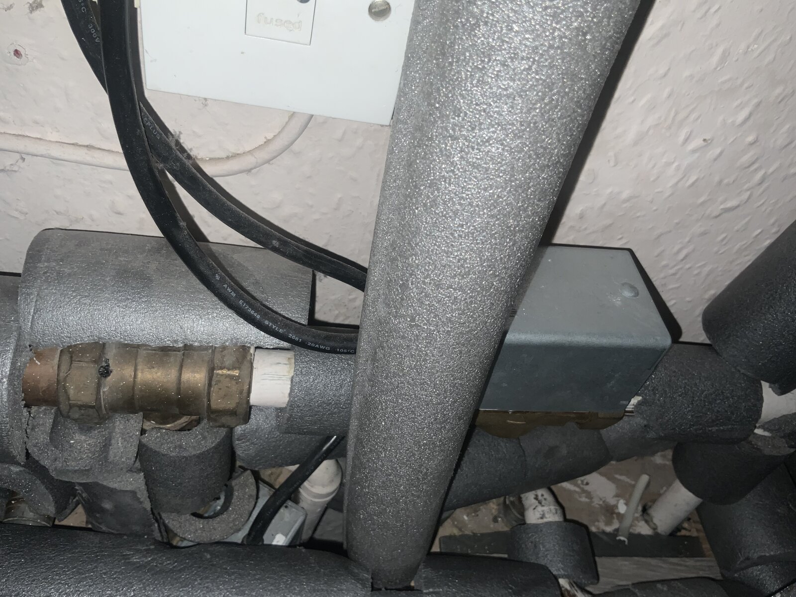

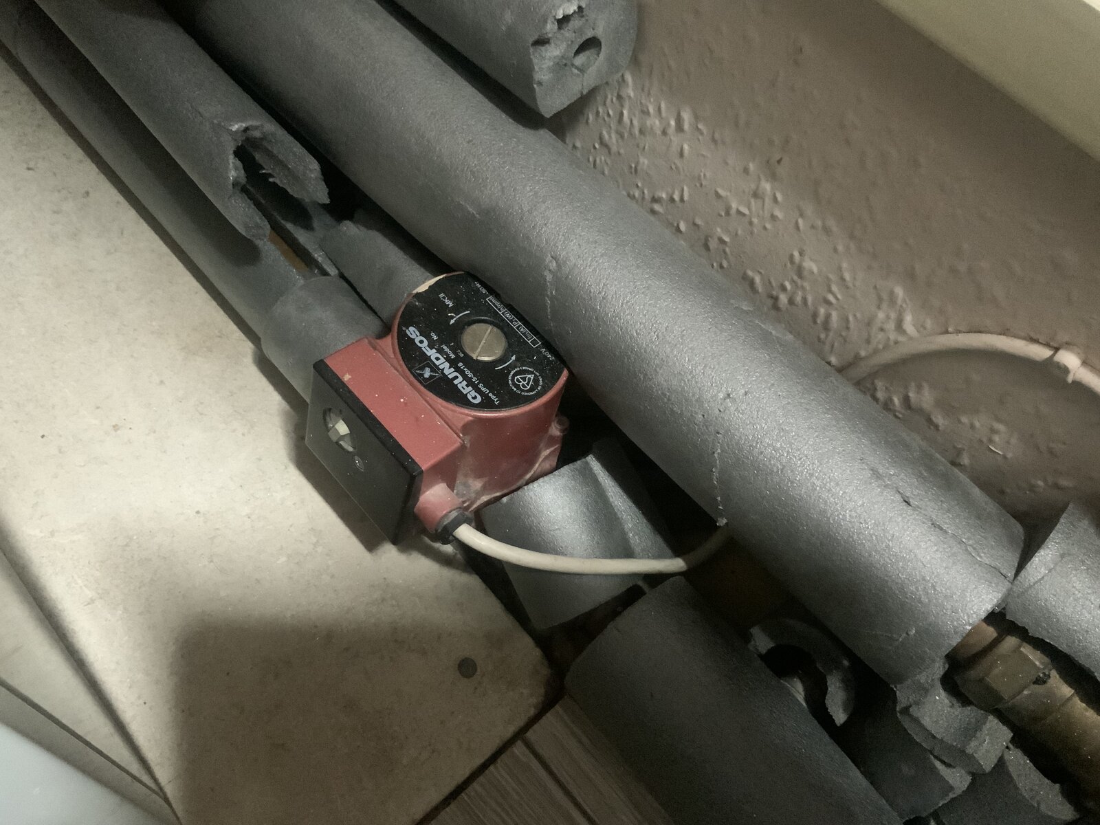

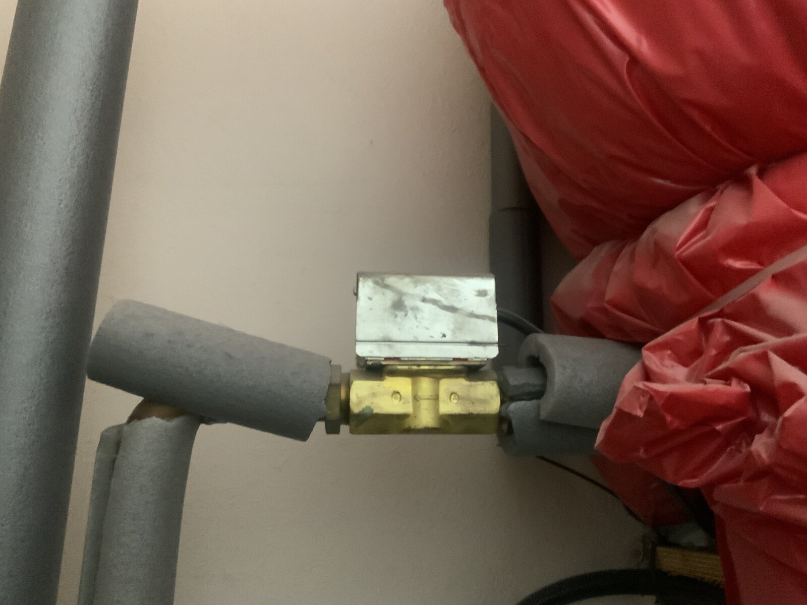

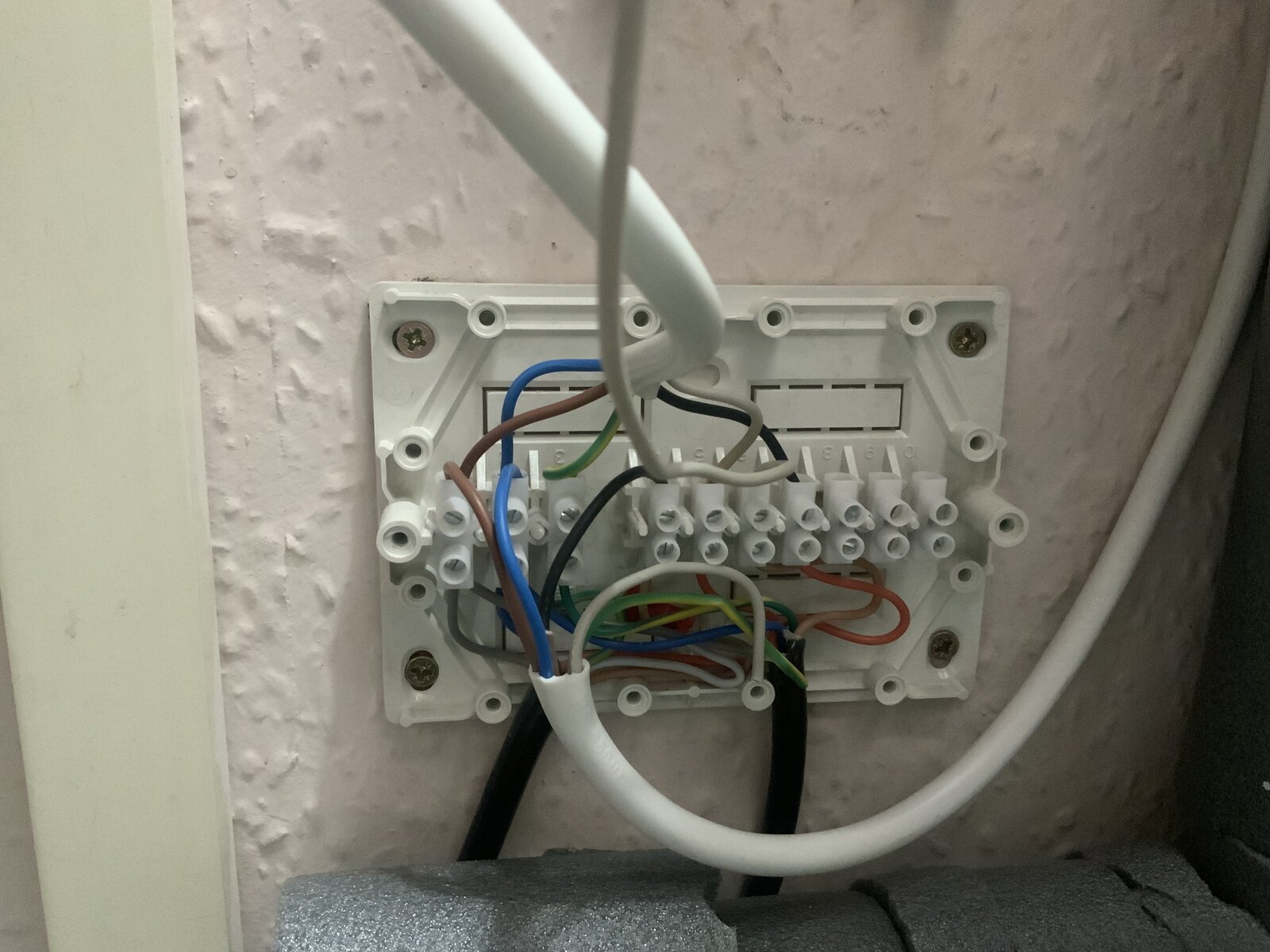

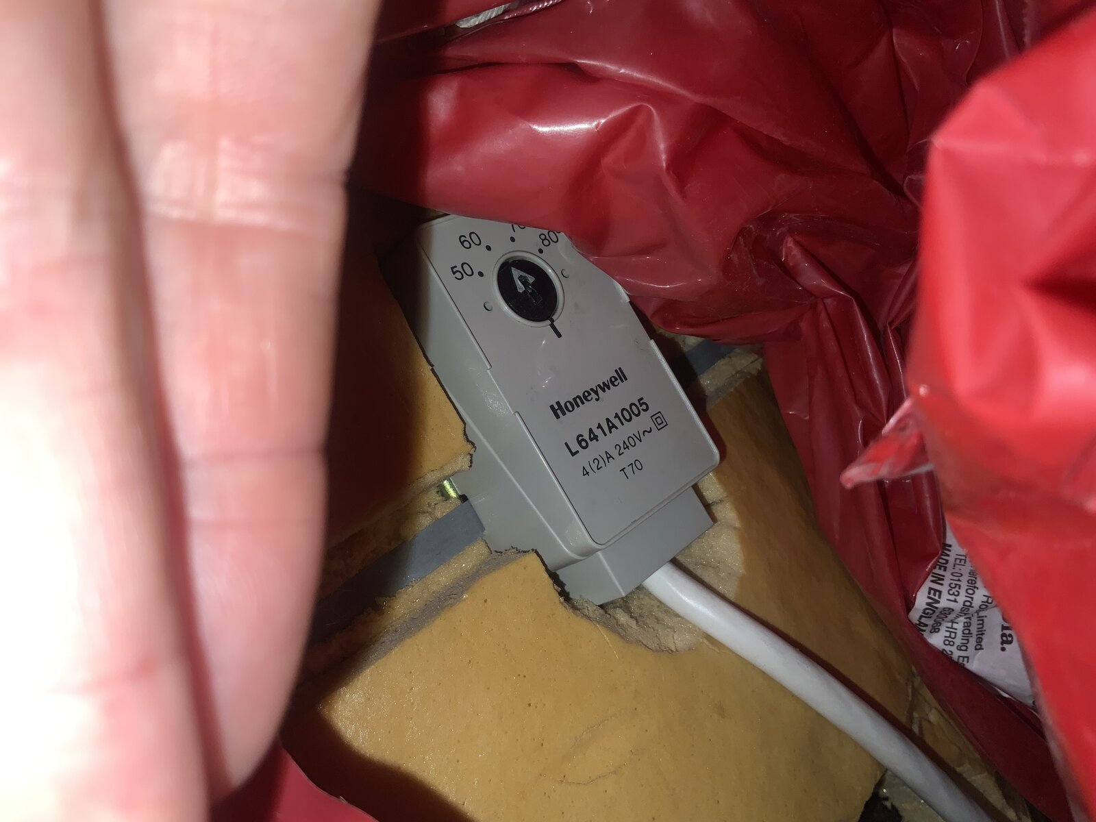

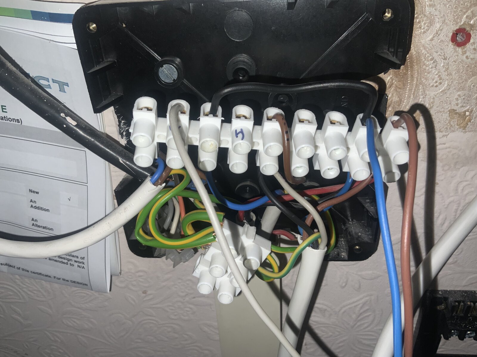

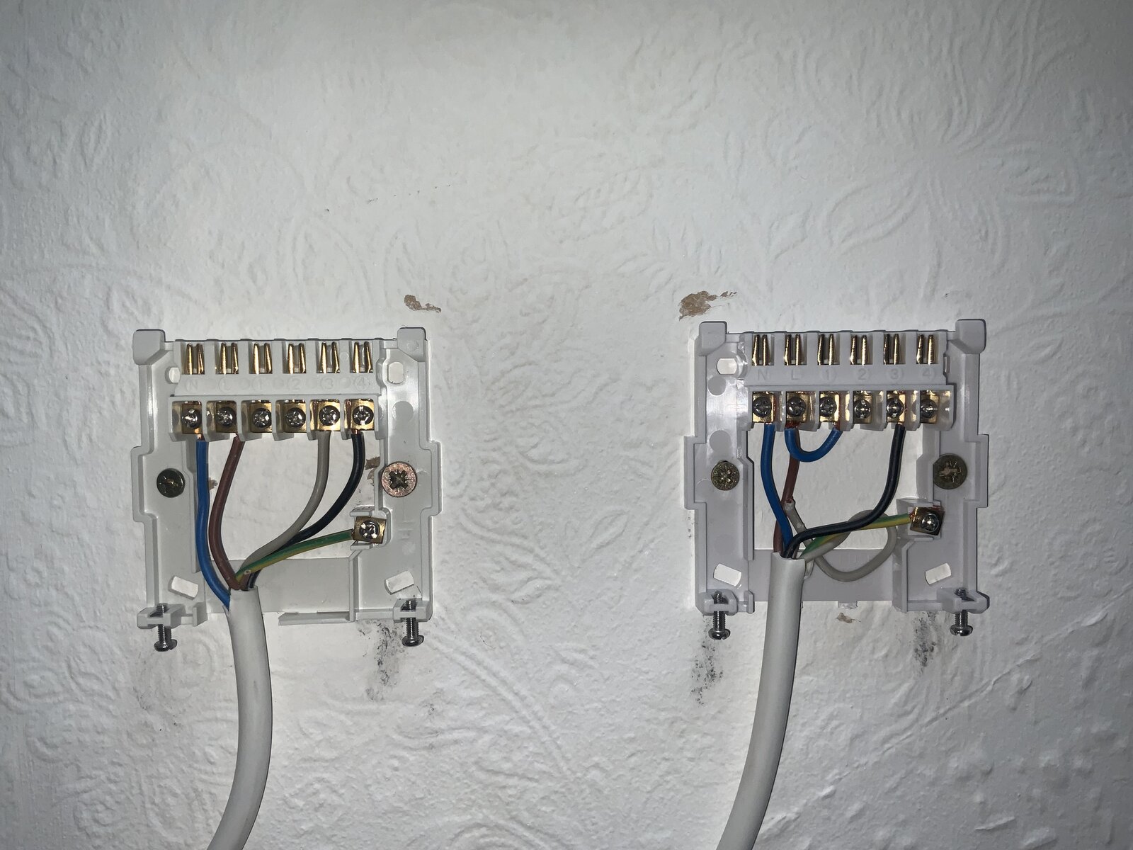

The first picture is the cylinder stat. 2nd is the DHW zone valve. 3 is the heating pump. 4 one of the heating zone valves, the other is out of view. 6 the new hive receivers. 7 wiring centre that connects the heating zone valves. 8 the two hives, showing the wiring. 9 main wiring centre.
I’ll try my best to explain how things are connected next…
Main wiring centre - the messy one
1. Cylinder stat, DHW zone valve
2. Hot water on from Hive (1st receiver, no. 3 connection), boiler, cylinder stat
3. Neutral for boiler, DHW zone valve, CH pump
4. Na
5. CH pump (switched), connection to each CH zone valve. 5 and 7 in other wiring centre, connected to orange zone valve cables.
6. Na
7. Neutral. Hive receivers and heating zone valves in other wiring centre.
8. Live. Hive receivers and zone valves via other wiring centre.
other wiring centre, the white one.
1 live
2 neutral
3 earths
4 heating on from 2nd hive, connected to upstairs zone valve brown wire
5 connected to 5 in other wiring centre I.e pump.
6 heating on from first hive, connected to downstairs zone valve brown wire
7 connected to 5 in other wiring centre, I.e. pump.
The 1st hive receiver is the dual channel hive. It operates fine, hot water and heating. The 2nd hive single channel receiver works but will not fire boiler.
I suspect I need to link this somewhere but don’t want to guess! If I had to guess, link the an output from the upstairs zone valve to No.2 on main wiring centre, so when value opens it sends power to that terminal which fires boiler?

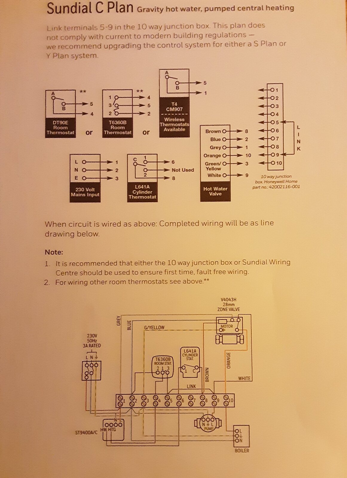

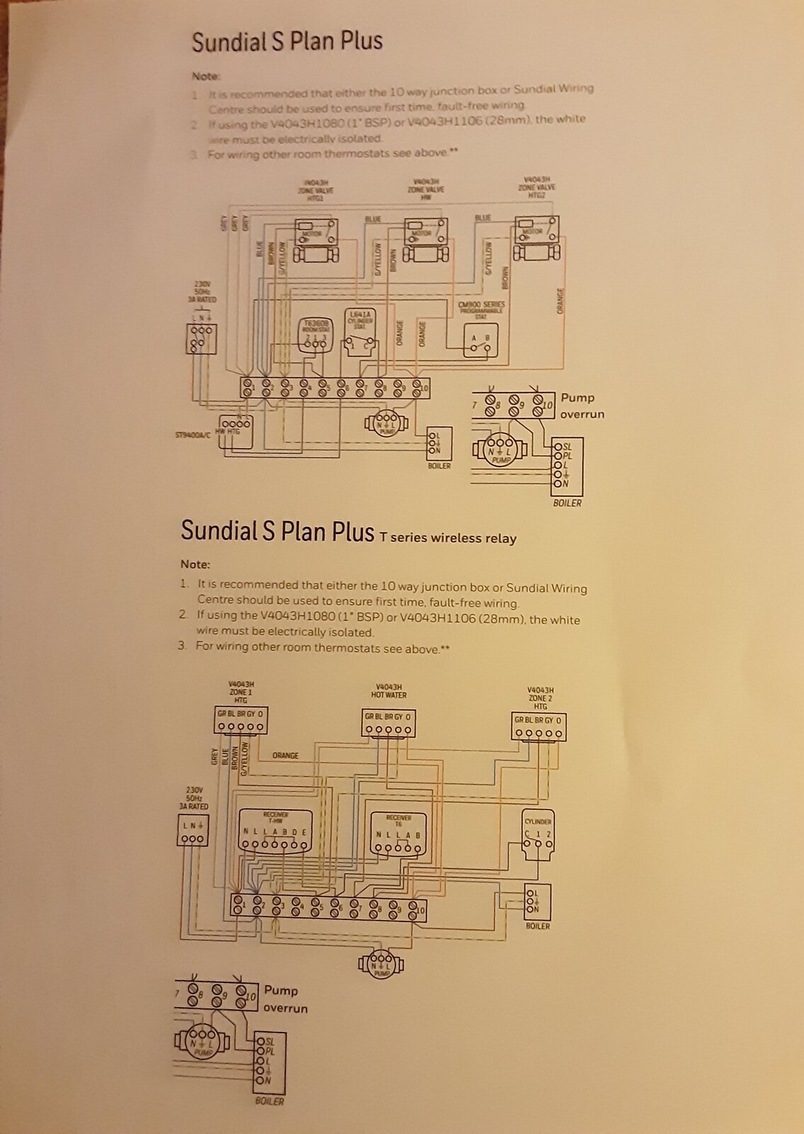

Attached pics for C plan and S plan plus maybe start again?
Thanks for the wiring diagrams. System was inherited years ago, works so I’ve just left it be. Only issue now, apart from mess! Is the fact zone 2 will not fire boiler. Rewire may be a job for Sunday.

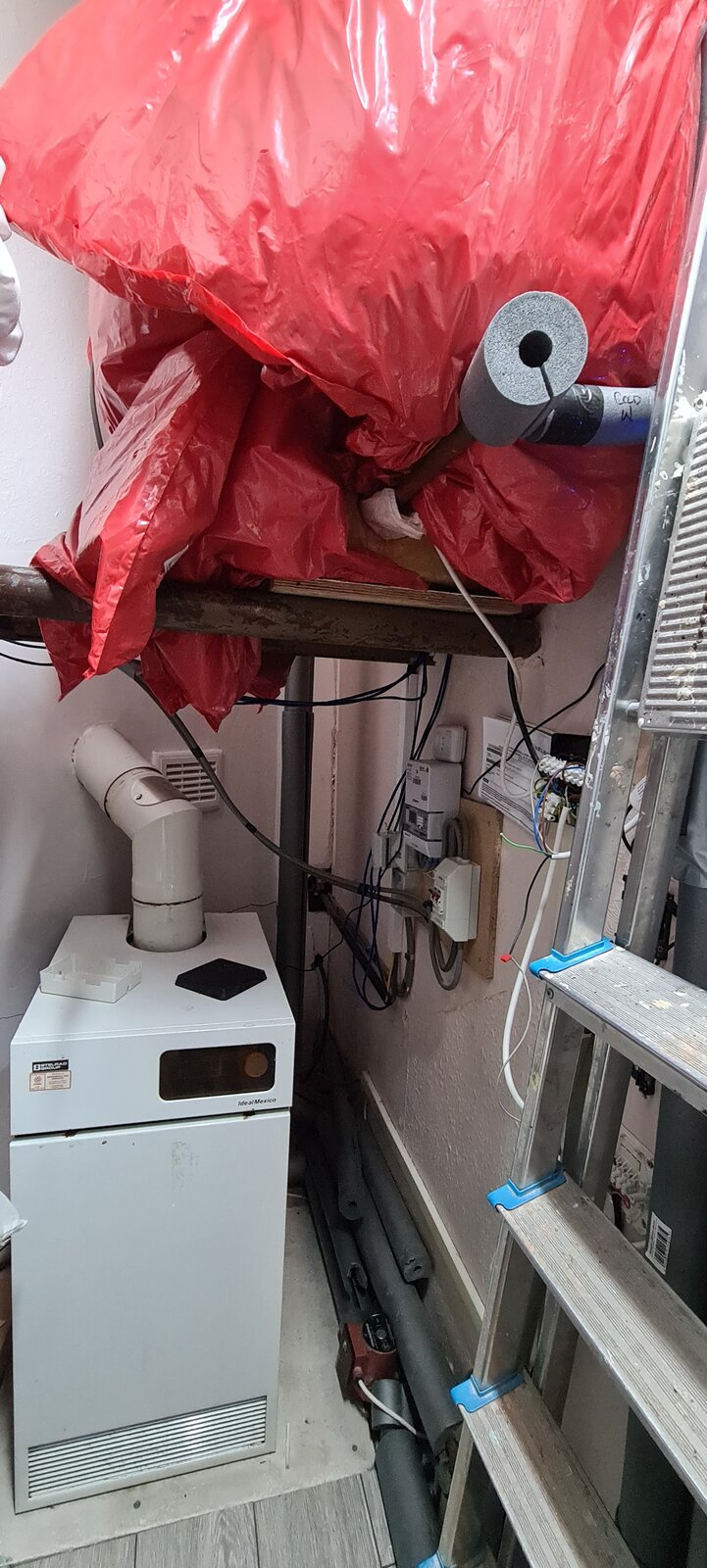

Clear pictures of boiler and it's pipework - pump - all pipework around cylinder if you have 2 separate heating zones you should have a zone valve controlling each one.
You are up late!

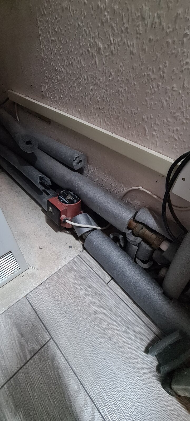

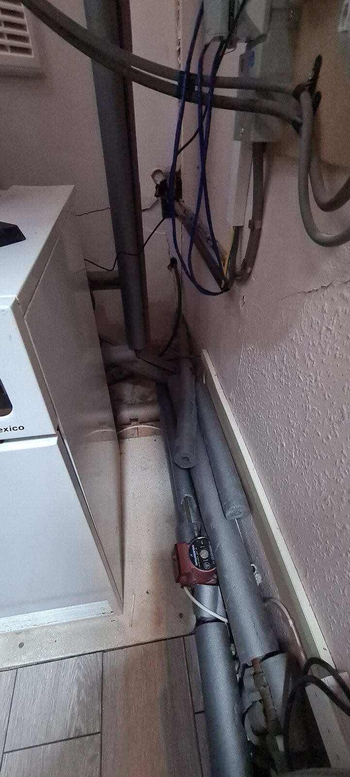

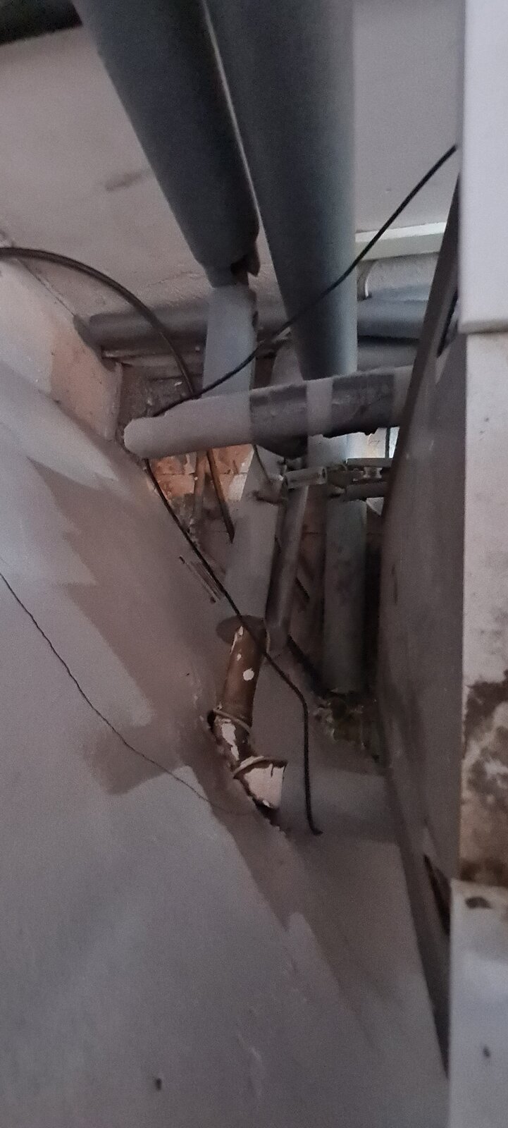

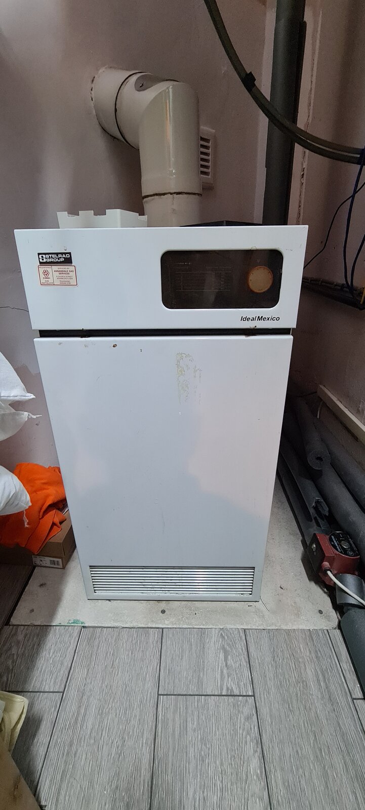

Difficult to get clear pics due to boiler location but please see attached. The pipe work at the rear of the boiler you will hopefully see the 4 water pipes. The water cylinder is above the boiler and the flow and return pipes connect to the cylinder via the 2 port zone valve. This is not pumped.
The other two pipes are CH, pump on the return. There are two zone valves on the CH. One for down and one up stairs.
Many thanks for your continued help. Your C plan schematics were most helpful.
