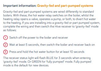

OK, so if I've understood you correctly, it sounds like you may have it set in 'gravity' mode of operation, you require 'fully pumped' mode for a system with a 3-port diverter.
Thanks - I tried switching it in and out of gravity mode but it has this behavior in both normal and gravity modes!
