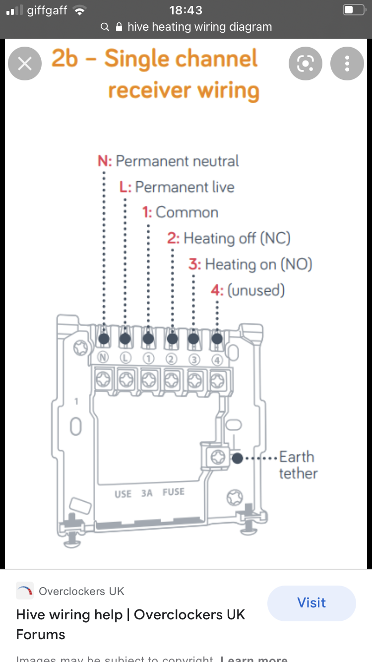

I’m installing a Hive Single receiver to my Glow Worm Extramax Combi boiler and have got to the final stage on wiring up the actual receiver to the boiler. The 240v (L&N) are connected and the system is powered and synced, but I just can’t figure out where the ‘common’ and ‘heating on’ wire go on the boiler panel. This is 1 and 3 on the actual Hive receiver.

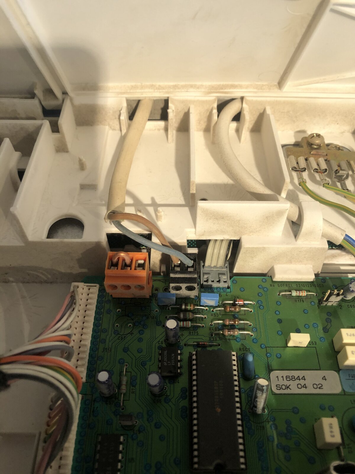

I have attached a photo of the actual board and the connectors and also the section out of the instruction manual.
The one with the link (E) is the ‘voltage free’ and the one next (F) is the current remote thermostat. Having done some further research, is it actually just a case of removing the wires from the current thermostat (F) and replace them with the hive wires. If that’s the case does it matter what way they go into the terminals.

Hello again, looking for a bit more help please. Removed the existing remote thermostat from F on the attached picture and diagram and replaced it with 1 and 3 from the hive receiver, but when I switch on the boiler it’s still showing an error code. Returned the original and all back to normal so I’m clearly doing something wrong. At a complete loss, so any further advice or thoughts greatly appreciated. Thanks all.
On the actual picture that shows the circuit board, there are two wires that goes into the connector block, which is F on the actual instruction manual. Shows as blue and brown wires. Sits next to the connector with the link. That’s the current thermostat. Thanks again.

Thanks. Still not sure so please bear with me. The wires that you see on the picture feed the current remote thermostat. The hive wires I’m connecting are 1 and 3 on the hive receiver. (I.e common and heating on), so not 240v. Can you please advise where I would connect the hive on the circuit board and whether I need to do anything else. Thanks. Really appreciate it. Very frustrating

Bear with me, because hopefully this isn’t the last bit, the 1 and 3 from Hive need to go in place of that link, which is similar to what I posted in post #2. That’s why you got the error code, because Hive isn’t an eBus connection.
Yeah that the frustrating bit. I actually did that to start with but still caused the error code. Would it matter what way the cables went or does it not matter.
Also if I put the cables into the connector where the link is, do I need to do anything with the current thermostat (I.e remove the wires, leave in, remove and add link etc) or just remove all together
