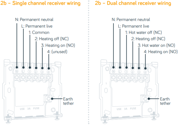

I have a Greenstar 36CDi combi boiler with a Hive (single channel) thermostat. There are two circuits, downstairs & upstairs - the Hive controls downstairs and it works correctly.
We don't use the heating that much upstairs, maybe boost it for 30 mins every now and then.
I presume I could control the upstairs heating circuit using the Hot Water control if I switched my single channel Hive receiver for a dual channel one? It's just a switch after all... Upgrading to multizone Hive seems excessive and unnecessary. Thoughts?

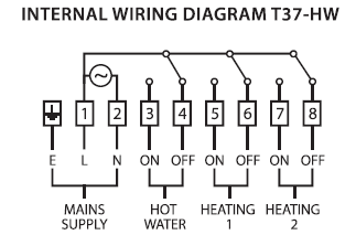

Before I put in a Hive, I had a EPH timer. Wires #1, #2, #5 (downstairs heating channel) and #7 (upstairs heating channel) were the only ones used.
After putting in a Hive Single channel receiver, I had connected EPH #5 to Hive #3. I can now control my downstairs heating with the Hive Thermostat - all good.
What I'm thinking of doing is swapping in a Hive Dual channel receiver and connecting EPH #5 to Hive #4 and EPH #7 to Hive #3.
With this configuration I'm hoping to continue to control the downstairs heating with the Hive thermostat (as I currently am) and to also be able to control upstairs heating by using the "Hot Water" boost function on the Hive (but without thermostatic control...which isn't a problem for the manner in which we heat upstairs in this house). Do you think there's any reason why this wouldn't work ok? Thanks

Agreed that it's a bit hacky but I don't really want to buy another Hive thermostat + receiver when the functionality already exists in the Dual channel version of what I have already.
