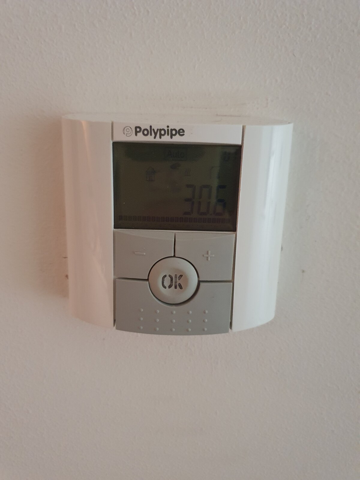

I have polypipe thermostats that operate my ufh but they are not the easiest to use or regulate, how easy would it be to install hive thermostats? Any advice much appreciated cheers
Installing is just wireing, easy enough, but Hive will sense the room temp , your existing might have floor sensors as it is UFH, you need to know what system you have , Hive will control the temp of the air in the room, your existing might control the temp of the floor
I have 3 floors, downstairs is ufh with 4 thermostats for each zone, floors 2 and 3 are radiators with a thermostat for each so I'm guessing I'll need x6 hives which will be pretty expensive are they really that good? Also to I need to check the wires on the back of the existing thermostats to see if hives are compatible? Cheers again

There are x4 of these thermostats downstairs for the ufh zones

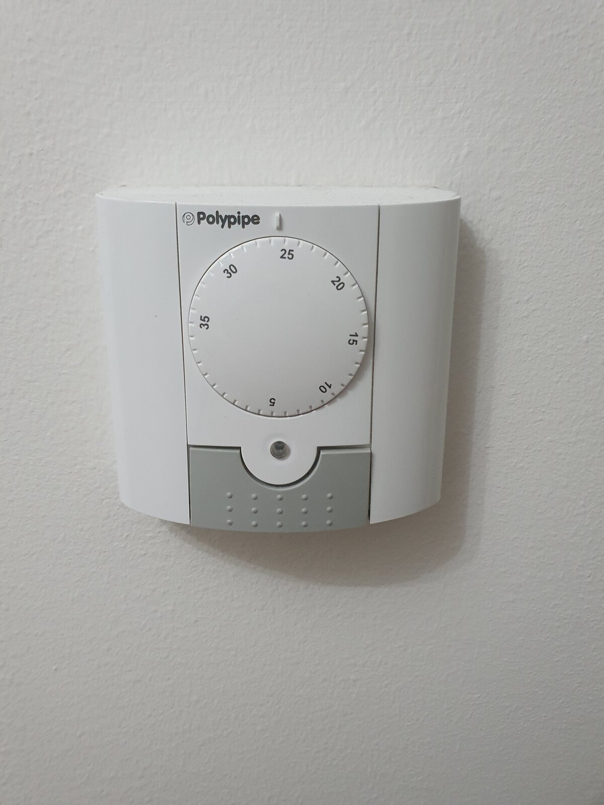

And 1 of these on floor 2 and another on floor 3 for the radiators
I'm not familiar with those Poly Pipe thermostats, maybe someone else is?
Would I still have to change the control panel if I used wired hive thermostats?
So long as the existing stats are mains powered the Hive wired up stats would just replace them, you wouldn't need to change the control panel
