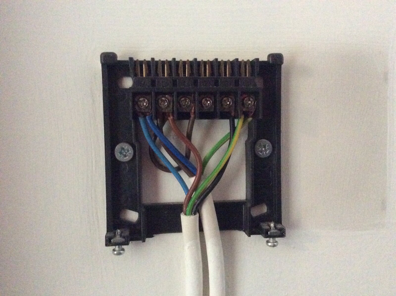

Hi Emit,

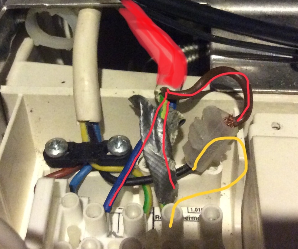

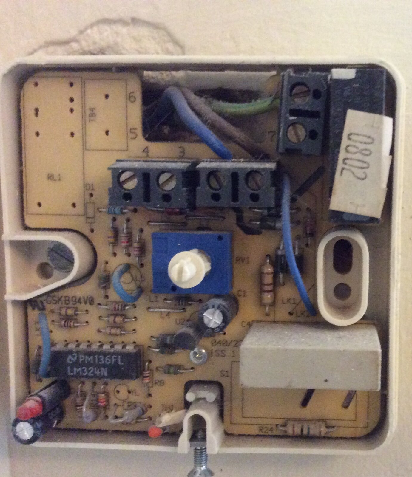

I think the earth wire, (green yellow) is the switched live on the return from the thermostat. This is going to be removed, all those traced in red on the photo are to be disconnected, so the wired thermostat is completely out of the system? See the photo with the red traces
The black wire coming from the sunvic programmer backplate I believe is the central heating on power supply which is being fed to the brown wire, input to the thermostat and the green yellow is the switched live return.
I think the black then under the hive system would be used to call for heat on the ch side?
I may be barking up the wrong tree completely...

I was hoping that it would be simple. I think I caused a red herring with the early part of the thread investigating the thermostat as this is going anyway.

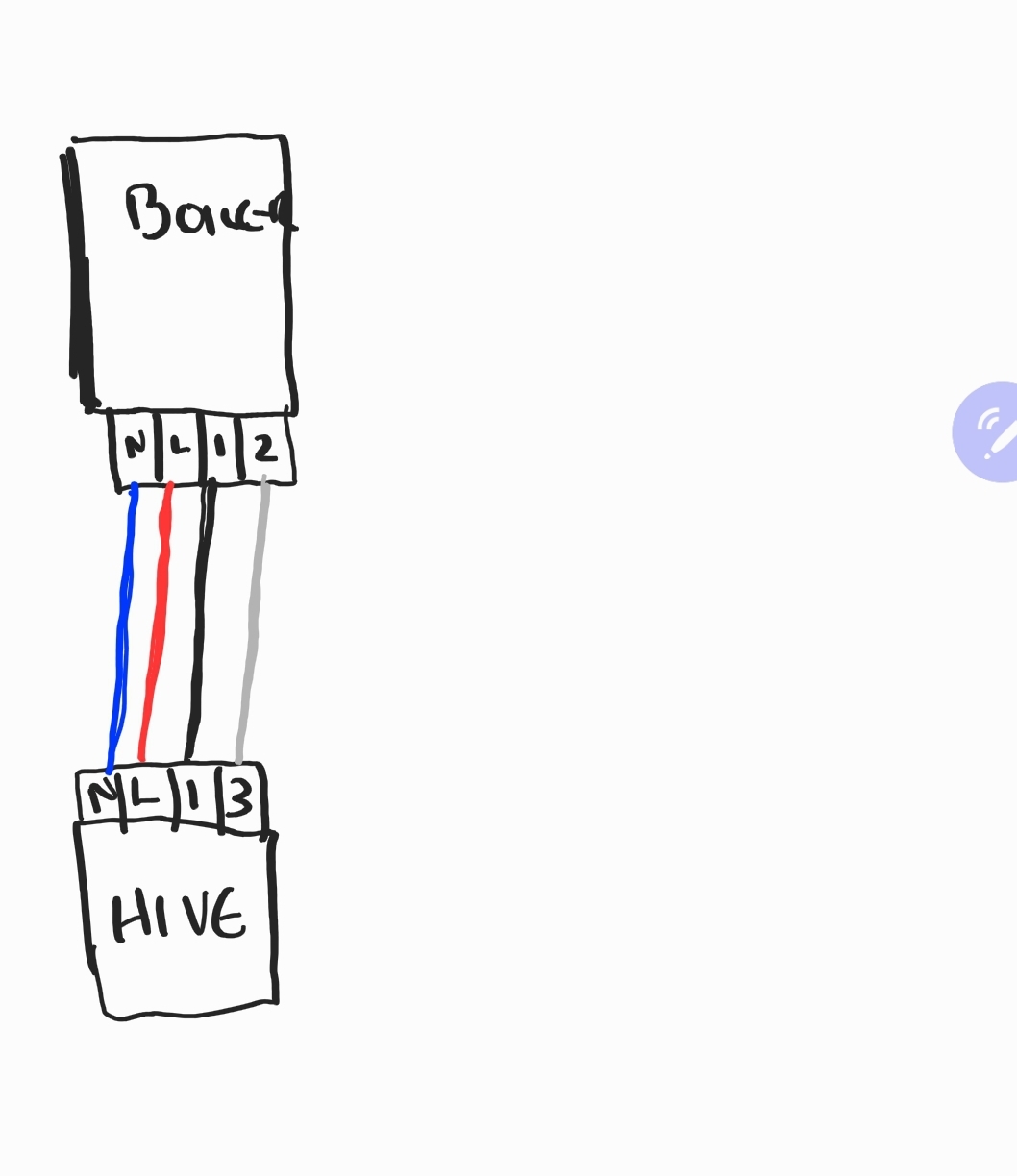

Why are you making everything so complicated ???? just rip the lot out 1&2 from the Alpha to 1&3 on the hive single channel and a L&N to L&N on the hive from the boiler or fused spur simples

So if I went for 5 core cable, L&N&E hive to L&N&E on the boiler, got that.
1 & 2 boiler (thermostat switching) to 1 & 3 Hive plate, does it matter which to which? 1 to 1 and 2 to 3?
One final question I think, the current wiring has a loop from L to 1 (common) on the hive backplate. This is retained or removed?
Very sorry to be a numpty and make it so more complicated by including the thermostat etc. I do appreciate your time and patience.
Bleakers.
Loop wouldn’t be required because one of the ports from boiler will be a live out.
Thanks Chris and I presume it doesn’t matter 1 & 2 boiler to 1 & 3 Hive plate if I end up 1 boiler to 3 Hive plate etc?
Bleakers
Bleakers
either way round for 1&3, doesnt matter it is just a switch and no need for an earth, run it and tether it if you want but it wont be doing anything and isnt required
