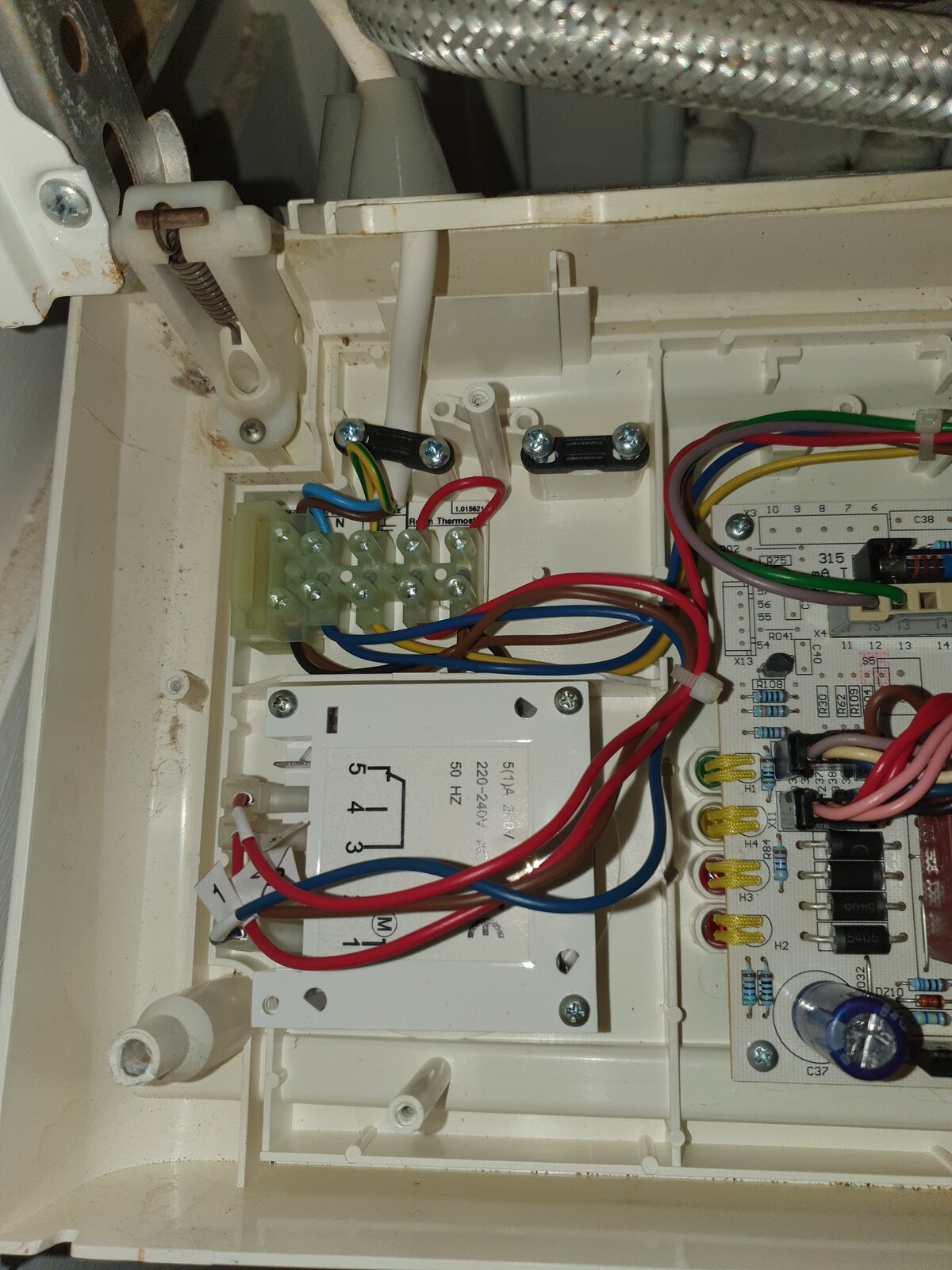

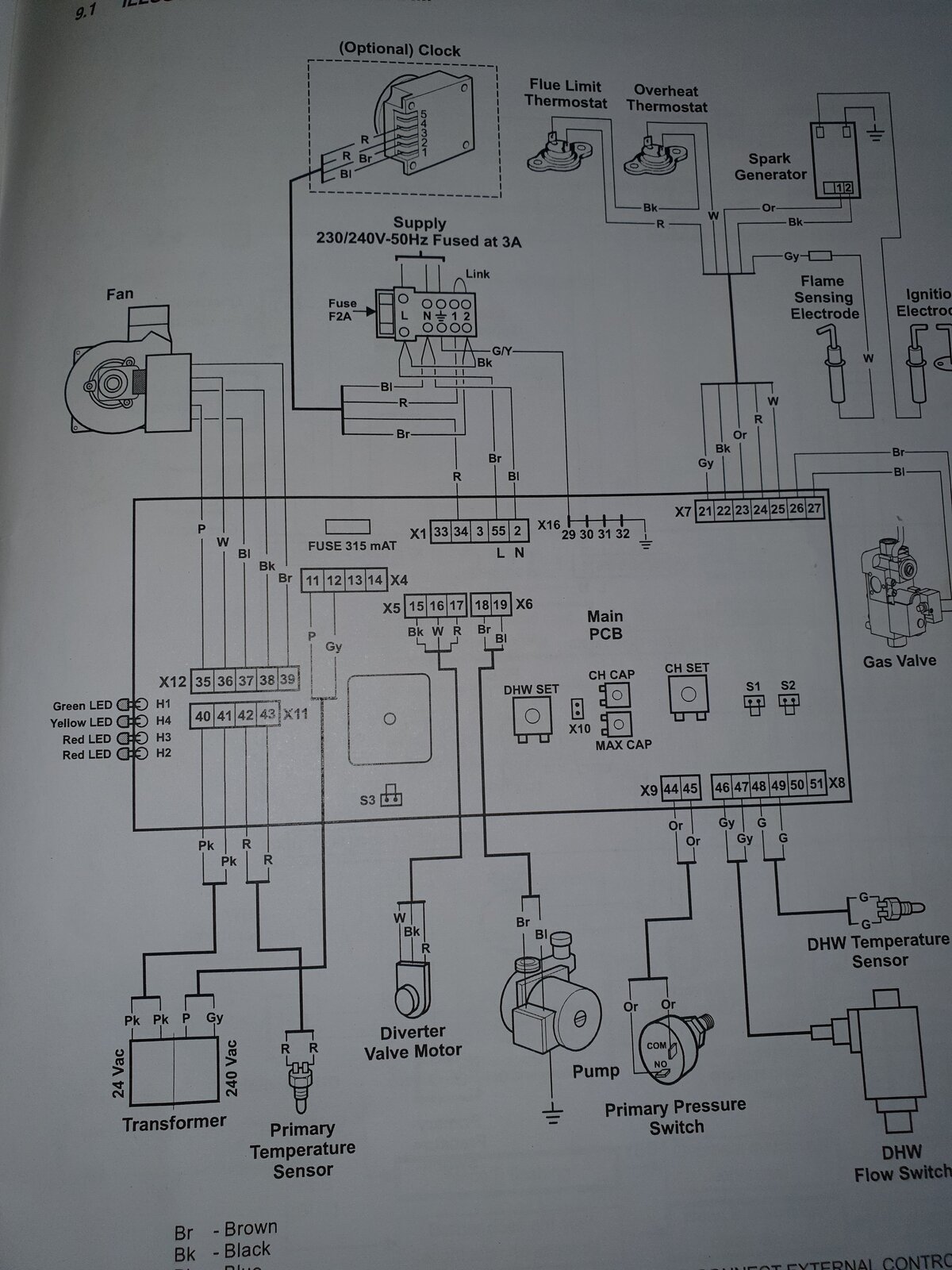

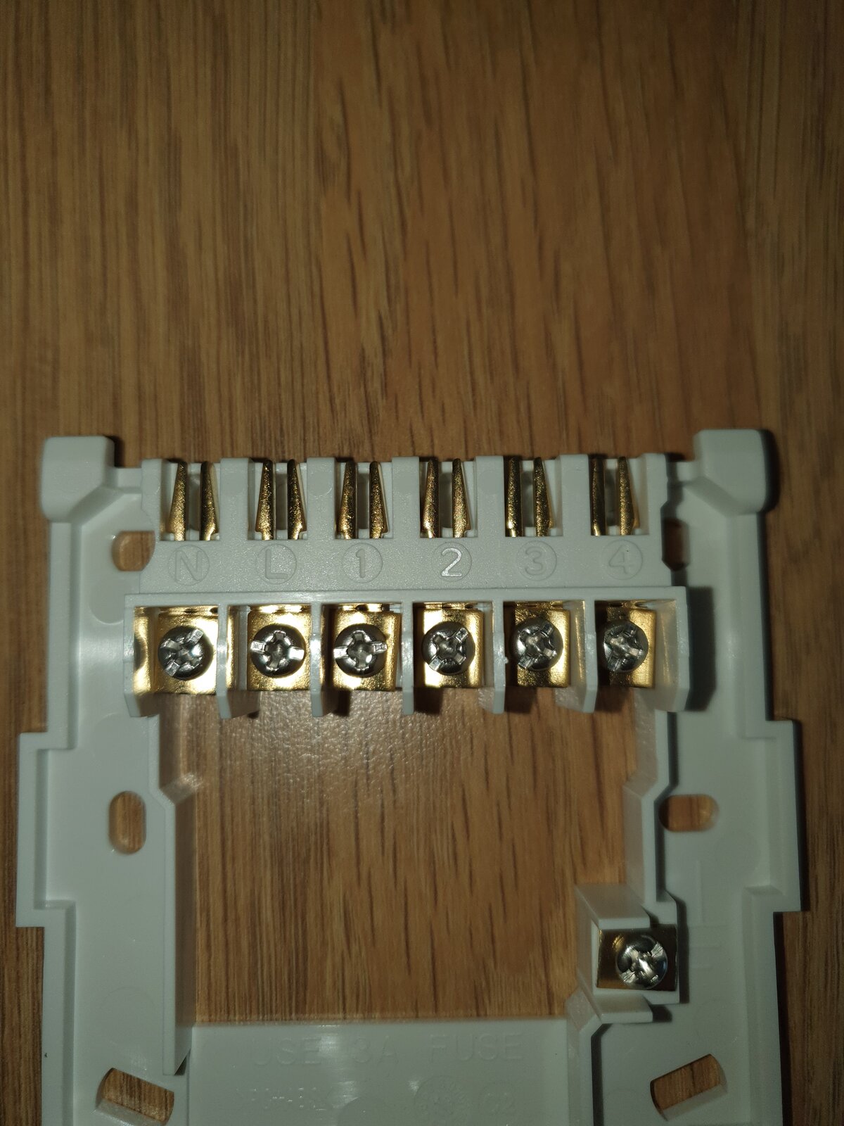

Hi all I'm after some advice. My current alpha boiler has a wireless thermostat connected nothing fancy just one where you can set the on off time for heating etc etc. This has now broken due to me dropping it and the inlaws have give me a hive thermostat that they never had fitted to there boiler. I just wanted to check if I'm going about the right way of wiring it up I've added some pictures and hopefully I'm on the right tracks.
So am I right in thinking i am to remove the wires from current wireless receiver and corresponding wires from the 230/240 supply block then
Remove link then wire as follows
boiler 1 goes to hive 1
boiler 2 goes to hive 3
boiler L goes to hive L
boiler N goes to hive N
boiler E goes go hive E
Does number 34 on terminal x1 then go to number 1 on boiler? ( currently on number 3 on wireless thermostat)
Hopefully I'm on the right lines but then again I could be miles off
Many thanks
Dave

easiest way to do it, from the internal time clock pull off the 4 wires,
brown to L on hive
Blue to N on Hive
two red wires to 1 & 3 on hive, doesnt matter which way around
Thats it no earth, dont make any other links dont touch any other wires, clock wont work anymore as hive now controls the boiler
