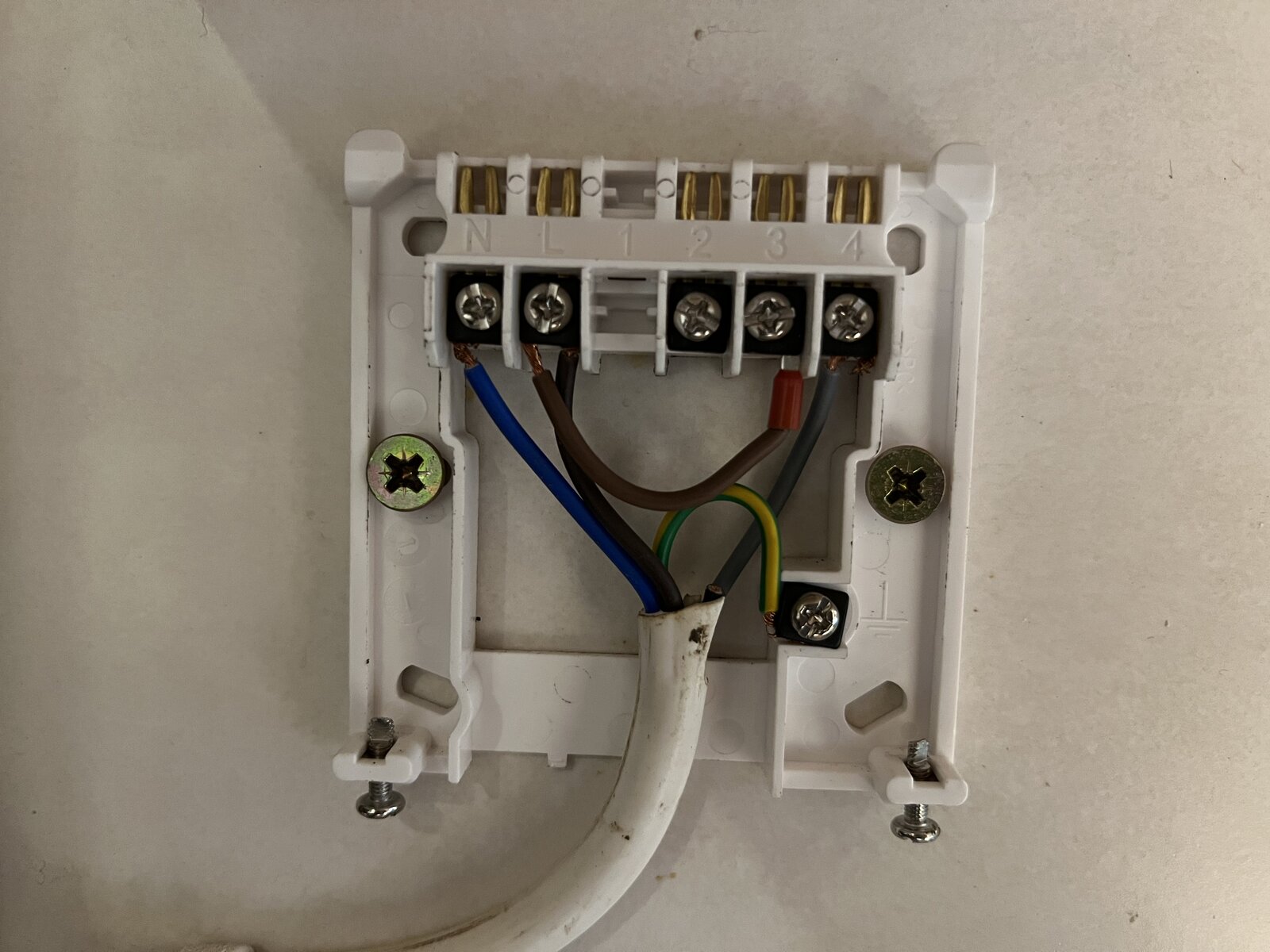

Just wanted to confirm I have the wiring correct changing over from current system to hive
Current system is wired up as
Live and Neutral as expected
There is then a small brown wire going between the live and common ports
Then single grey wire into port 4 which is labelled as Call for heat.
So for hive I would have
Live & Neutral the same as above
Along with also using the small brown wire to bridge the live and common ports
Then instead of port 4 on the current system the grey wire would go in port 3 on hive for Heating on
That's the idea. It's what the terminal does, not it's number which is important, so "Call for Heat" does indeed equate to "Heating On"

yeah it’s a Worcester greenstar with a Neomitis receiver already connected which has a wireless thermostat in the hallway.here’s a photo of the current wiring.
OK that's fine from a wiring point of view for a single channel version of the Hive
The only thermostat I've seen connected to a Neomitis was just a basic thermostat providing just temperature control [without time control] so not a programmable thermostat
If your existing thermostat is a programmable type [ie one that provides both time and temperature control in the same unit] and there isn't any on/off time control anywhere else then you're good to go.

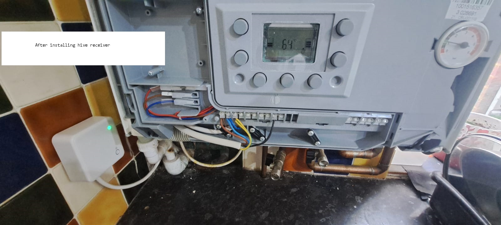

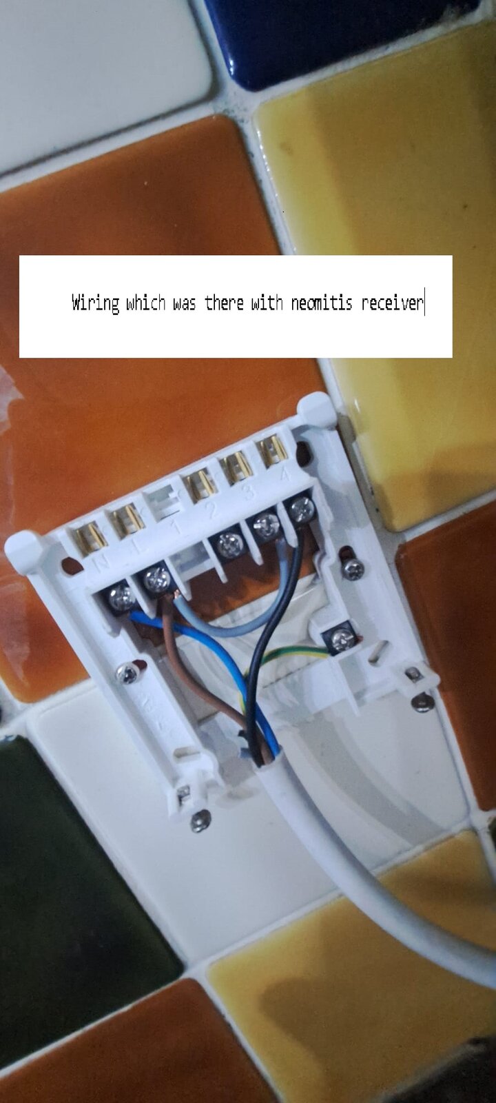

Dear SiG01, I have a similar situation, trying to upgrade from a neomitis controlled to hive3, i managed to connect the hive receiver and when i manually triggered the heating the receiver detected it but didn't fire up the boiler. I think i am missing a wiring. So i put back the neomitis controllerto as it was. Please can you advise. It's an alpha combi etec 28kw boiler.
Also, When installing the hive i removed the grey wire from point connectors 2 &4.

You’ve hijacked a thread (against forums rules and causes confusion) which is nigh on 3 years old, with a different boiler, only similarly with a Neomitis. You need to put the link wire back in. Also, you may need to check the boiler for safety afterwards, it might form part of the combustion circuit.
