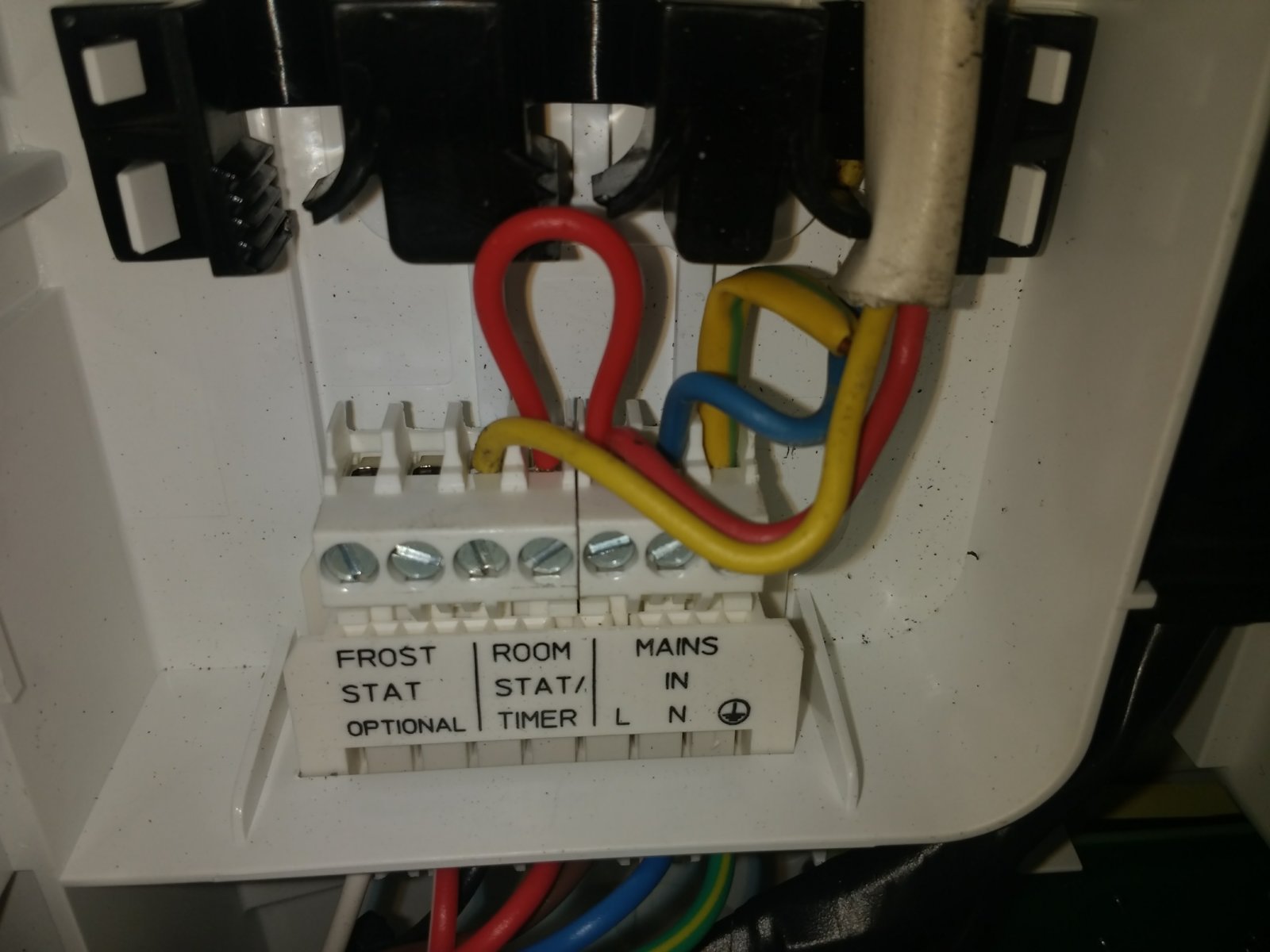

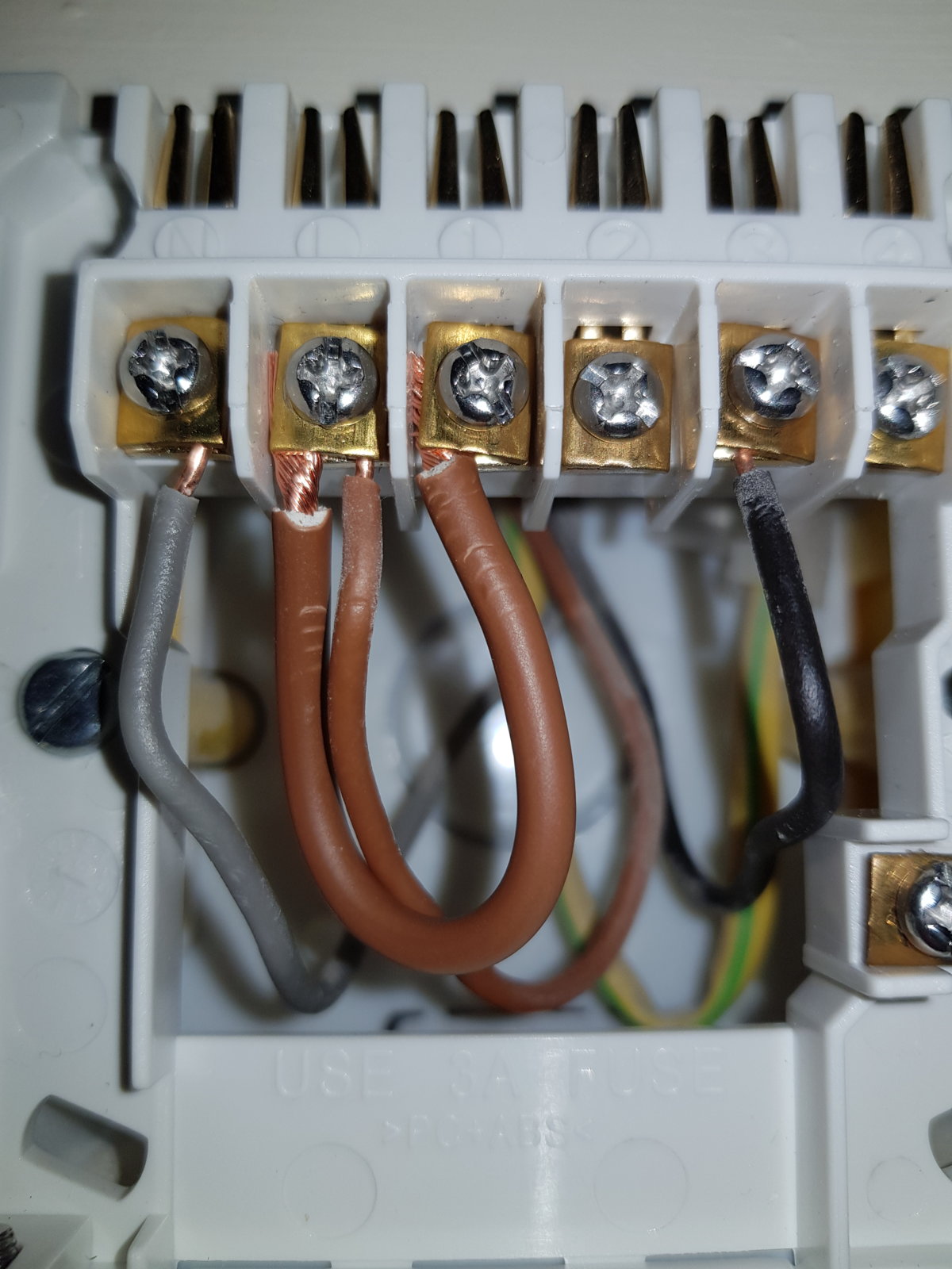

Hi guys, please can you offer me some advice. Purchased the Hive single channel with the idea in mind of a "simple" swap with my current timer.
After looking at the installation manual it looks like I may need a rewire from the boiler as I'm missing the common. Does that look about right to you? I like to know what I'm talking about calling up a sparky. Cheers

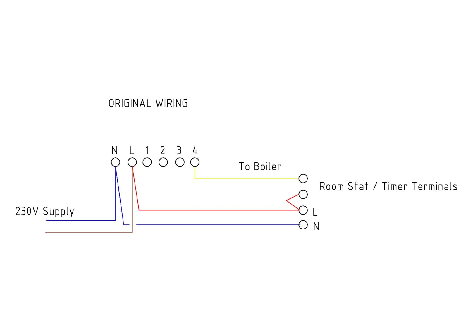

Your system is slightly unusual in that the 230V mains comes into the thermostat rather than the boiler. It's not a problem just different to most. Based on your photos, this is how I see your installation now. If this is not correct, post back what you do have.

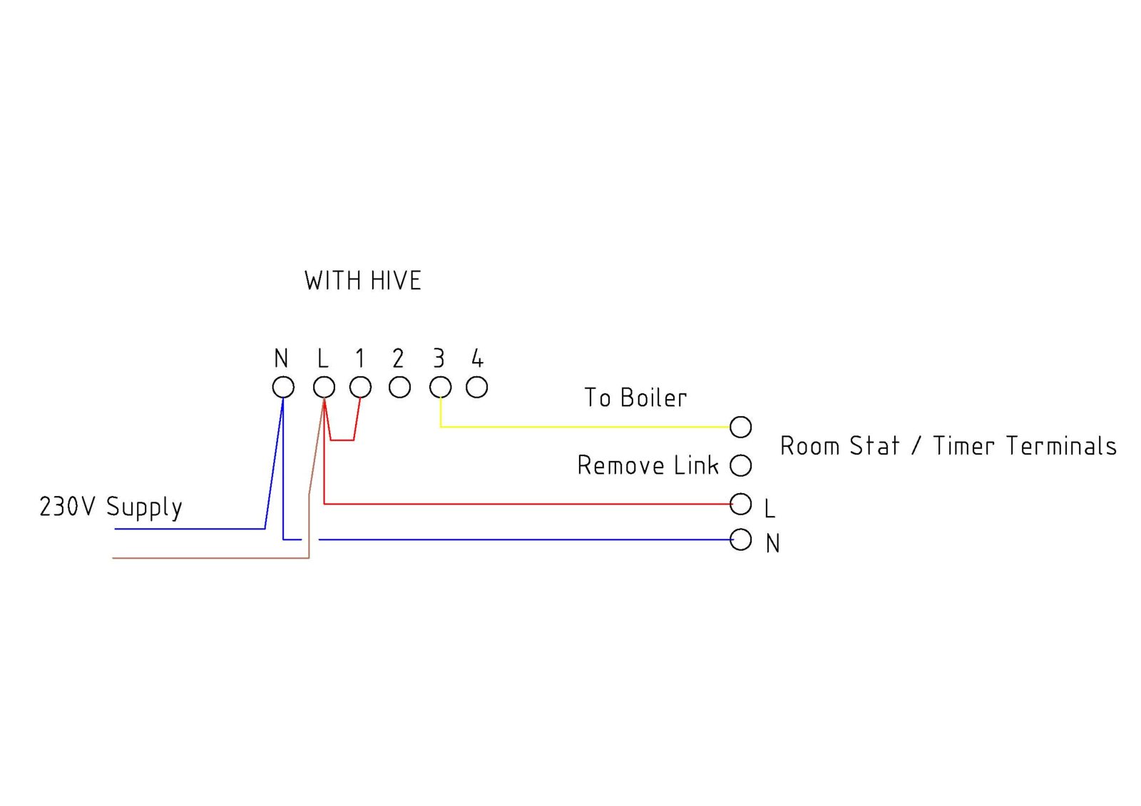

If the above is correct then the existing wiring is OK for the single channel Hive and would be installed as below:
Note the subtle shift of the yellow wire to terminal 3 (Heating On) at the Hive
The red link at the boiler end is not necessary so you can remove it (you don't need it now BTW, but it isn't doing anything) leave the other wires exactly as they are.
A link is required at the Hive between L & 1

Hi stem, thanks for your detailed response. Yes you're correct with your first diagram, the wiring into the thermostat/timer is where the boiler is spurred, it looks a bit dodgy tbh, have you seen that before? We have no other thermostat so we're all good there.
So basically remove link in boiler, for Hive make link between L & 1 and shift yellow from 4 to 3.
Yep, that's it.
It's not good wiring, but I've seen worse. Anyway, it can easily be tidied up when the Hive is installed. The copper conductors should be under the terminals and not exposed, and the bare earth wire needs some earth sleeving sliding on it. The main 230V supply should come from a switched supply via a 3A fuse. (which it probably does already)
Also, the incoming mains cable at the bottom doesn't seem to be secured at all, so the Live wiring terminal seems to be taking the strain. The cable sheath should really be fixed under a cable clamp, or at least in trunking or clipped to to wall to support it.

In my sketch I have shown three live wires in terminal (L) and only one live wire in terminal (1)
It will be easier to put the link between them, and then one of the other live wires in each. Electrically it achieves the same, but fitting two wires in each terminal will be easier than trying to cram three wires into one terminal.

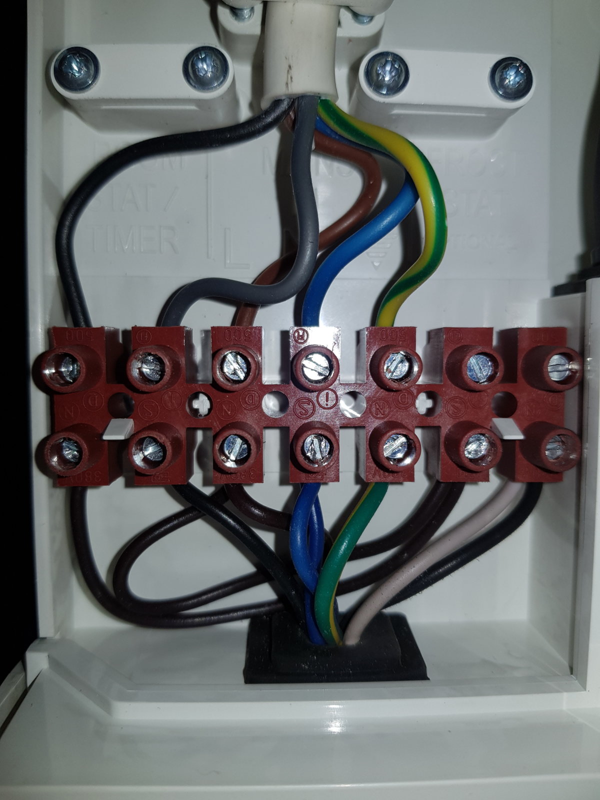

Wired receiver up how you advised but when i turned power back on I don't seem to be getting any power to the reciver as no lights come on..
I do have a timer built into boiler but I have set to constant on as advised.
Thanks again for any further info
They seem to go to the right places. You do have the single channel version of the Hive for combi boilers don't you?
And it was working OK before you started
And the wires aren't loose in the terminals
If the above is OK then check where the wires go at the other end of the thermostat cable.

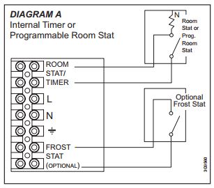

Based on the diagram below from the logic 30 boiler manual
The Live Brown wire should go to L
The Neutral Grey wire should go to N
The black wire should go the the very end terminal of the terminal strip marked room stat / timer.
It is possible that the original thermostat was originally incorrectly installed and the Brown and Black wires are transposed. It would have worked but not as well as it should.
If that doesn't work, an alternative method of installation would be:
Wire the L, N & E of the boiler to L, N & E of the Hive.
Connect wires to the two boiler terminals marked room stat / timer. Connect one of them to terminal (1) common and the other to terminal (3) heating on. It doesn't matter which way around this time.
No links would be required in this instance, but you will need an additional wire.
