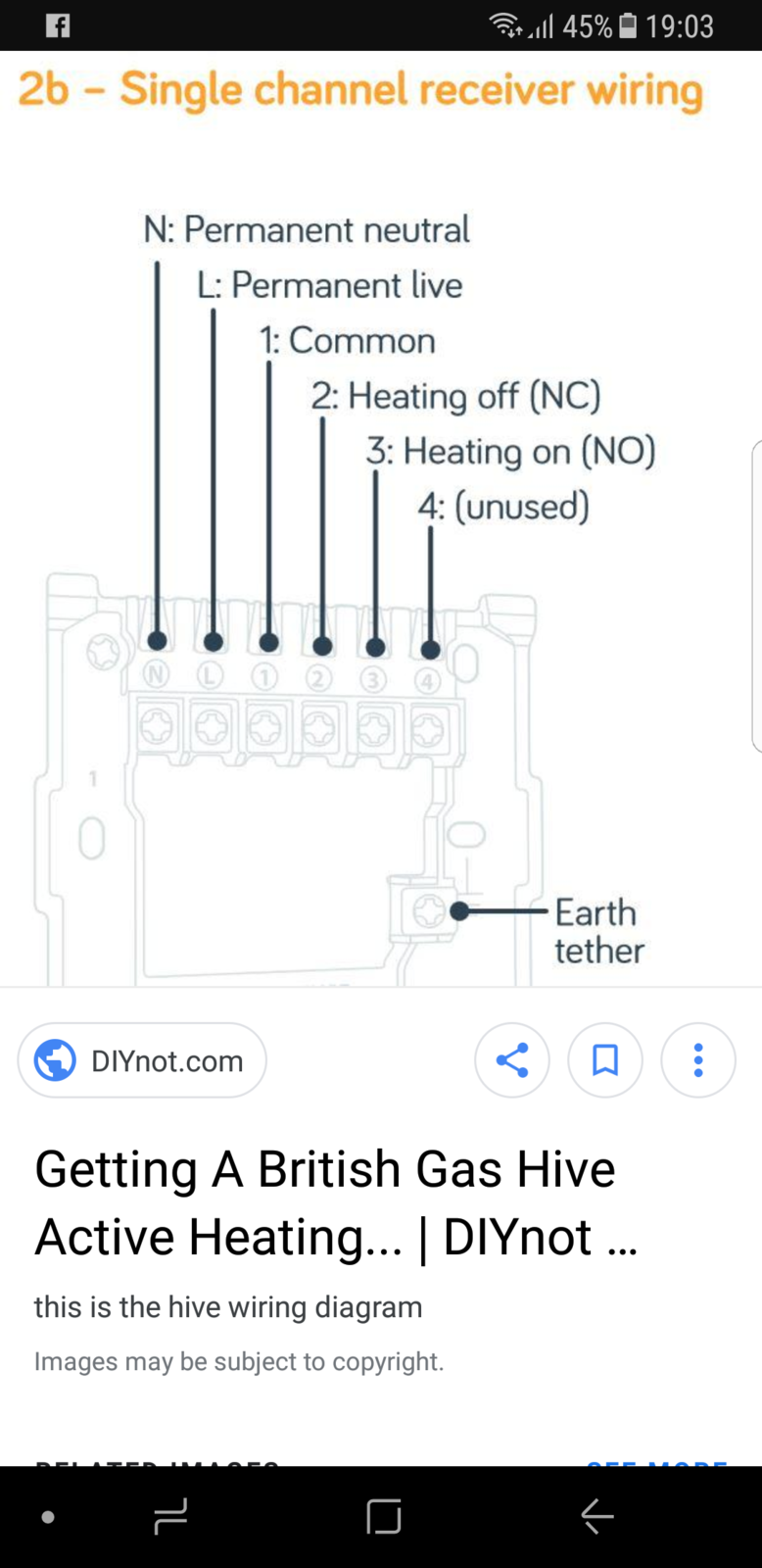

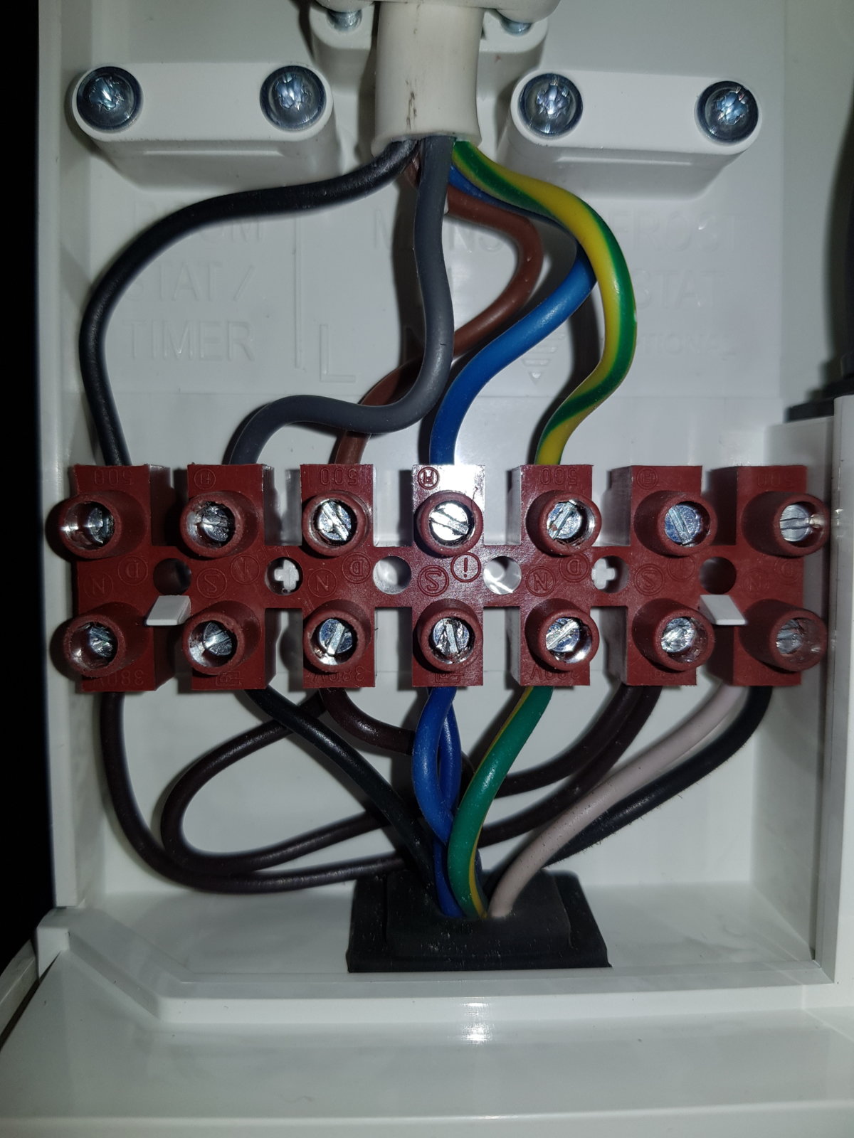

Hi mate you open up your boiler there is a L N and E supply going to it so u run a wire from each Into the matching connectors on hive control box. I then disconnected pre existing thermostat from the connector block marked room stat. These were a black and grey cable. I then ran a cable from the the 2 parts marked room stat to the hive box one goes to the common and one to the heating on. Hope this helps
so you installed the hive receiver with backplate at the boiler and NOT at the thermostat?
Sorry mate not sure how to send images in private chat. You take one wire to the common and one wire to the heating on connector on hive box. First pic shows remove the the black and grey wire and run your wires from there to hive box. Second pic shows what terminals on hive box to use

Yeah mate my hive receiver box is just on wall beside boiler and I blanked off old thermostat which was in my hallway. Hive thermostat is wireless so is not currently mounted anywhere

The existing two wires at the thermostat would connect to the Hive as follows: The wire in Live to Hive terminal (1) 'common' and the wire in Y1 to Hive terminal (3) 'heating on'
Then you need to run a new 230V supply to the Hive L & N to power it. This should come from the same fused spur that supplies the boiler.
If you have any existing time control elsewhere, then you will need to set it to be permanently 'on' otherwise it will override the Hive. If your previous thermostat also provided time control and you don't have a separate timeswitch you can ignore this.
If you have any existing time control elsewhere, then you will need to set it to be permanently 'on' otherwise it will override the Hive. If your previous thermostat also provided time control you can ignore this.
