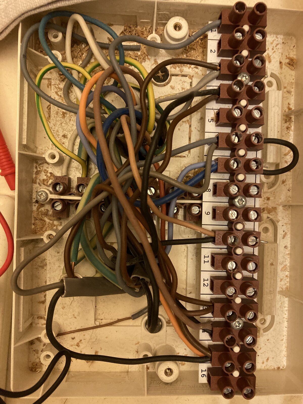

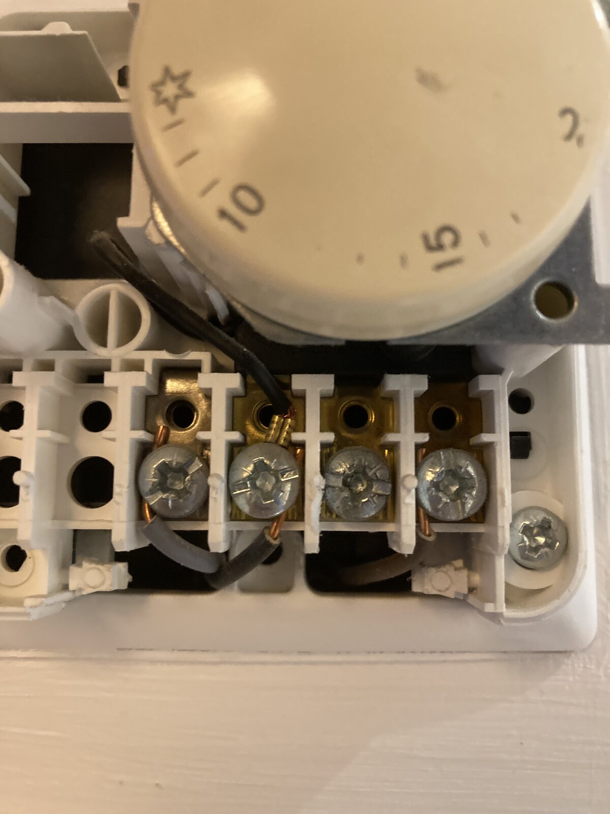

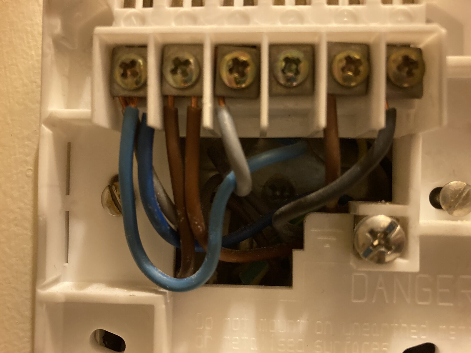

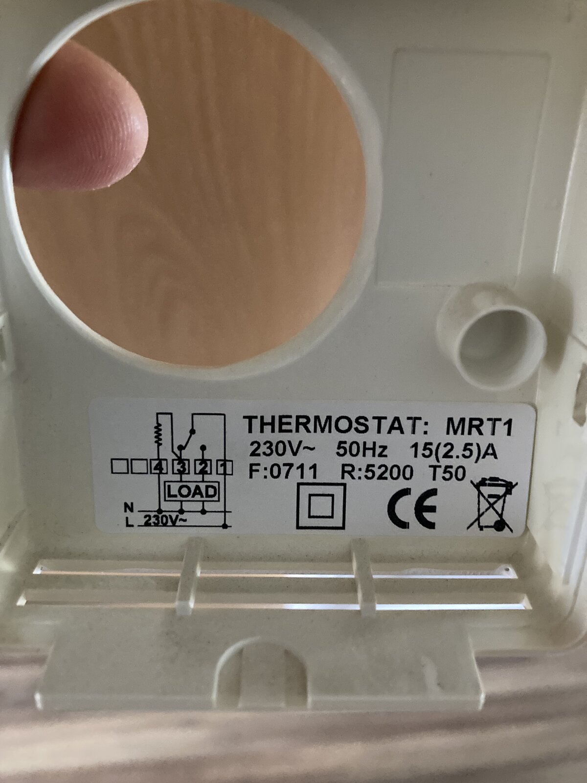

I try to install a hive dual channel receiver but boiler doesn't work. (I have Hot water and heating system)
Looking at the room thermostat, there are three lines. There are brown (L) black and(N?) gray lines(N?). I removed all these lines from the thermostat. Then I opened the wirling center and found these lines. And I pulled out all the brown (L), black, and gray lines. And I jumped where the Brown (L) line and the black line were located. But the boiler doesn't turn on at all.
Found three lines and removed them. Please advise which of these three should be connected to each other.

I would say black and brown, trace at wiring center and place in with white for heating on and let Hive do the rest
