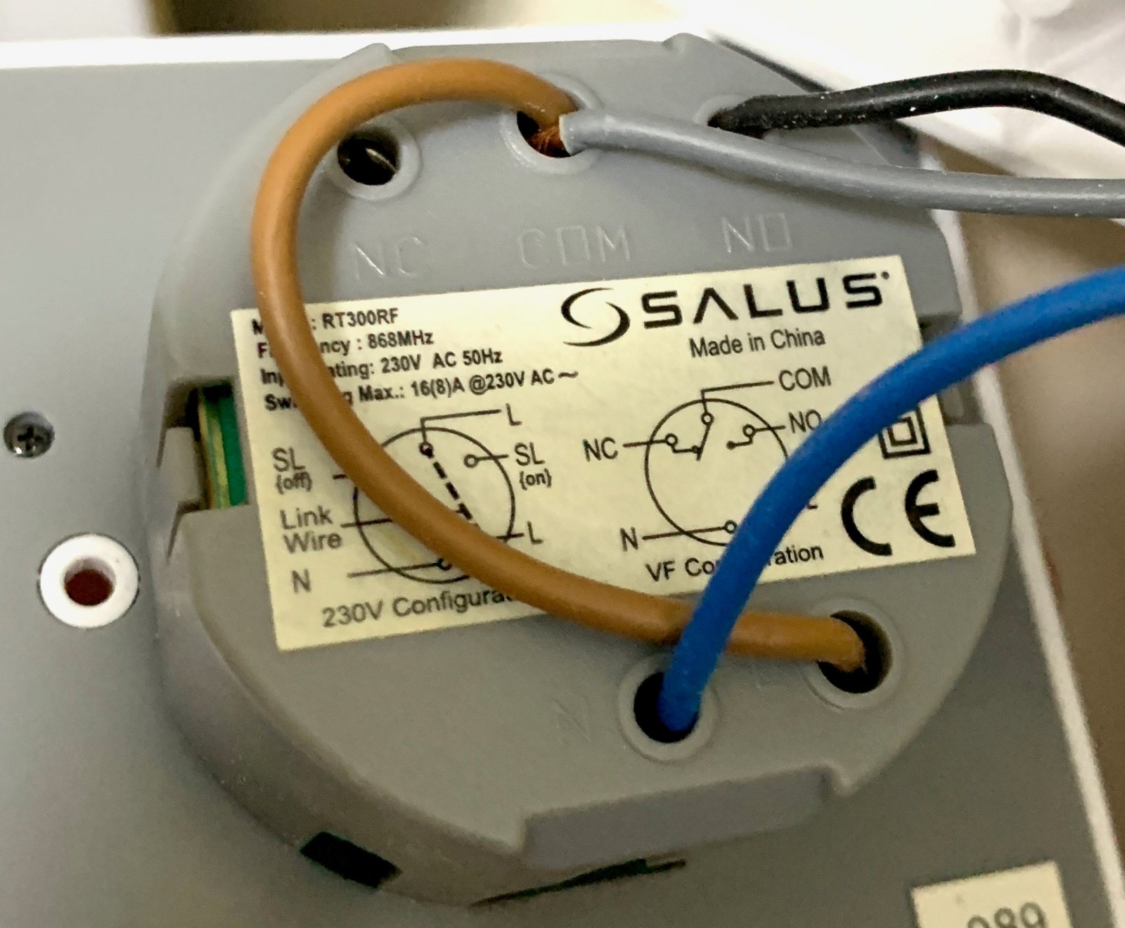

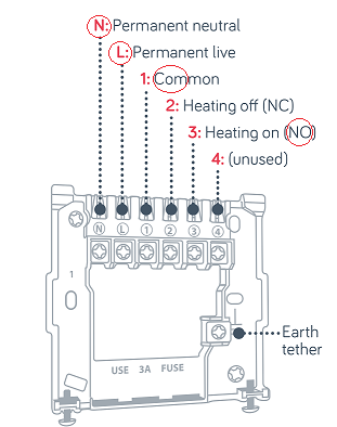

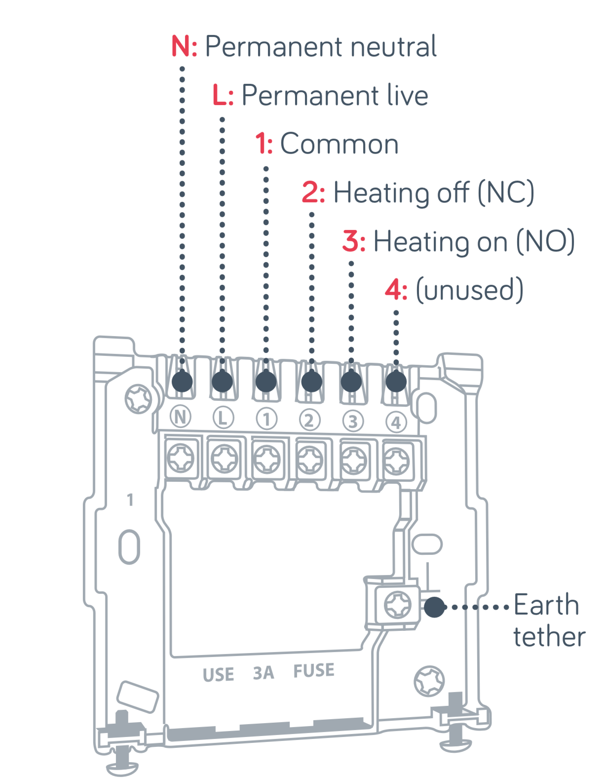

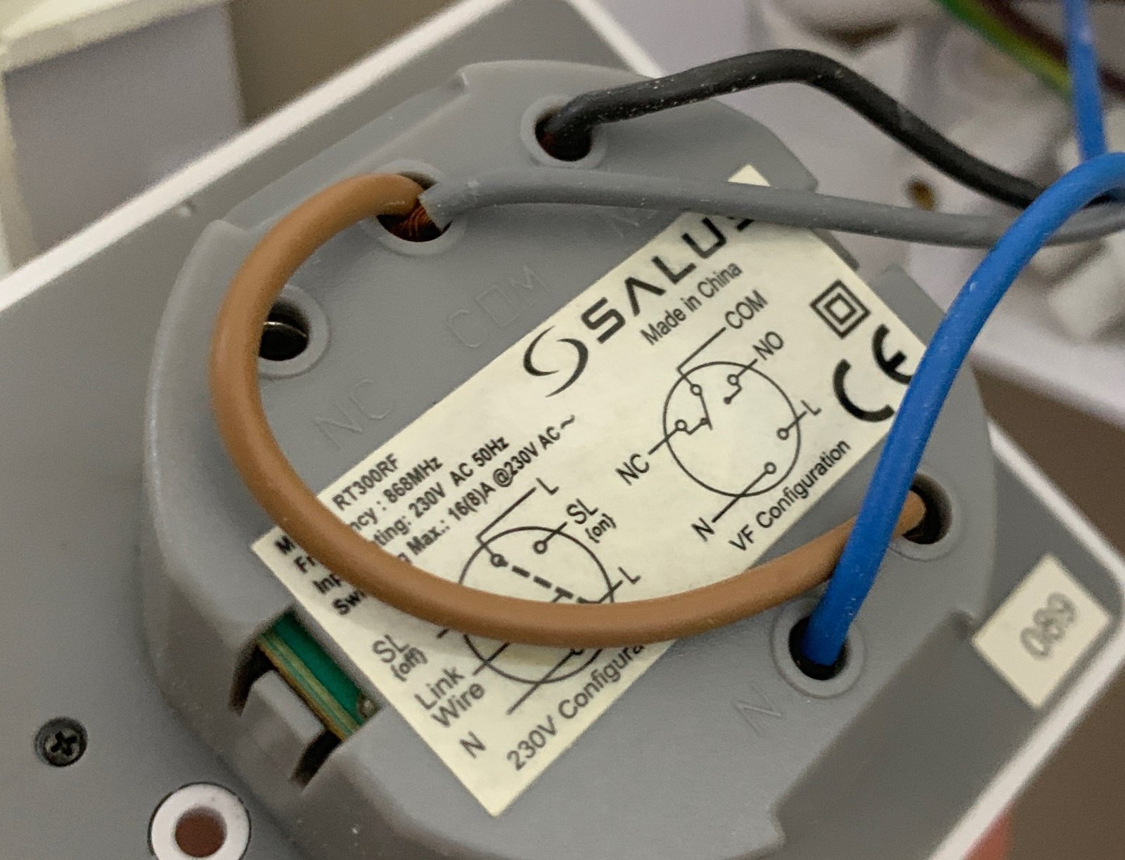

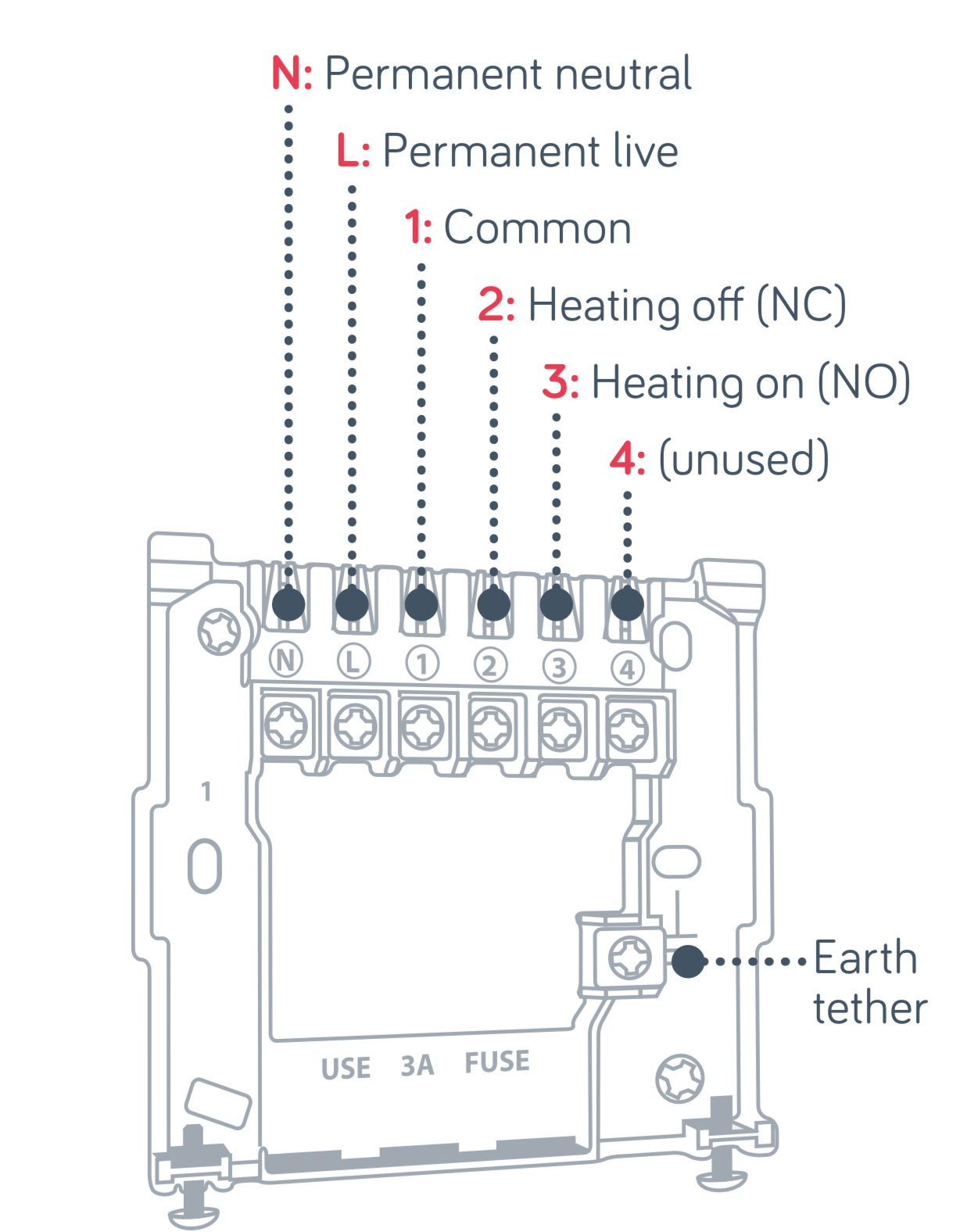

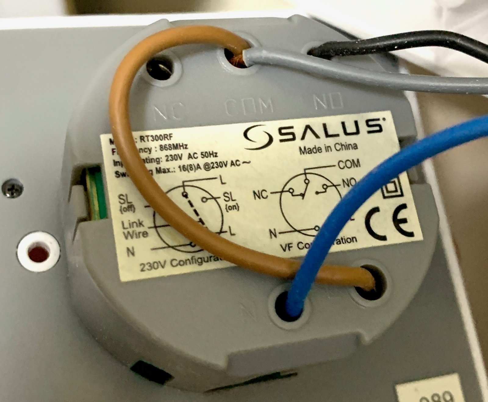

Evening all

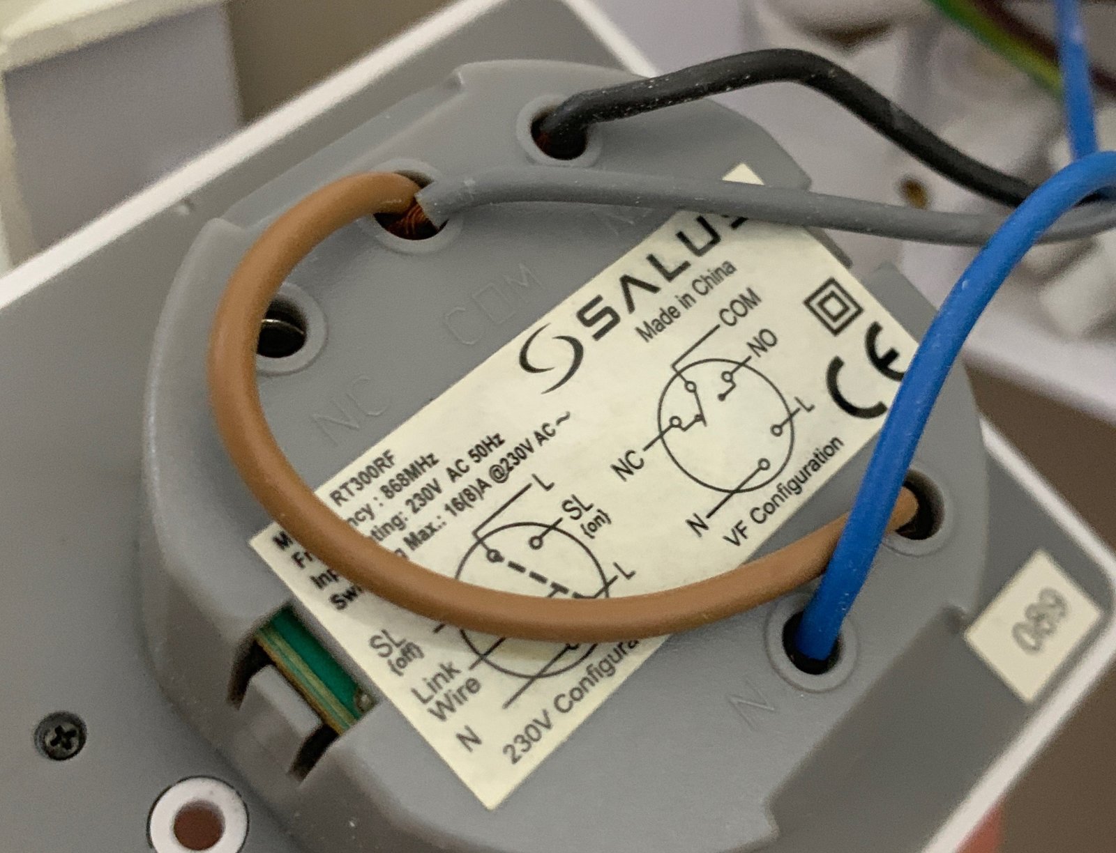

I have the Hive thermostat on order and should be here tomorrow.
I currently have a Salus RT300RF wireless thermostat which i will be replacing.
The boiler is a viessmann vitopend 100 combi
The current wiring on the Salus receiver is:-
COM - Grey wire and brown loop
NO - Black wire
N - Blue wire
L - Brown loop from COM
Am i correct in thinking the wiring on the Hive single channel receiver will be as follows:-
N = Blue wire
L = Brown loop
1 = Grey wire and brown loop
3 = Black wire
any help and info will be much appreciated.
Thanks in advance.
