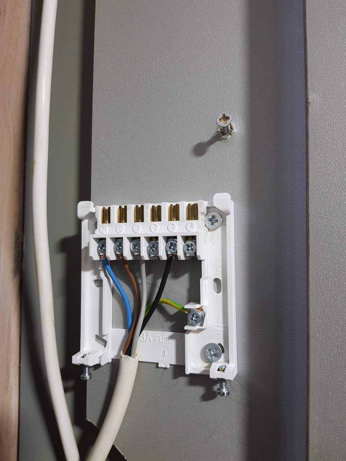

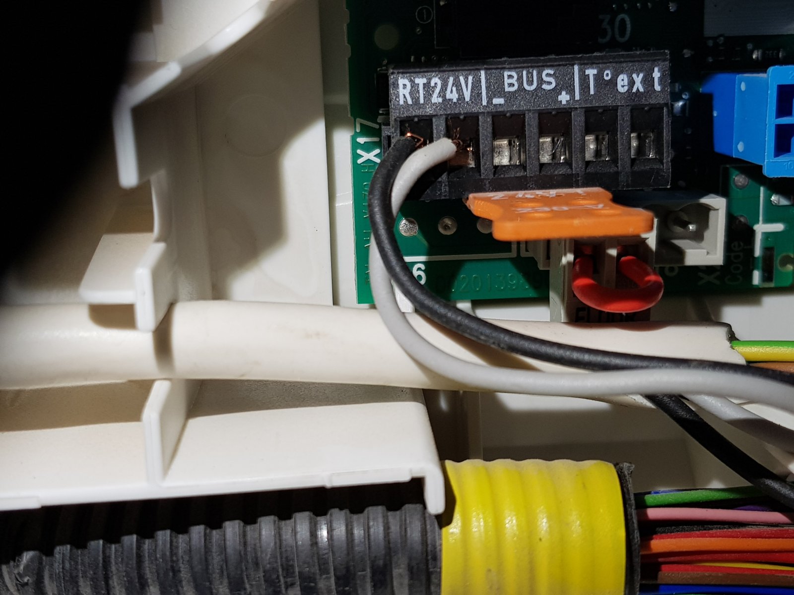

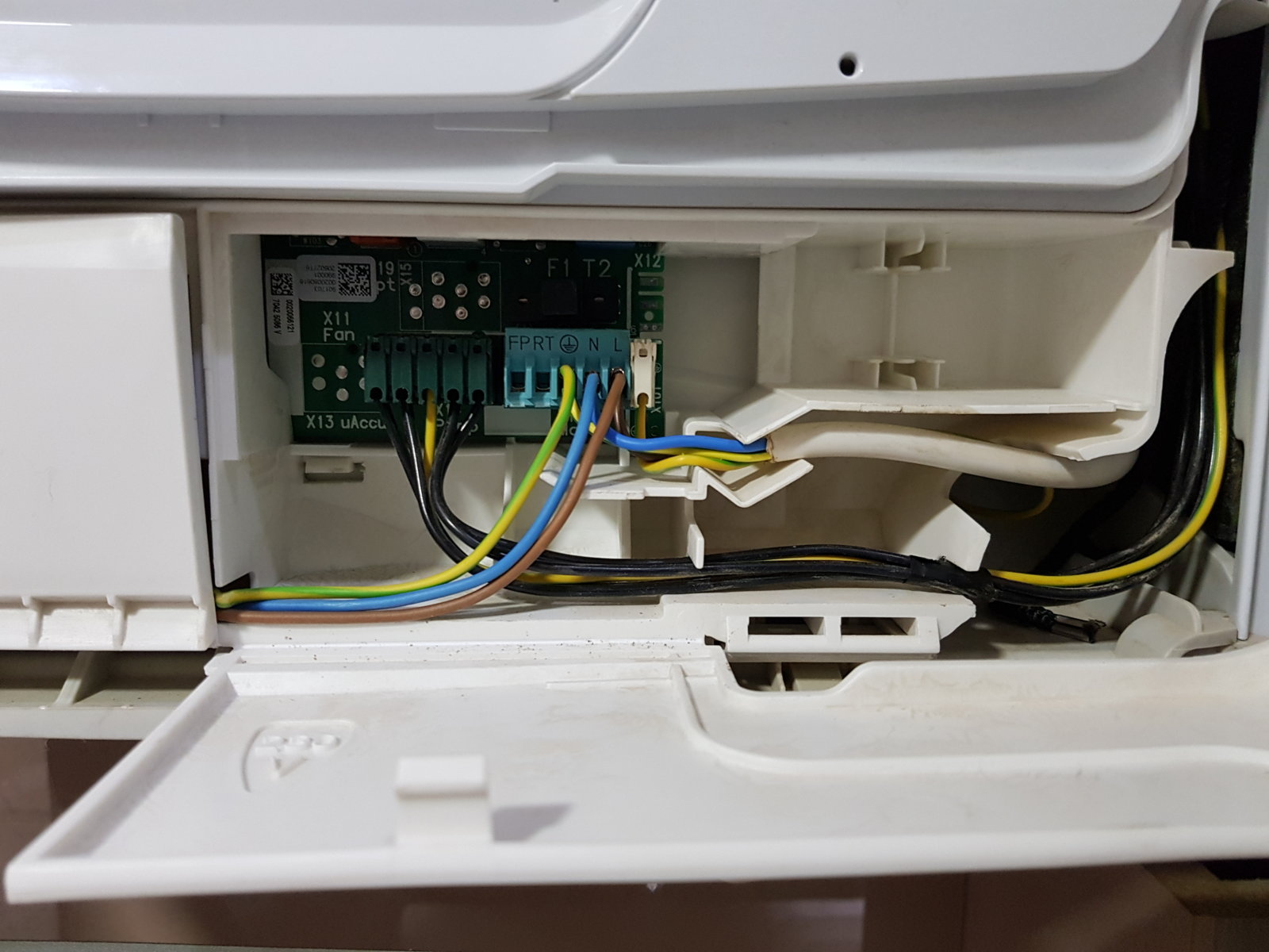

Hi there recently buy hive active heating kit, in my house Drayton digistate scr wireless reciver running i want to replace hive reciver current wireing is Blue N. Brown L. Gray 1. Black 3 i Need your help attached picture

So long as you have got the single channel Hive the receiver will just fit on the same back plate as the scr.
If you have got the dual channel one DO NOT fit it or you will blow the pcb on your boiler the way it has been wired.
