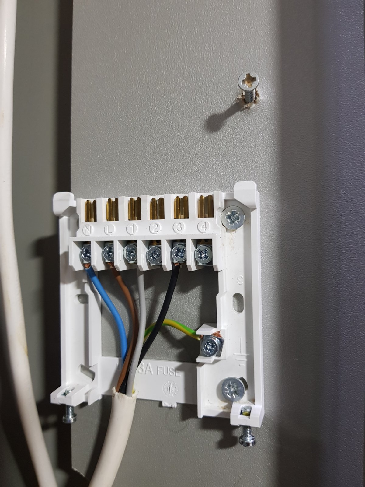

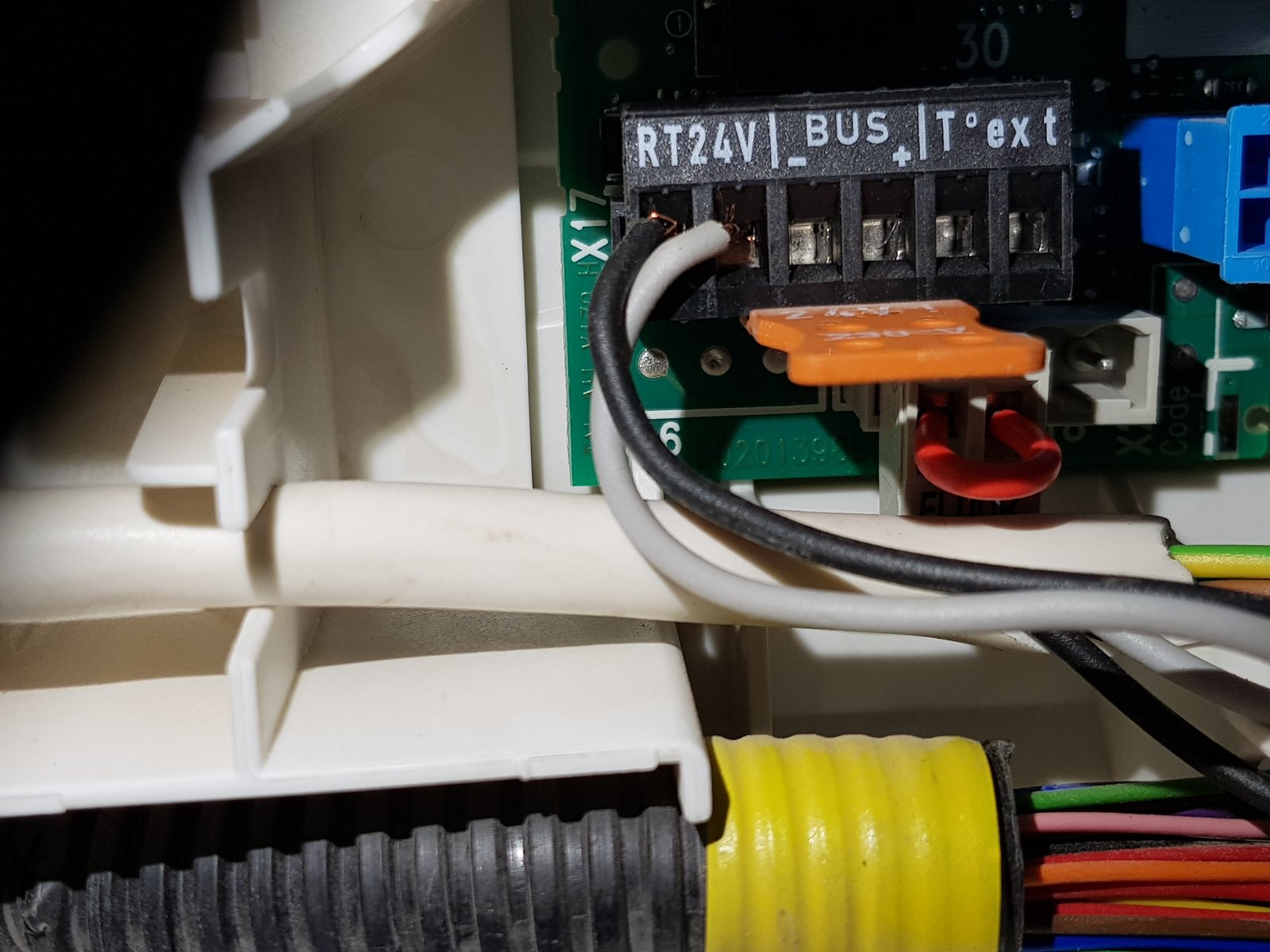

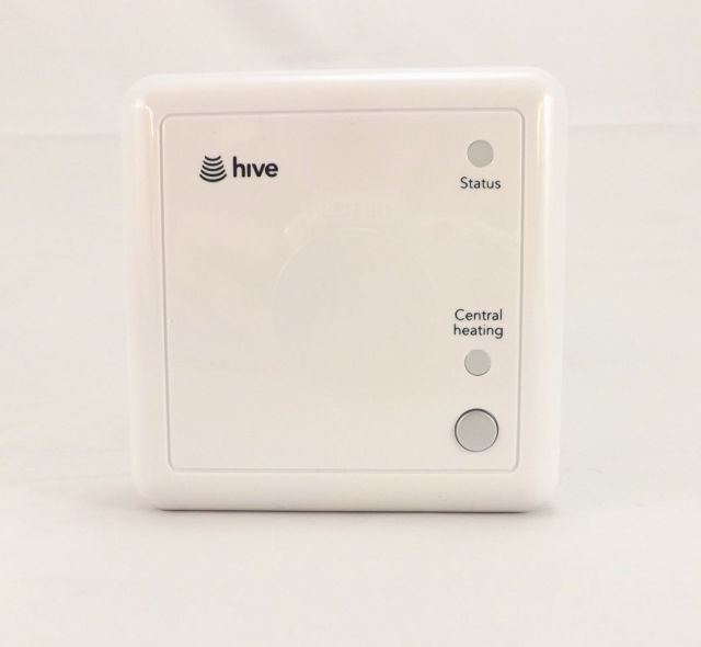

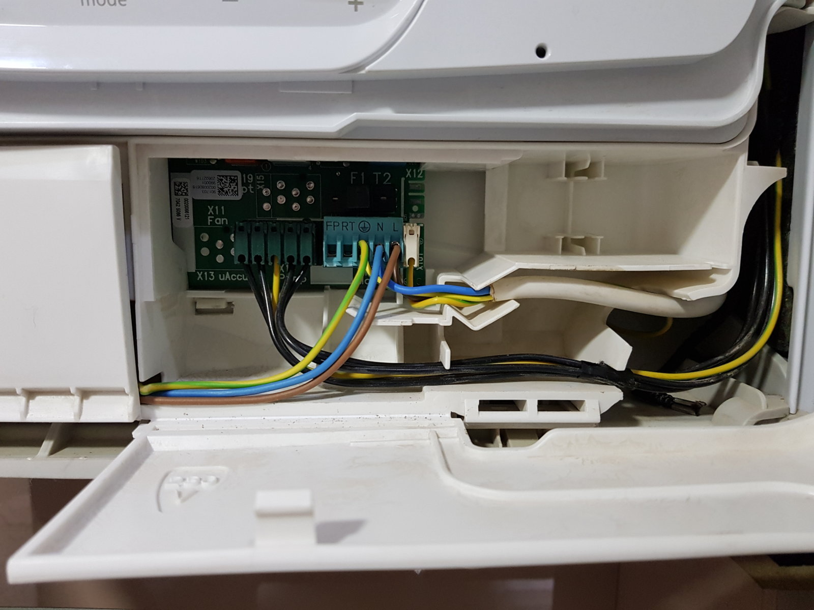

Hello there I need your help I hv Drayton digistate SCR wireless system i want to replace with hive reciver

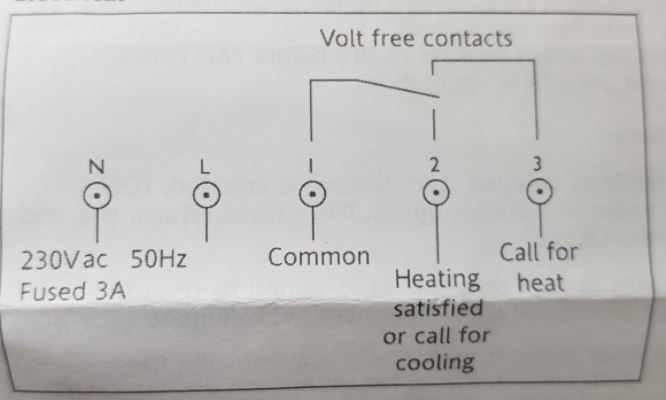

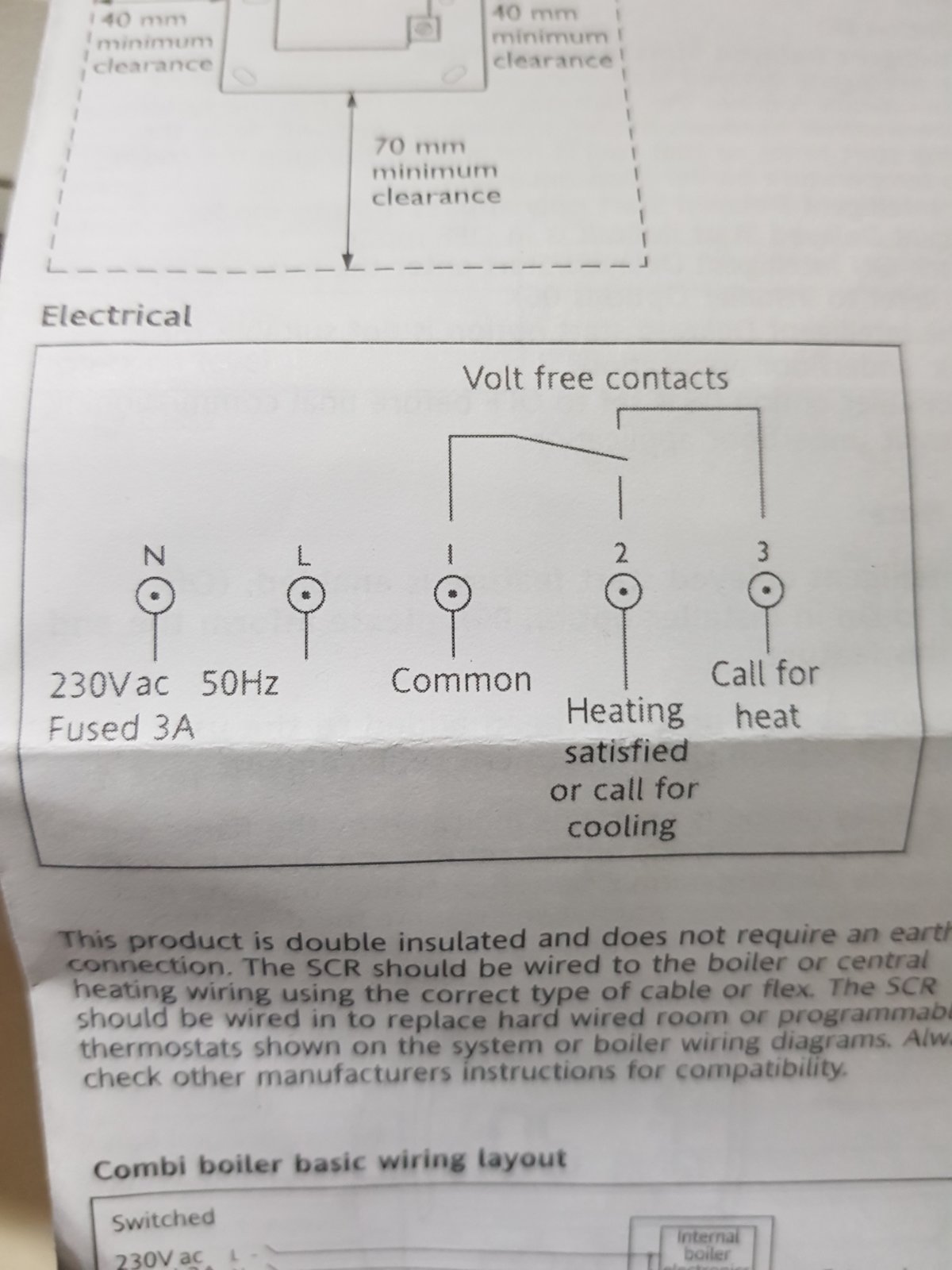

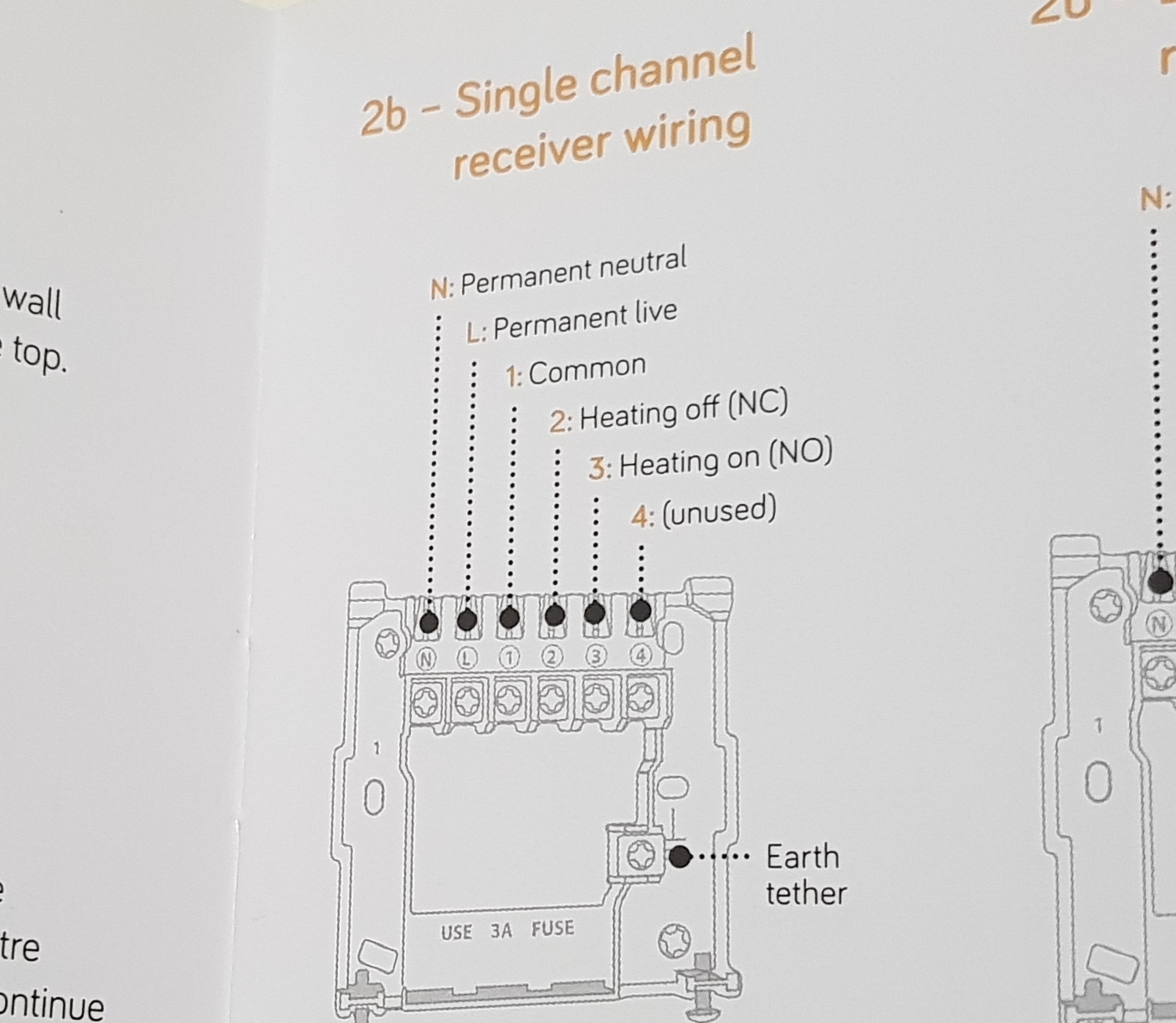

I am a bit puzzled why you are asking this. Look at the diagrams that you have posted. The wiring to the Drayton SCR is identical to the Hive.
Drayton SCR
Hive receiver
So the wiring corresponds exactly
N = Neutral
L = Live
1= Common
3= Heating on (aka Call for Heat)
So just swap them over. You might not even have to change the backplate.

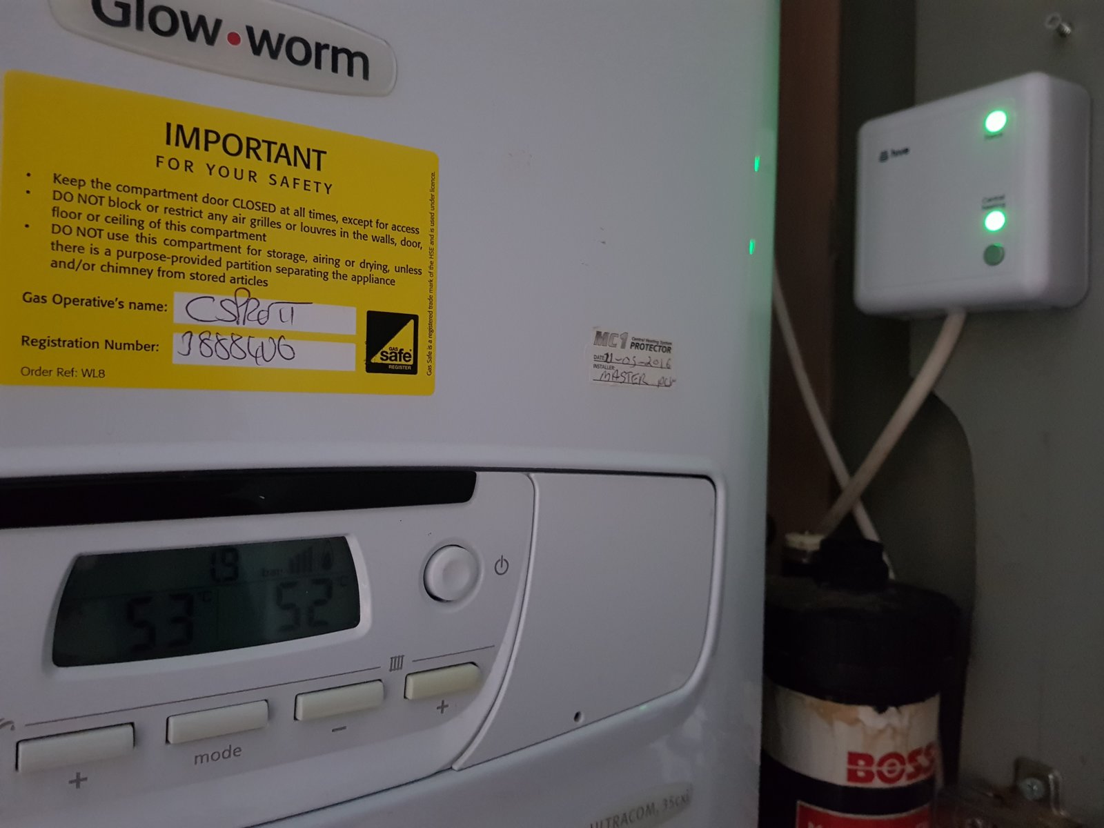

Thank you very much for your help Stem the hive active heating working perfectly appreciated thanks again

One more thing hive hot water and heating dual channel reciver wiring is different it's work with combi boiler? Can explain how to do it
Regards
There are two versions of the Hive receiver.
The dual channel Hive receiver is designed for systems with central heating and where hot water is preheated and stored in a hot water cylinder.
The single channel Hive receiver is for combi boilers where hot water is generated instantly, so no time control is required for hot water.
The wiring to the backplate is different, and the two versions of the Hive are not interchangeable.
It is possible to wire up a dual channel receiver to work with some combi boilers, and simply ignore the hot water settings. But this is not very professional. The problem comes in that some Combi boilers have 24v for their control and will be damaged if connected to the dual channel version of the Hive putting applying 230V to the 24v circuits.
