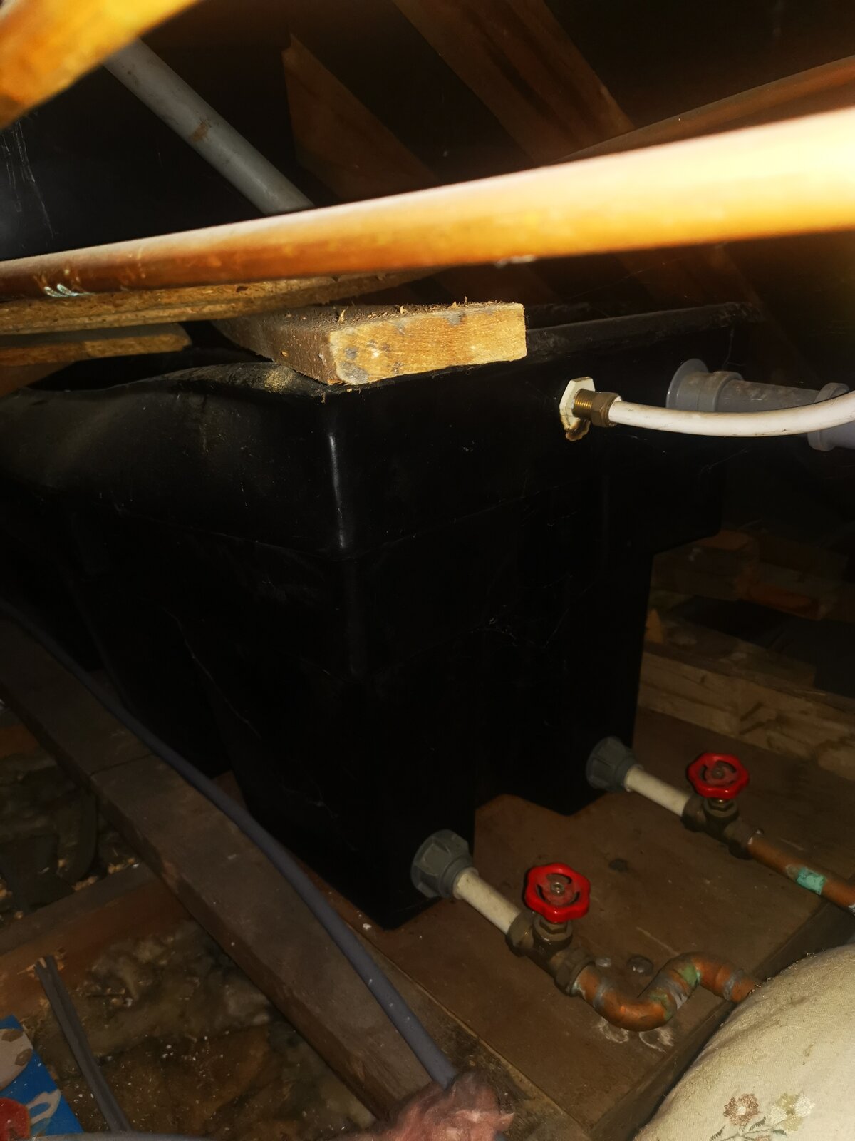

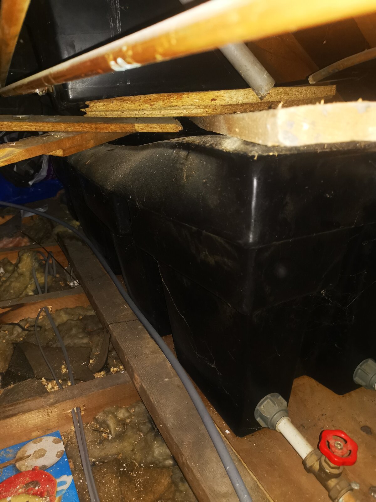

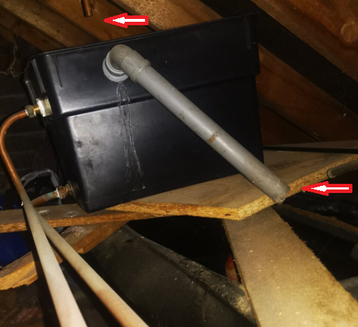

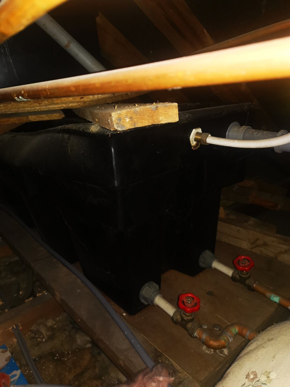

The overflow from the tank ( grey pipe ) seems to be not connected to a drain. If ( when ) the tank overflows the water will be coming through the ceiling.
There does not appear to be a lid on the tank. Debris ( and maybe dead animals / birds ) can get into the water in the tank.
It actually goes into the one underneath which them goes to the outside, again not a great job as you can see. Cowboy builders could do a full season on this house alone lol

Some serious issues there that need sorting quickly. Has your landlord done the required annual Legionella Risk Assessment?
Our landlord doesn't even get our boiler serviced. He lives abroad and the estate agents who we deal with is an absolute nightmare
I did the same with my overflows but with my cold water overflow going into the header tank for the heating system.

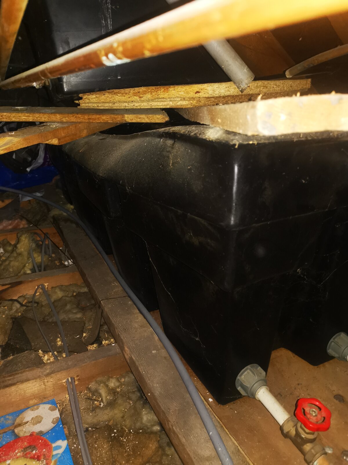

Also your lower tank appears to be collapsing under the weight of wood resting on it.

As Stem has said this needs sorting urgently for the safety of people and the property.

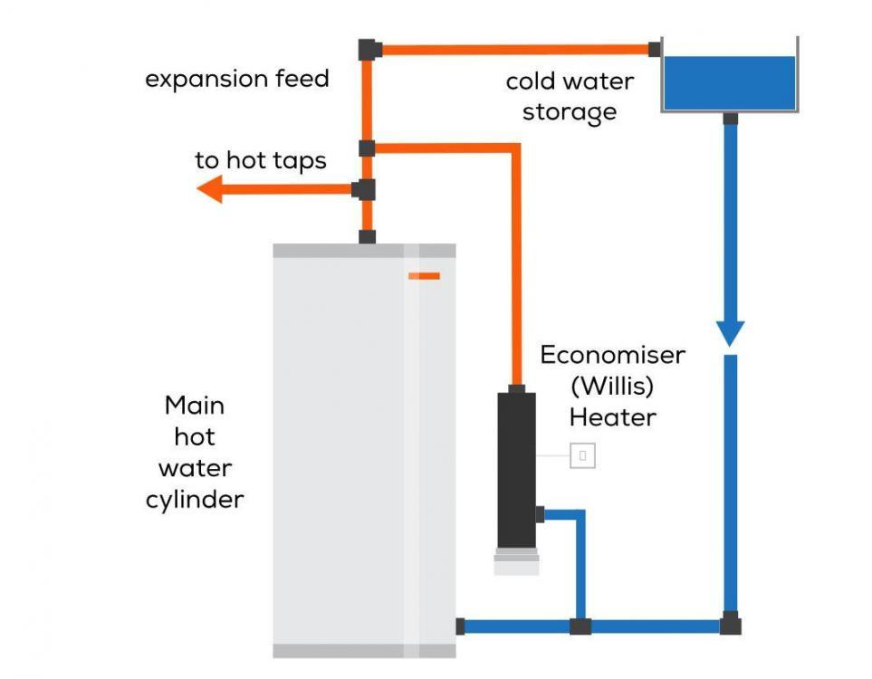

Yes saw the Willis system so thought it would be Ulster. Never seen it used in mainland UK. The Willis system heat the tank from the top down, very clever system, so the longer it is left one the more hot water you get, but you get hot water within minutes of being switched on.
I know it has been adapted for using solar energy.
This shows the idea of the Willis system, but I live in North Wales so not dealt with this system. I really don't know how it connects with central heating.

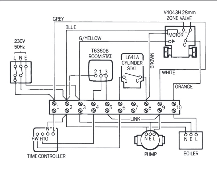

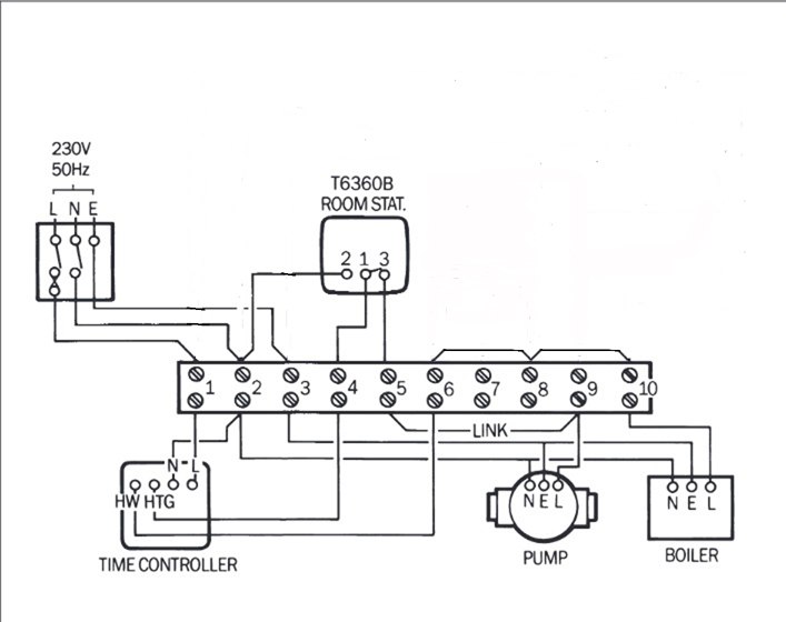

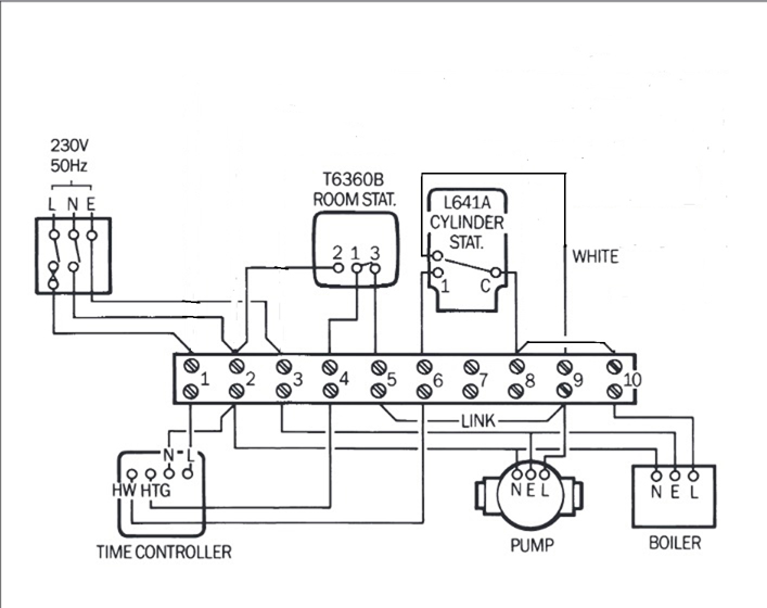

I have a DHW thermo syphon systems, with two pumps and two motorised valves, so simply looking at the valves is not enough to work out what you have, the so called C plan has so many variations and these are all C plan diagram2-old2.jpg diagram2-old.jpg diagram2.jpg with the first there is only time to control DHW summer and winter it will reach the temperature of boiler output in fullness of time, the next allows in the summer to limit hot water temperature but no winter control so in the summer boiler only runs when required the last uses a motorised valve so hot water temperature can be controlled summer and winter, and they are all called C plan.
The the first system it runs the pump and boiler for central heating and DHW and only boiler for DHW only, and the programmer has a mechanical lock so you can't select central heating only. but the programmer and the thermostat are two independent items, with Hive they are combined, so this
is original and Hive can do the same if room thermostat is removed and terminals 4 and 5 bridged, but electricians and plumbers don't always use same diagram so with yours it may not be 4 and 5.
But this is still C Plan C-Plan_old.jpg now a cylinder state has been added. It only helps in the summer. And this C-Plan.jpg is also C Plan, and not started to look at how the Willis system works with it.
