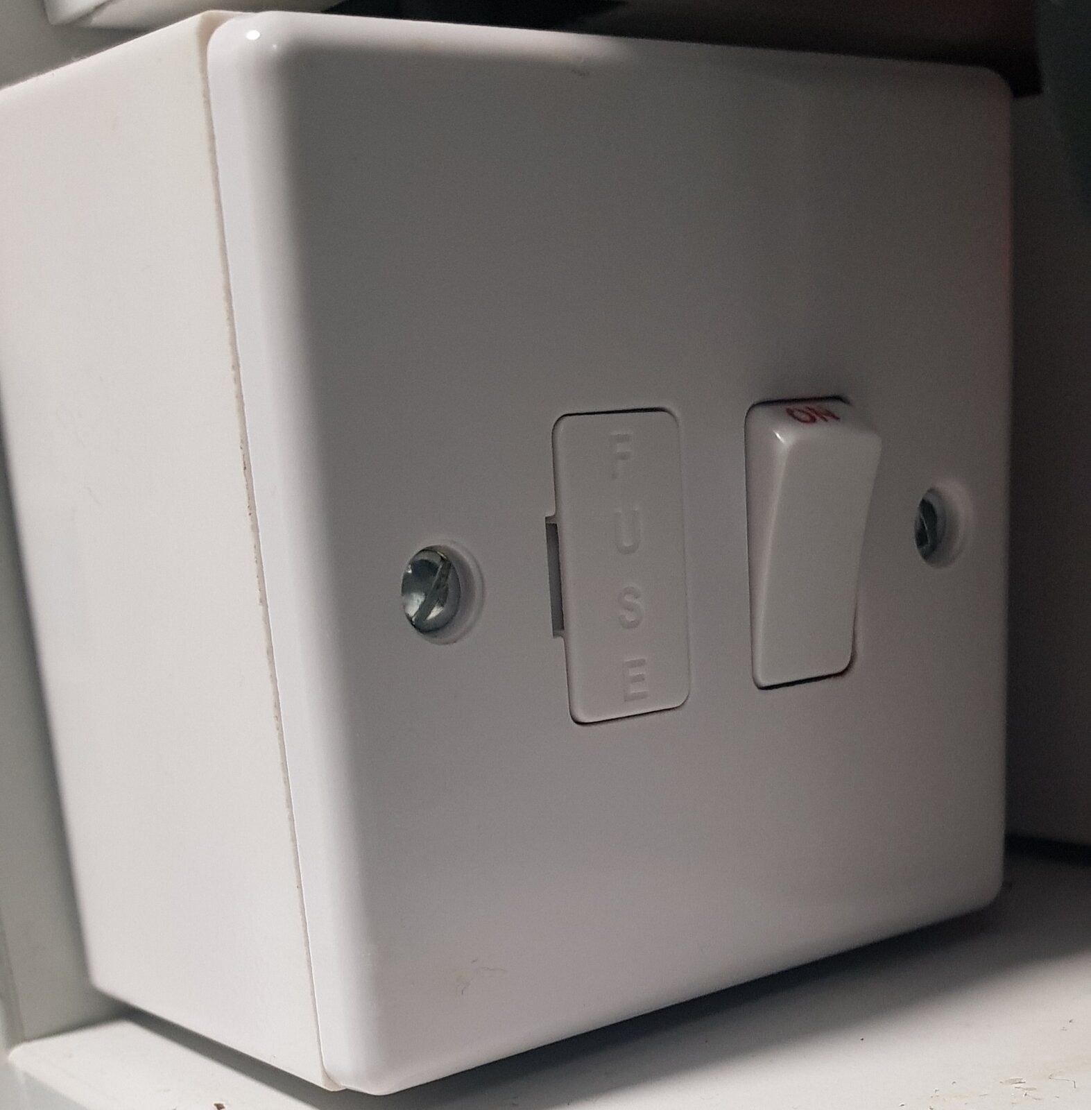

Can you post a pic of the "isolator", never seen a fused one. It is beginning to sound like it might be that the hob was connected via an FCU already in which case it will have a 13A fuse fitted.
Yes, that's what I meant with "isolator", a FCU.
You think it's already on a 13A?
It's the same as this
