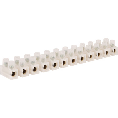

BTW, how do electricians call the "screw connectors"?

Correct. BTW, how do electricians call the "screw connectors"?
Would need to see a photo to know exactly what you were talking about. It could have been a "connecor block" (also known as a "choc block"), or something like that.
These things
