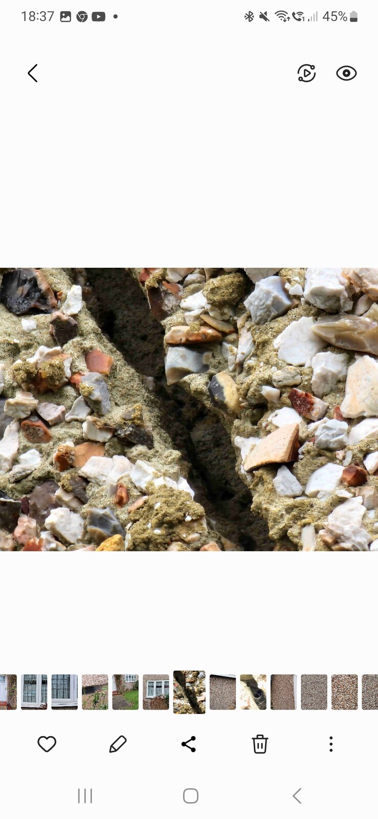

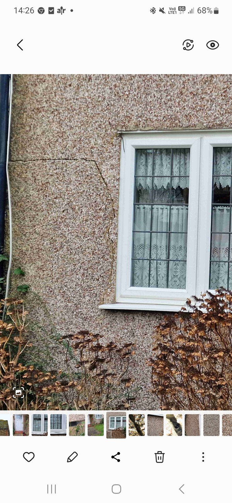

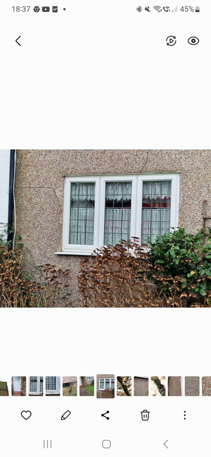

Hi all,
We're first time buyers and have recieved our survey back. Its highlighted a few issues with the property which is makjnv us very nervous. I don't know if it sounds worse than it actually is , any advice would be greatly appreciated before we make the decision to carry out additional surveys. Below is just a snippet of what we're most concerned about. Thank you in advance.
Main walls (Wall structure)
There is cracking to the front that is likely to be caused by faulty drainage. A specialist drainage contractor’s report will therefore be required which should involve a water retention test, possibly followed
by a CCTV inspection. The local water company may be responsible for drainage repairs and this should
be confirmed by your legal advisers. If a defect is found, it is likely that the drains could be sleeved. All cracks should be raked out to a depth of around 2cm to ensure a good key for the new mortar. Lime
mortar, and not cement, should be used to allow the brickwork to breathe. If the cracking opens up again
after any drainage repairs, further advice should be obtained from a structural engineer. We should
mention that, if no drain leakage is found, other issues could be causing the movement and a structural
engineer's specification would be required in those circumstances.
The cracking could also be associated with the trees/hedges/bushes to the front. Non-mature trees should not be allowed to grow any taller than their distance from the property, to help protect the foundations.
Trees remove extra water from the ground as they grow, which can sometimes destabilise the ground beneath the foundations and this can then cause movement and/or affect drainage. You should, therefore,
obtain an arboricultural report and implement any recommendations. If movement continues after the trees are maintained, further advice should be obtained from a structural engineer, who may need to
