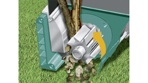

The (sort of) cog wheel I referred to looks like
That is the same principle a John described. It may be what he mentions as one with straight cutting flutes.
That looks more the principle of the industrial machines, it grinds rather than cuts.
As the branches pass between the cutter and shoe, they get chopped into chunks around 20mm in length.
The shoe is adjustable to accommodate wear - a knob is turned one click at a time until tiny alloy shavings appear.
I have to say, my original cutter was still sharp until disaster struck so the principle is sound enough.
