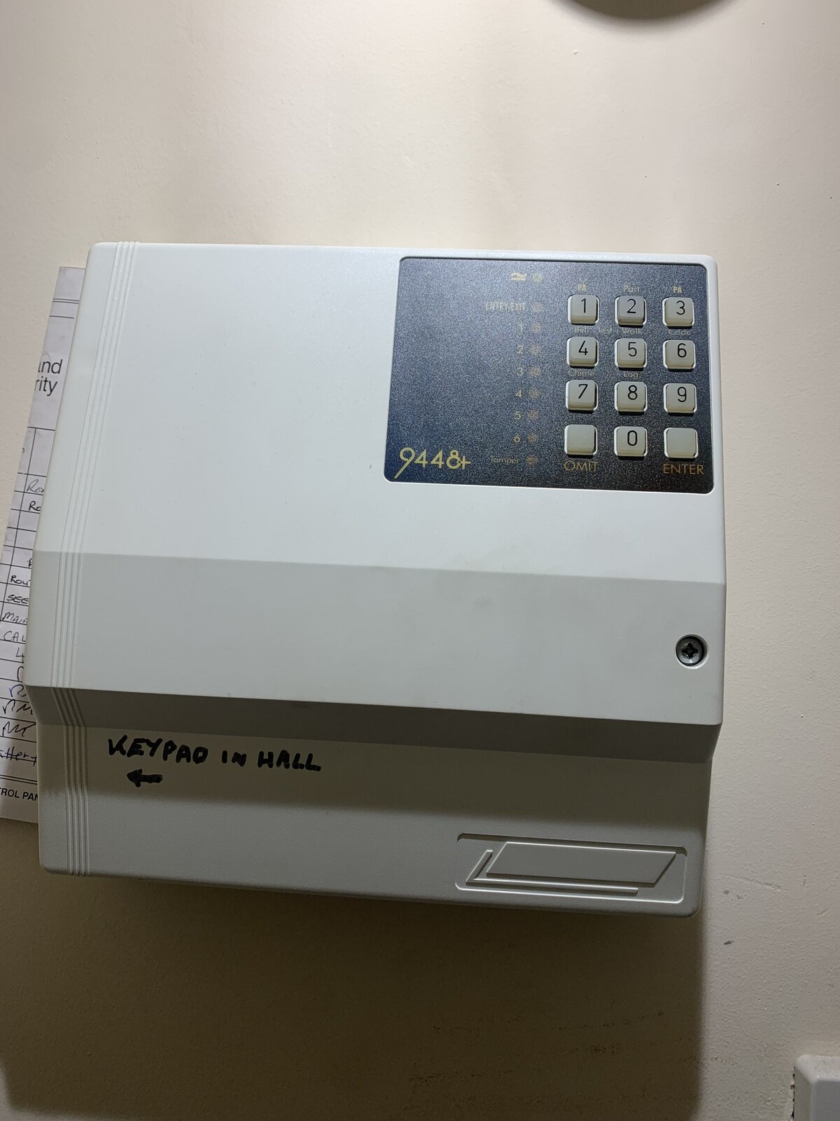

i need to replace my backup home burglar alarm battery only after 2 years. i believe these usually should last about 5 years.
anyway my current one is on the link below which is a 12v 2.1Ah
it did not last so i want to go for something else. i found the below on Toolstation but its a 2.3Ah. link below
my questions is, will the 2.3Ah be ok to replace the current one which is 2.1Ah?
thank you

thank you for the reply. please see picture. my question though is will the 2.3Ah be a suitable replacement for the current 2.1Ah please?

Yes that's fine.
2.1-2.3ah is the only battery to fit your 9448.
Your battery charging voltage may be high this could by why you only replaced your existing battery 2 yrs ago.This is a common issue with that control panel.
thank you so much. i have just replaced it with the yucel so hopefully 3-4year of peace and no more internal alarms. thank you. appreciated
What makes you think it’s the battery ? Have you dropped the power ( mains 240 supply ) to the alarm after fitting the new battery to check it takes over ok ?
Yes it takes over ok and panel reset with green light so hopefully no more internal alarms. Thank you
