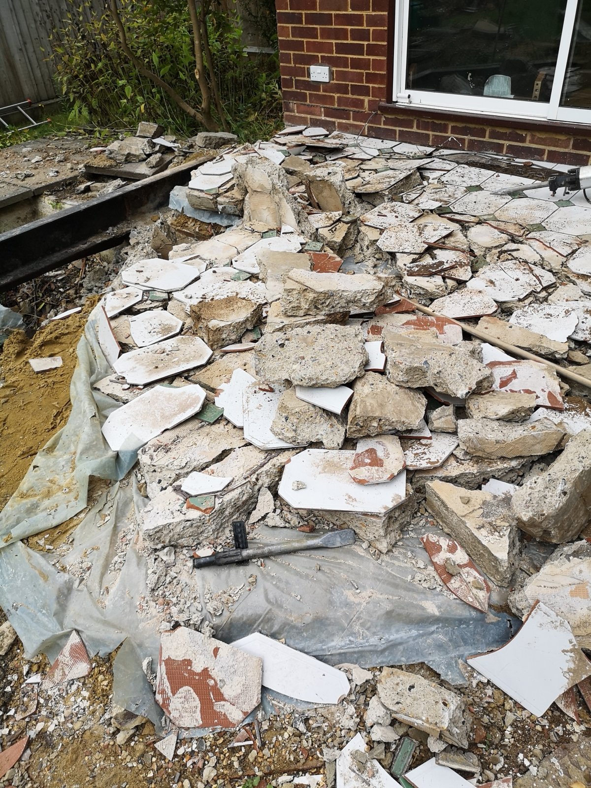

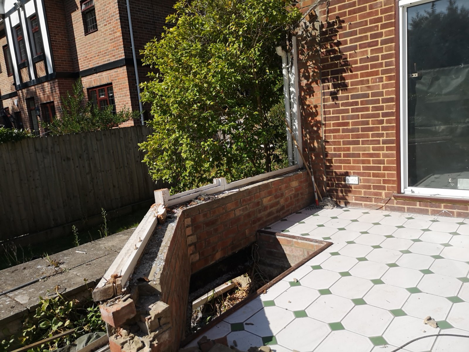

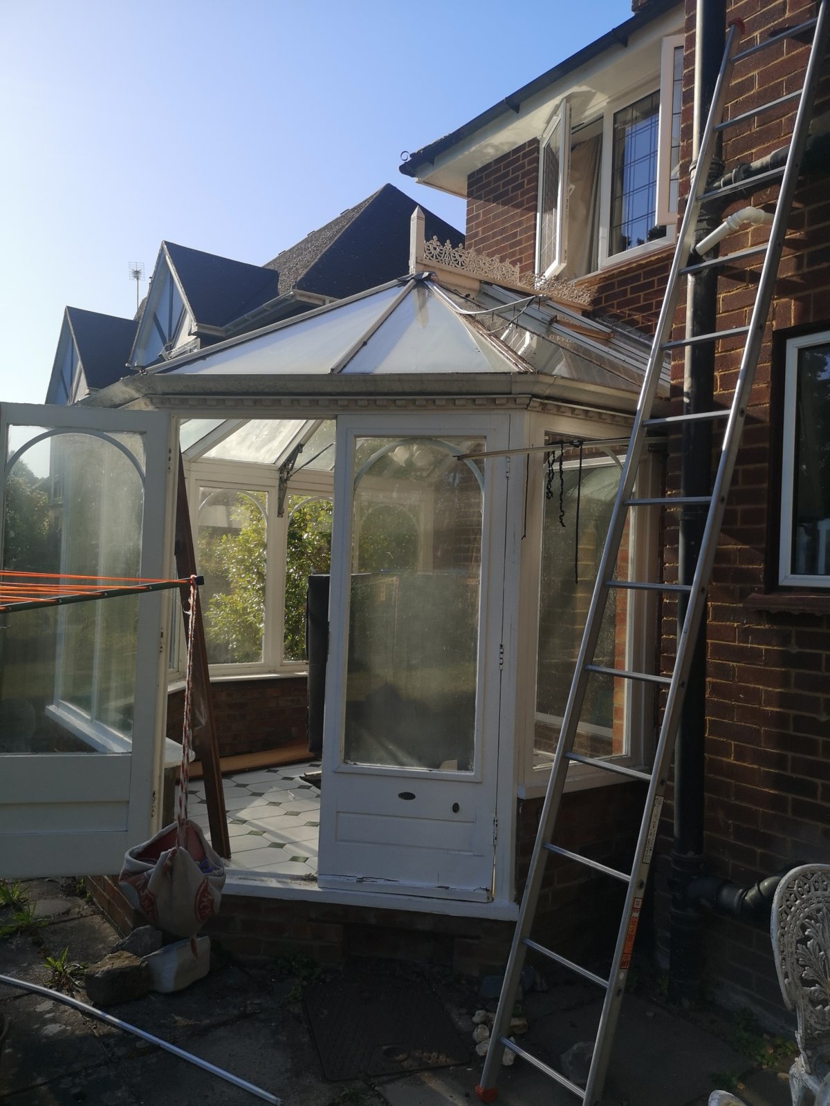

Made a start on the demo of the conservatory.
What we thought would be an easy job quickly turned out not to be anything like it. There was so much silicone and sticky stuff on the glass panels you couldn't get them out, all panels are double glazed Inc the roof. Nearly all the glass isn't safety glass either so when it broke it was shards of glass falling down, not good.
So I got up a ladder and tried to break the double glazed roof from above using a roofer hammer with a long point on the tail. It was a bit like smash a couple of panes clear it up, smash more clean up. The kick in the nuts was the edges of the glass were stuck to the alloy in the units and in turn they were stuck to the hardwood frame all hanging above you when clearing up.
It took 2 days to get the glass out and cut the hardwood frame so I could pull it down and away from the house.

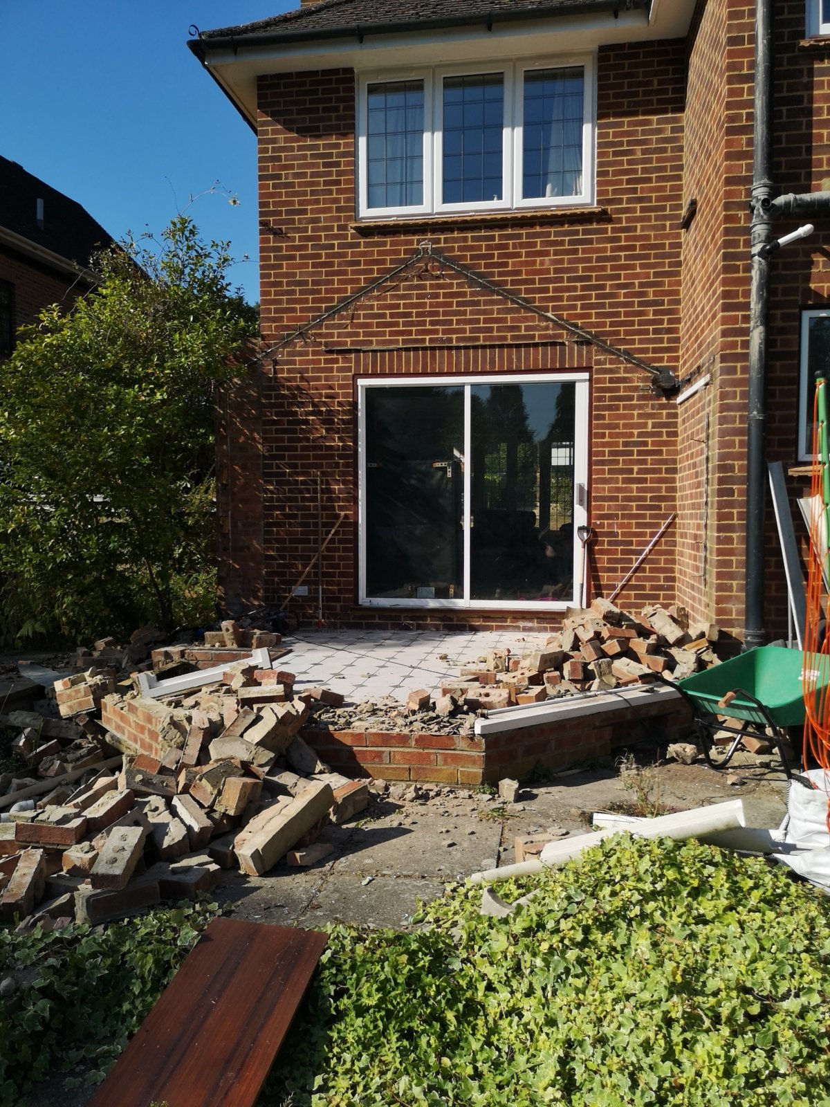

Then the fun started with the bricks, I'm guessing there was a shortage of sand when this was built as it looks like a 1to1 mix with cement. Took a good while to get it going...... Thank god for breakers.
Look at the photos.......... See anything odd......... No, look again, see the pond that goes under the floor and inside the conservatory. 80s design at its best, no. There's a steel beam supporting the wall about 9" high that's gonna be fun to pull out.

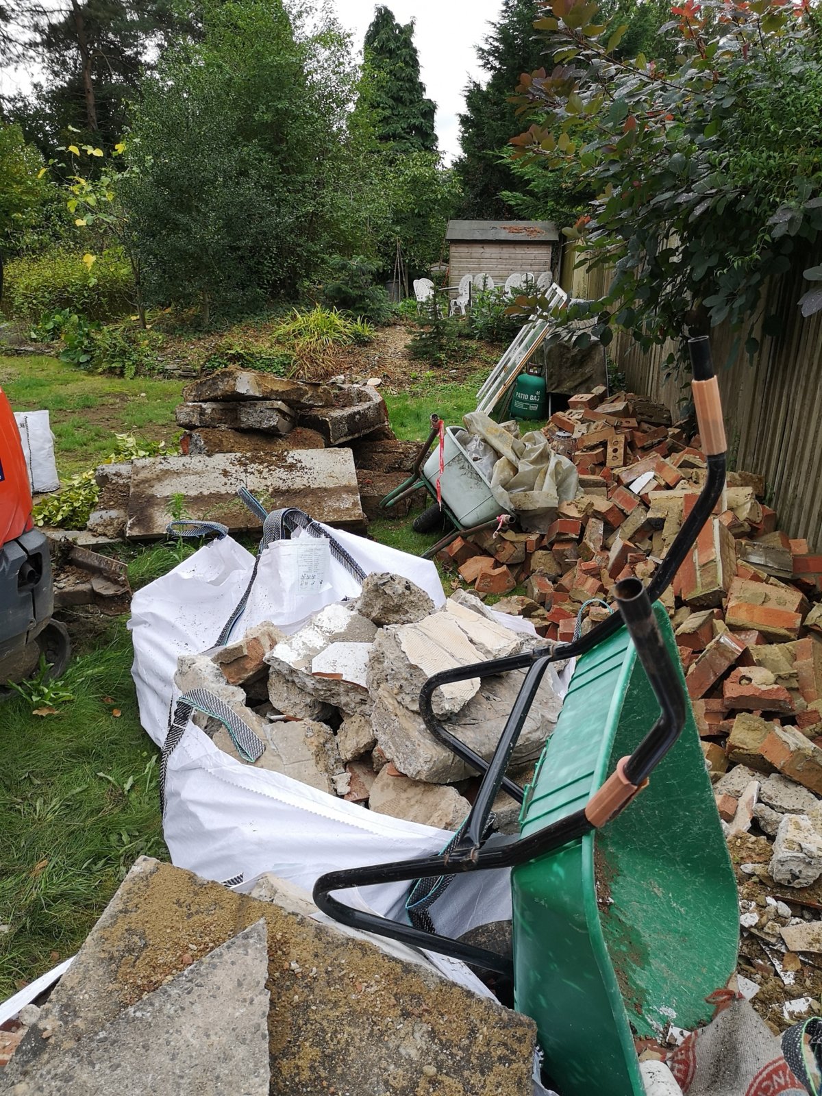

Onwards and upwards, just the tiled floor to gun out and drop the base 3 or 4 courses, a good tidy up and be ready for footings

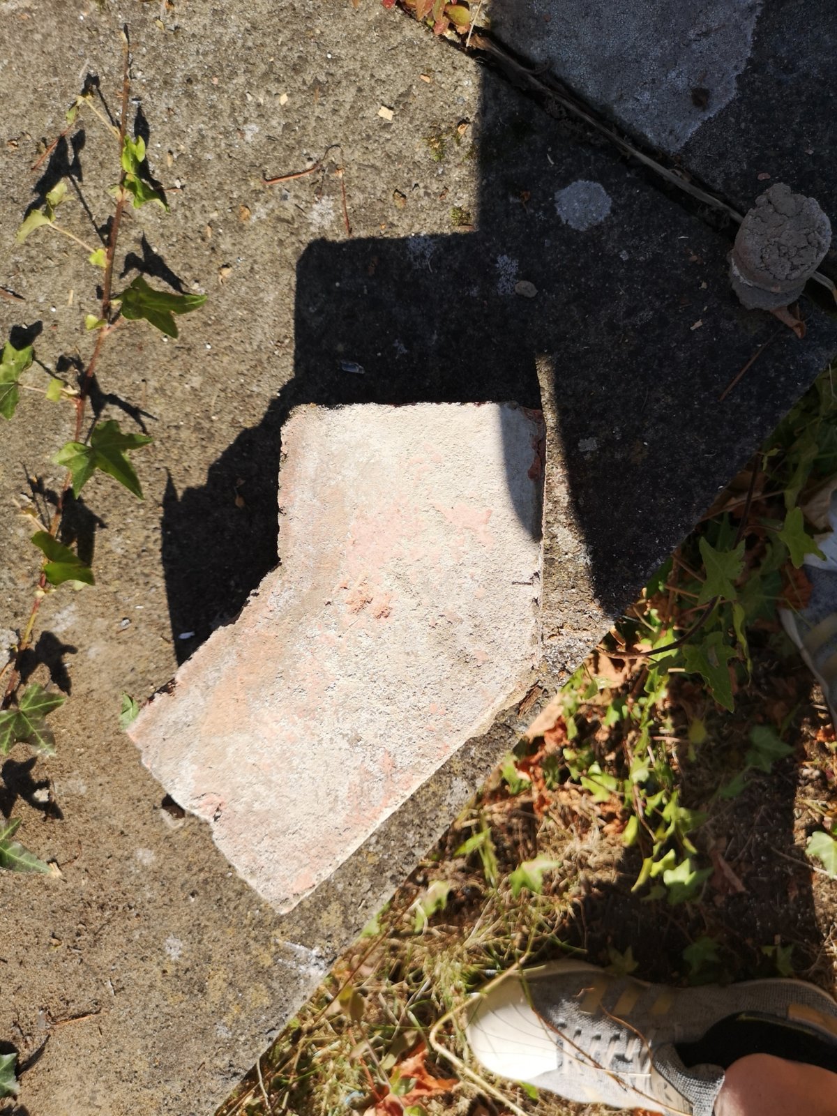

See the last pic of the angled brick are these any good to anyone?? I have about 6 or 8 of them if anyone wants them.

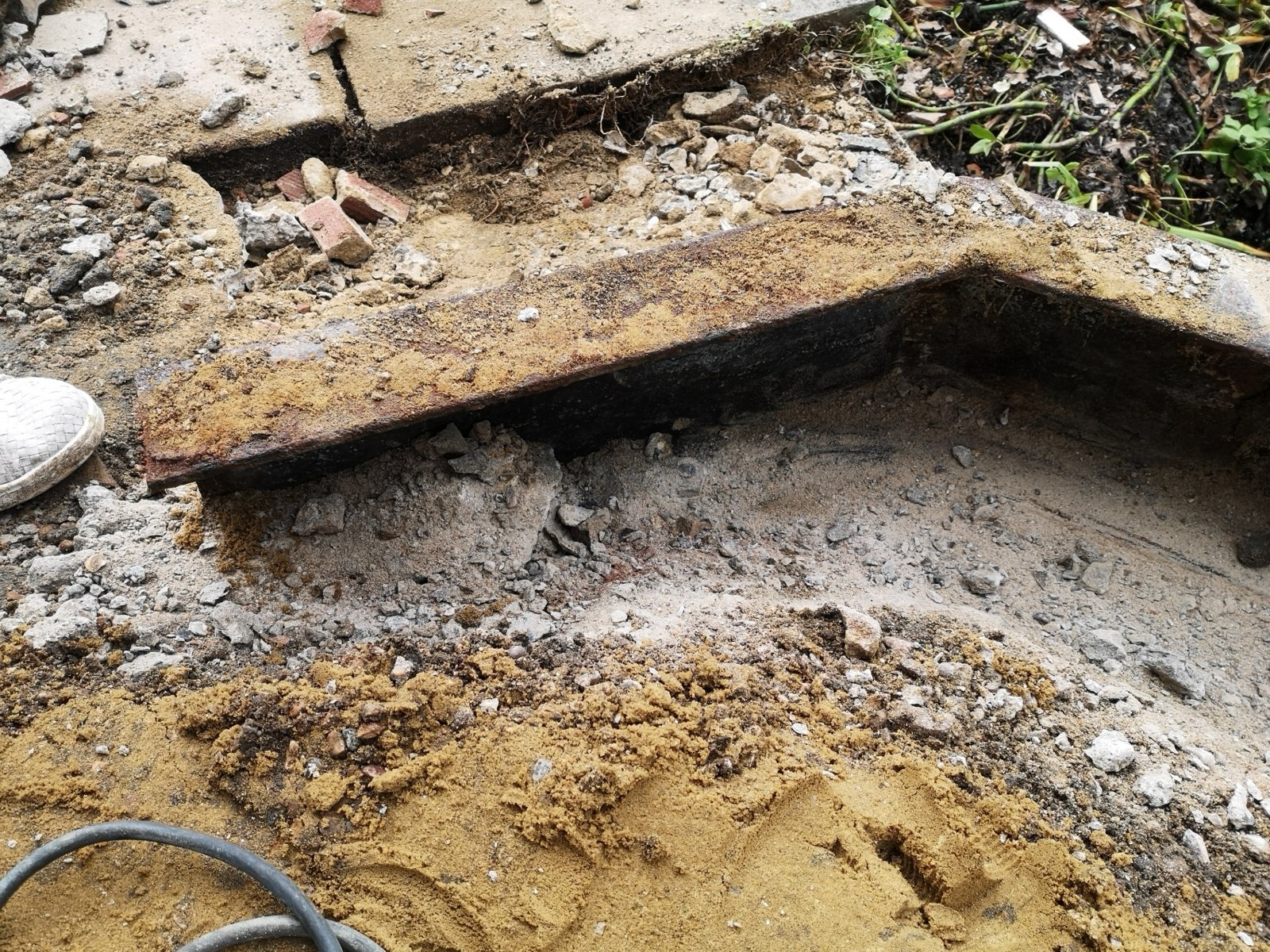

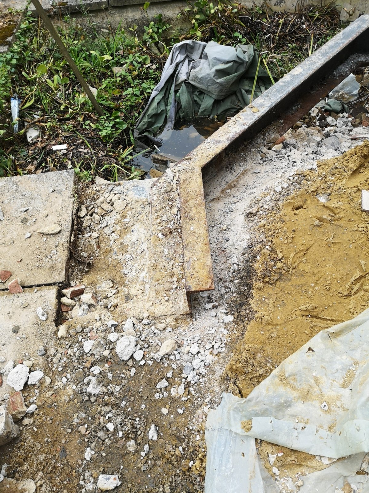

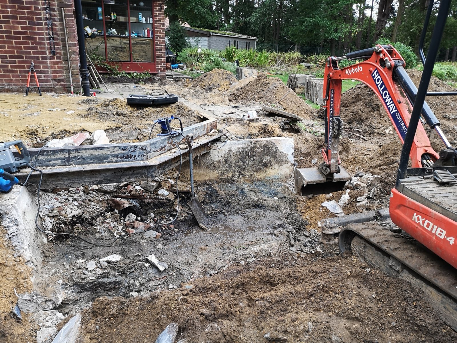

the beam in the bottom is causing me real nightmares. i have spent hours getting the barrow of concrete they poured over each end off to find its bolted to the floor, but not to a flagstone etc, theres a poured concrete support thats soo hard the 15kg breaker i have just nips lil bits off it and no more. the bolts look to be high tensile, i tried to cut them with an angle grinder and it wont cut, just skimms along.
i got the tilled floor up and the concrete and hardcore base under that {no screed} only to find about 50mm of sand and stones and another concrete base below that .......aghhh
i think i need to take that up as well as im sure i dont have clearance for the block n beam floor, 152mm, insulation, 130mm, 70mm screed and the 150mm air void needed.

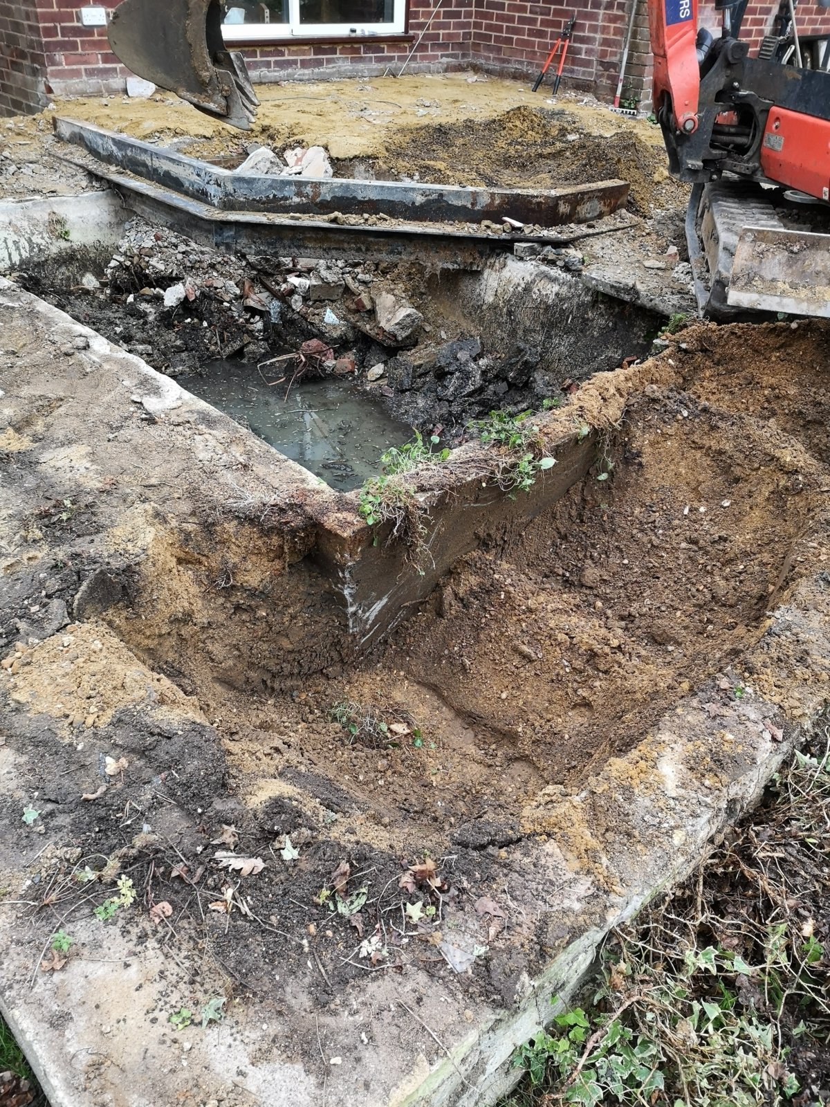

I hired a man and digger, well worth the money and I can't recommend the man I got enough if anyone wants his no contact me he's in Ash in Surrey but does travel.

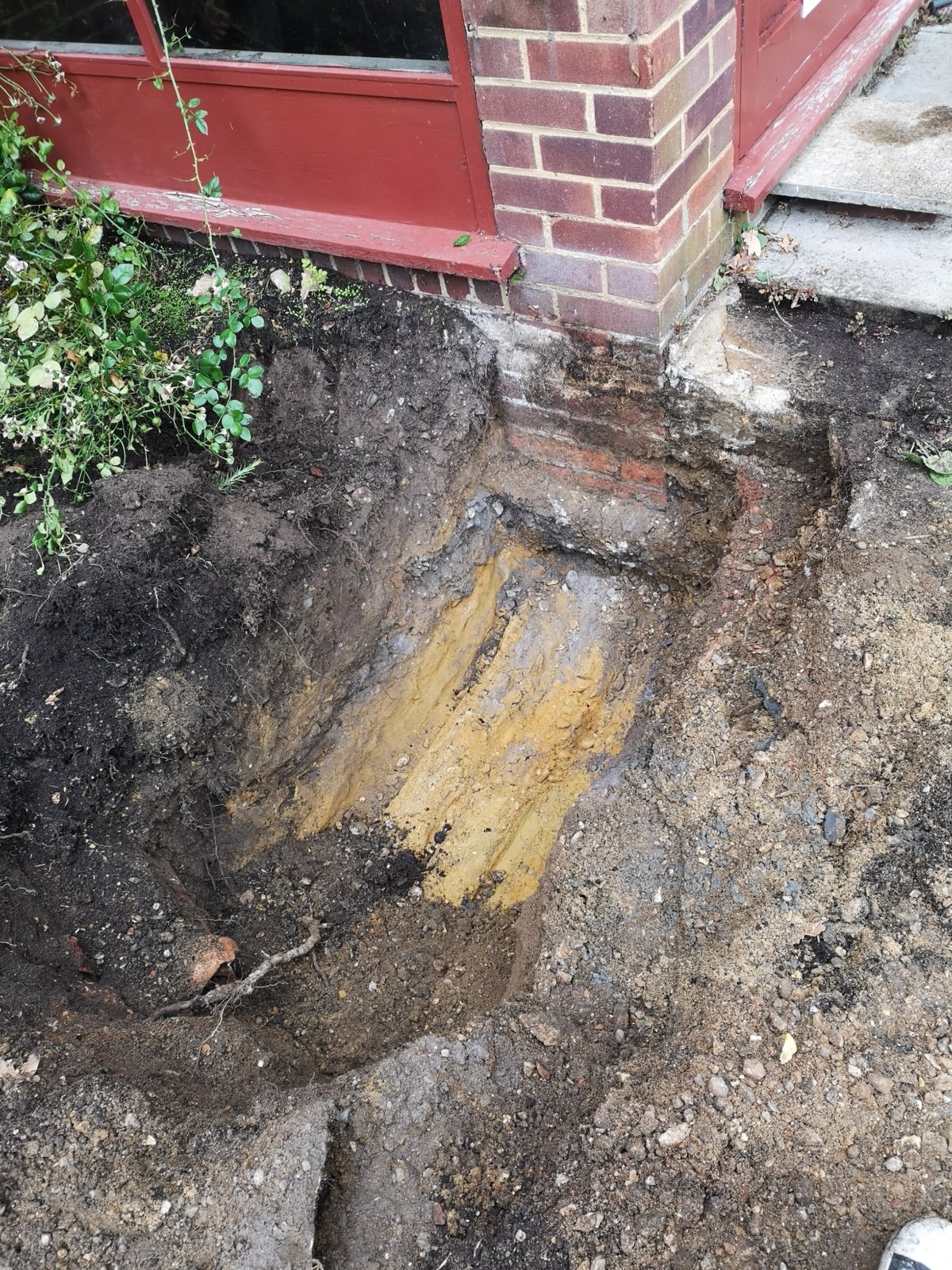

We dug a test hole and to everyones surprise we are on sand, good news

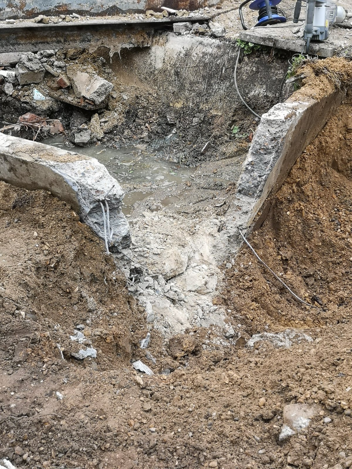

Then we started on that monstrous concrete pond under the conservatory......... It was a right git
Mr digger started to do what he does best and drank some tea while I got the flag stones off the patio.
He had to get the patio wall down and out on 2 sides, that was a lump and a half. Luckily it was all filled with sand and a bit of ballast..... Tons of it.
When the 2 sides were clear the pond was exposed, we hoped to fold it out flat and pull it out. No such luck, banging it with the digger a sledge hammer nothing. We broke out a corner to see rebar..... You dirty #@&¥€ the next 4 to 5 hours were spent on manually breaking this git out. The sides were 6 inch thick the bottom 9inch thick and 1m deep down and full of rebar. One side at a time with a breaker top to bottom then along the joint at the floor......back breaking especially holding up a 15kg breaker to get to the top of the wall.
Progress is being made, the pond is half out as we ran outta time, the garden is a mess, the neighbours are wearing ear defenders my dogs keep getting in the holes dug by the diggerman but progress is being made.
