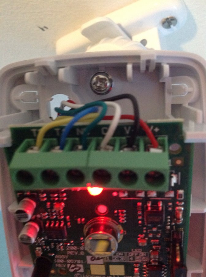

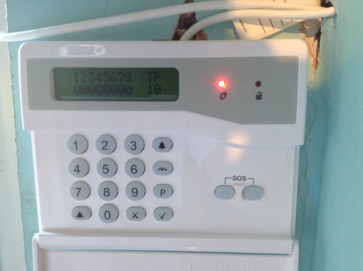

I am wiring each PIR into tamper 1 at a time. On the 2 I have tried so for on walk test I get this
What have I done wrong.

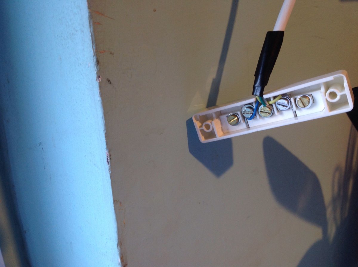

I will post pictures of PIR wiring and door contact wiring
In following posts
You've got the tamper circuits and the alarm circuits the wrong way round.
Each time I wire a single zone PIR into tamper, on walk test 1 goes under T and not under zone number, except door contact zones
