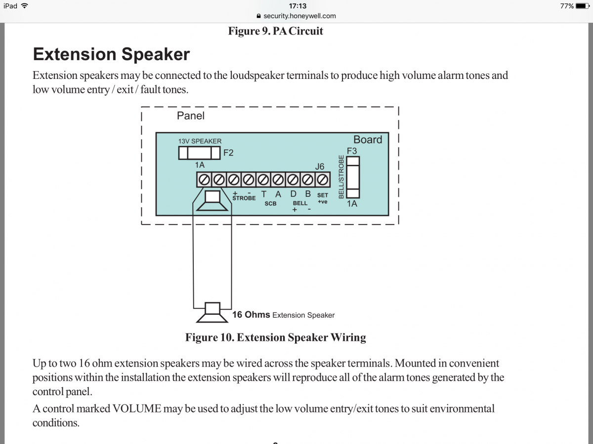

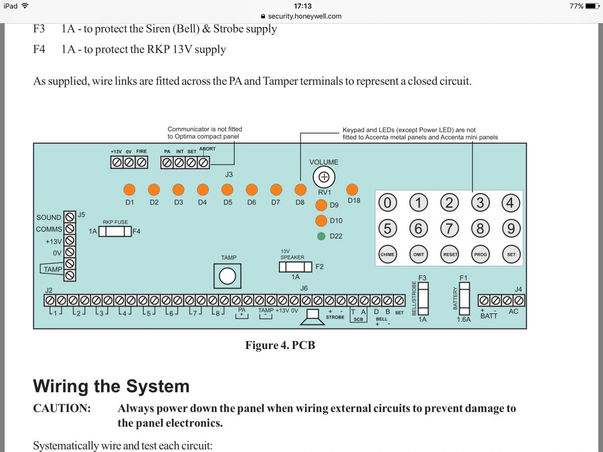

Turn up the volume on the pcb ....or fit larger speaker

Does that mean it would require opening the panel & messing around with the wiring then? As i see no volume on the main face.
If so then i think we'll leave it quiet. Been down the road of opening panels before ............. it got costly in the end.
